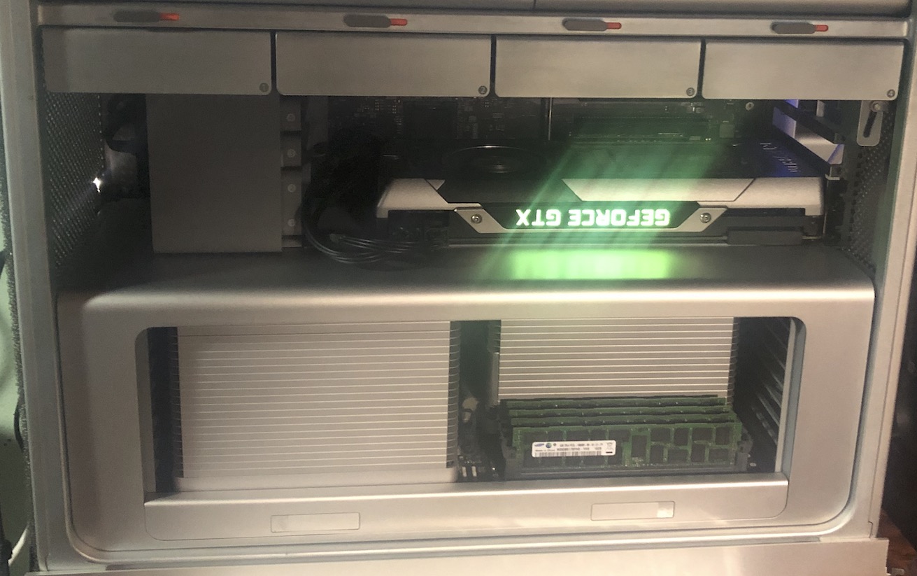

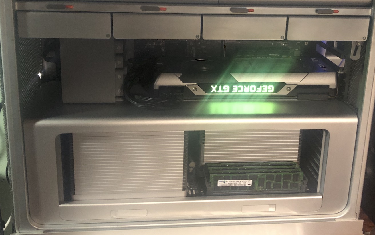

Opencore, have installed it with every macOS on the 3,1 5,1 and the 6,1 and the last one was 14.2.1 Sonoma on all of them, Been using The Nvidia GTX 780Ti and the Nvidia GT 730, They work perfect every Time with every MacOS, I think Opencore patcher has added support for the AMD, To make sure your video card works you have to have it installed so Opencore install knows what video card it is when it installs, Also have a GTX 680 with a Mac boot screen that comes in handy when there is trouble getting a boot screen when installing, if you can do with a GTX 780Ti 3G ( $75 0n eBay ) get one they work every time, When the video don't work I put in the GT 730 2G and you will get video every time also, Have tried two different Gigabyte RX 580's and haven got one working yet, Always go back to the GTX 780Ti the single fan version
