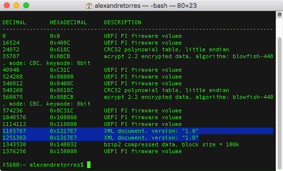

Hi,
How big issue this really is? And do you know, how to possible fix it? I checked by MP 4.1 > 5.1 and found the same like you have :
DECIMAL HEXADECIMAL DESCRIPTION
0 0x0 UEFI PI firmware volume
16524 0x408C UEFI PI firmware volume
24972 0x618C CRC32 polynomial table, little endian
35787 0x8BCB mcrypt 2.2 encrypted data, algorithm: blowfish-448, mode: CBC, keymode: 8bit
49948 0xC31C UEFI PI firmware volume
524288 0x80000 UEFI PI firmware volume
540812 0x8408C UEFI PI firmware volume
549260 0x8618C CRC32 polynomial table, little endian
560075 0x88BCB mcrypt 2.2 encrypted data, algorithm: blowfish-448, mode: CBC, keymode: 8bit
574236 0x8C31C UEFI PI firmware volume
1048576 0x100000 UEFI PI firmware volume
1114112 0x110000 UEFI PI firmware volume
1181901 0x1208CD Certificate in DER format (x509 v3), header length: 4, sequence length: 986
1247437 0x1308CD Certificate in DER format (x509 v3), header length: 4, sequence length: 986
1343538 0x148032 bzip2 compressed data, block size = 100k
1376256 0x150000 UEFI PI firmware volume
It's not a common occurrence, but again two IASInstallPhaseList.plists into a NVRAM:

This Mac Pro 1st/2nd streams of the NVRAM volume are almost full, even have GFXVENDOR setting and the binary blobs that block TITAN GPUs to work. I'd really like to understand what causes this.
tsialex
Contributor
Jun 13, 2016
13,455
13,602
Hi,
If you ever install a BootROM without microcodes, like MP51.0087.B00, it will brick your Mac, but this is a rare occurrence - probably an Apple error. Another problem is the space that the SecureBoot certificates use, NVRAM full volume is just 192KB, with a little less than half of that dedicated to store parameters and settings. Some people here got it totally full, but this happened at around 5 to 7% of the dumps I checked. So, to most people is relatively innocuous.
We can remove SecureBoot Certificates with BootROM reconstruction, but it's useless if you continue to use UEFI Windows.

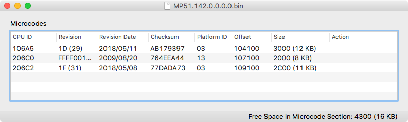

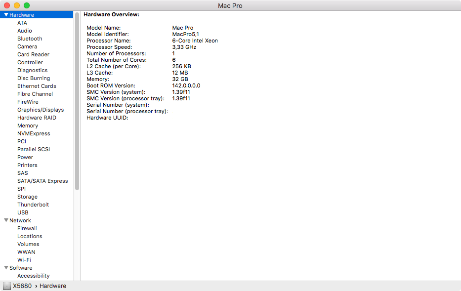

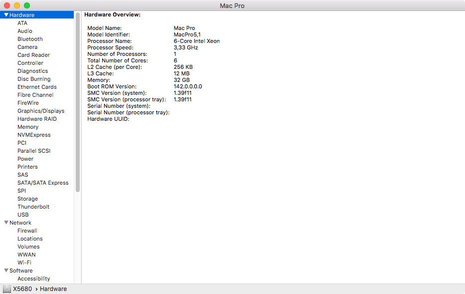

DON'T FLASH 142.0.0.0.0 IF YOU HAVE A W3xxx XEON, ONLY WORKS WITH X5xxx, E5xxx and L5xxx XEONS.
With todays 10.14.4 DP4, Apple released MP5,1 BootROM 142.0.0.0.0:
  • Build date is 20190214,
  • BootBlock version is APLEFI1.88Z.0005.I00.1902142048,
  • CRC32 is 64e8f5ea,
  • Updated APFSJumpStart EFI module,
  • same microcodes as 138.0.0.0.0,
  • same NVMe EFI module as 140.0.0.0.0.

tsialex
Contributor
Jun 13, 2016
13,455
13,602
I already reconstructed 142.0.0.0.0 for my Mac Pro and it works, took a lot more time to do the first boot, normal after that.
Now it's time to try to find what Apple changed with this new release of the Mac Pro firmware.

I checked the reconstruction that bricked the mid2012 and seems correct to me - everything are in the correct places and all checksums are correct. So, user error is not the smoking gun.
Could be SPI cell exhaustion, flashrom problems or something with 142.0.0.0.0. Since I didn't had any problems with the new BootROM, first and second options seems more plausible at the moment.
h9826790
macrumors P6
Apr 3, 2014
16,656
8,587
Hong Kong
I just test that with my cMP. Use native Apple way to update from 141.0.0.0.0 to 142.0.0.0.0.
Firmware update looks normal. Super drive tray open, after a few seconds, self shutdown, and auto power up again. But unable to POST, so cMP bricked.
So, something wrong with 142.0.0.0.0. Recommend all users avoid that (unless have a way to recover).
N.B. I have no intention to fix my cMP this time, my Hackintosh is fully ready to take over. So, finally, it's time to move on :D
