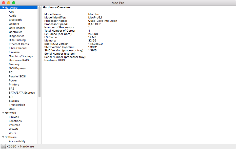

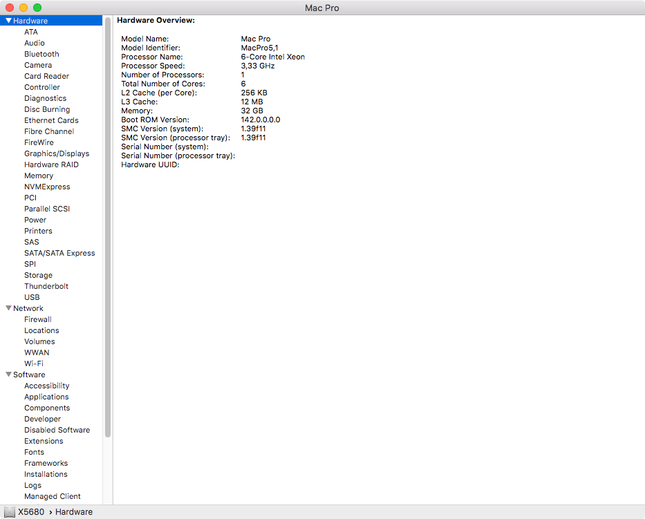

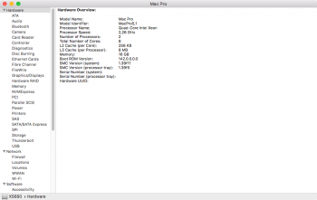

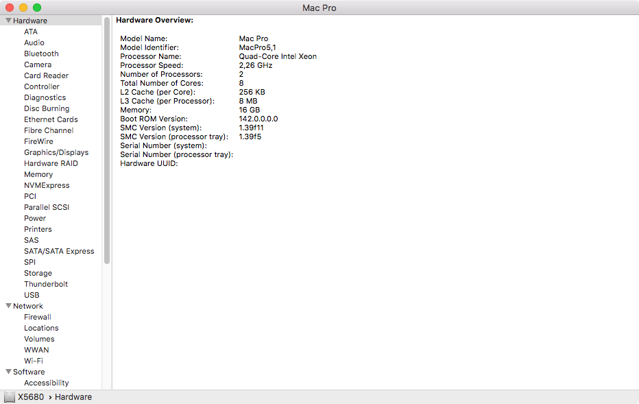

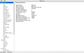

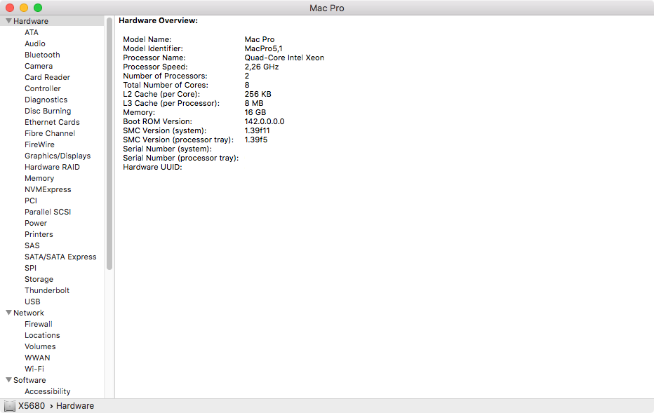

Tested 142.0.0.0.0 with:
X5680:
X5677:
E5520:

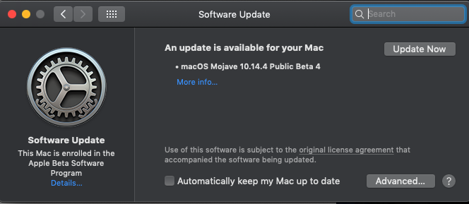

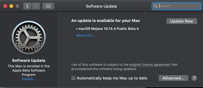

This just showed up on my Mac Pro 4,1/5,1 running Mojave 10.14.4 beta (18E194d)
current boot rom (140.0.0.0.0)
My question is, is it safe to allow the update to proceed?
Should be fine as long as you avoid firmware updates for now.

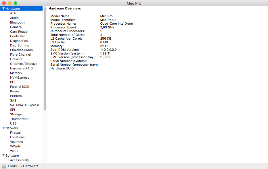

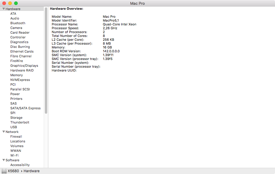

So I was intrigued how the first Mac Pro bricked. I have the exact, yes identical, Mac Pro config to the SPI flash model of the first brick EXCEPT that my Mac Pro have a X5680 Xeon and the one bricked by 142.0.0.0.0 have a W3680.
When the supposed bricked backplane was replaced and the Mac Pro booted again, the user sent me his reconstructed BootROM. I checked it fully, found nothing wrong. Flashed it to my single Mac Pro, if something was wrong I shouldn't boot from now on, but it booted perfectly. This didn't got me anything as where to start to investigate what was causing the bricks, just more questions.
Then @h9826790 "bricked" his Mac Pro and almost instantly I remembered that he has a single CPU Xeon too, a W3690. Maybe it's something related to the type of processor / or model related.
Hummmm, lets see if my Mac Pro boots with E5520.
E5520 boots 142.0.0.0.0. Jet plane sounds as expected with mismatched SMCs.
Let's test a X5677, maybe it's a multiplier thing.
Boots, so no big multiplier problem. If X5677 and X5680 boots, X5690 will boot too. Dual CPU Xeons are working fine.

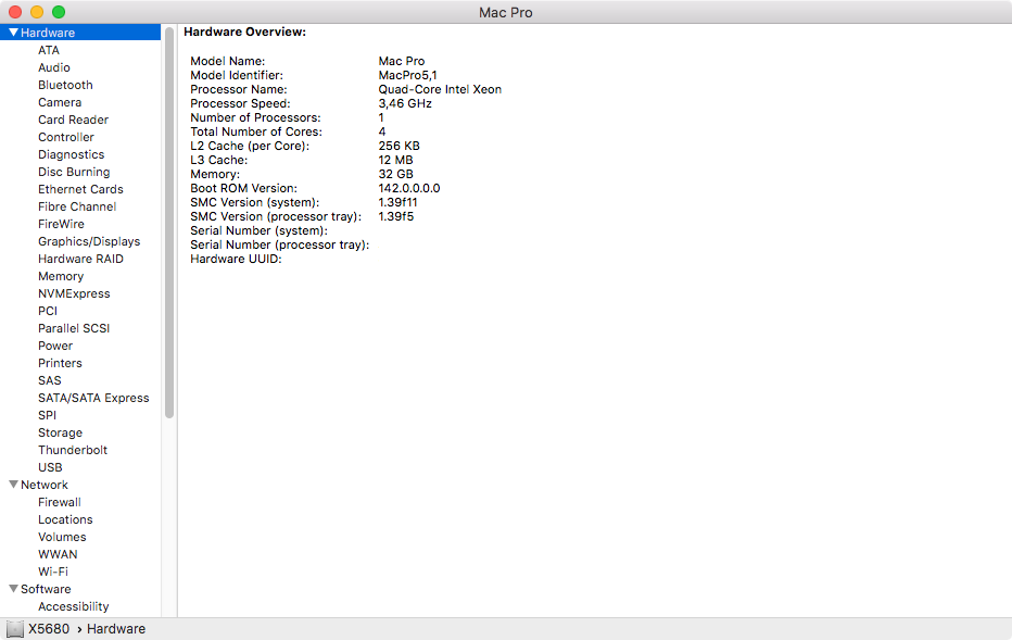

Now it's time to test single CPU Xeons. I have just one here, the one that came from Apple with my 2009 single CPU, a W3540. Installed it on my 2009 single tray, no boot with 142.0.0.0.0. Ops, something is wrong here. Since I don't have another W3xxx Xeon at home, let's test if downgrading to 140.0.0.0.0 with another tray makes my Mac Pro working correctly with W3540 tray.
Yes! W3540 boots 140.0.0.0.0!
So, my W3540 Xeon and tray combo are correctly working, no fluke here. Now, just to confirm, let me upgrade from 140.0.0.0.0 to 142.0.0.0.0 with EfiFlasher method. Drumroll…
Brick.:mad:
Confirmed, W3xxx Xeons can't make POST with 142.0.0.0.0 BootROM. It's not really bricked, but can't work. Change the single CPU Xeon to a Dual CPU model like X5xxx/E5xxx/L5xxx and the Mac Pro resurrects again.
Apple probably made a mess with W3xxx initialisation code with 142.0.0.0.0.

Works with any dual CPU Xeon, so X5xxx, E5xxx and L5xxx. I tested 142.0.0.0.0 with X5677, X5680 and E5520 earlier tonight.
142.0.0.0.0 don't work with any W35xx, W36xx and probably no i7 too.
