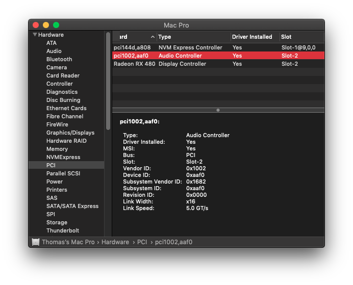

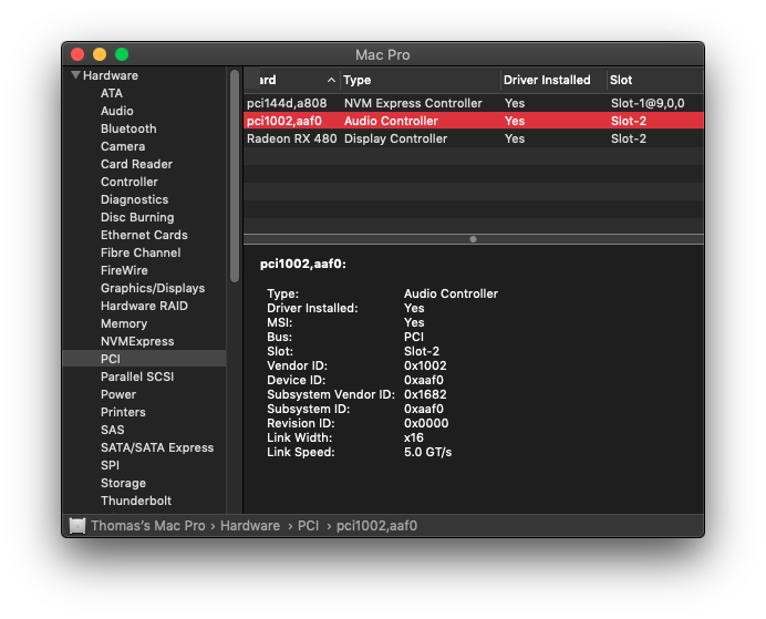

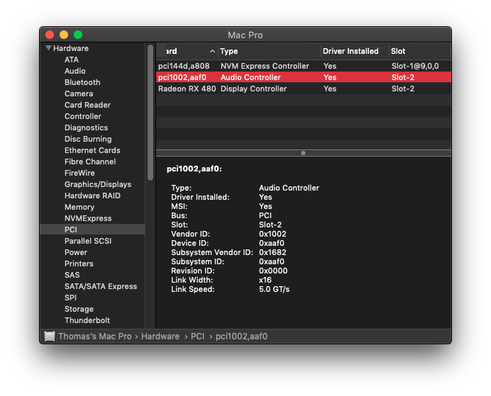

I upgraded a 2nd 2009 cMP with a rx480 this evening from 0085 to 0138 using a fresh install of 10.3.6 and the Mojave installer. Upgrading to NVME works as expected. Rebooting into Mojave the RX480 is running at 5.0 GTS and to my surprise, the rx480 audio driver is also loaded. My Crossover 324k once again outputs audio over Display Port.

Your hardware didn't change, still PCIe2.0. Now GPUs are correctly identified and run at 5.0GT/s. Changing slots won't change anything for PCIe SSDs.
There can be a big difference.
Those PCIe 3.0 X4 SSD can only negotiate at PCIe 1.0 X4 natively in slot 2 (for 4,1/5,1) without any PCIe switch inside the connection (before the firmware update).
If the slot 2 can properly negotiate at PCIe 2.0 X4 with those SSD, their sequential performance will be doubled.
And this will make the 4,1/5,1 can use two NVMe in RAID 0 to achieve 3000MB/s by installing one SSD in slot 2 and one SSD in slot 3 with those cheap adaptor.
This wasn’t possible before. Because the NVMe will be limited to 750MB/s in slot 2 (without the help of those expensive adaptor e.g. High Point 7101A), and cause the whole SSD RAID 0 limited to 750MB/s x2, which is only 1500MB/.
If install the SSD in slot 3 and 4, due to there are only 4 lanes for slot 3 and 4 to share. The ultimate speed is still 1500MB/s.
[doublepost=1534482817][/doublepost]
Check "About This Mac">"System Report">"PCI" and see what it says about Link Speed.
It's cosmetic, I have always measured 5.0 GT/s with my MVC flashed Nvidia cards, even though the PCI report says 2.5 GT/s, as is does now.

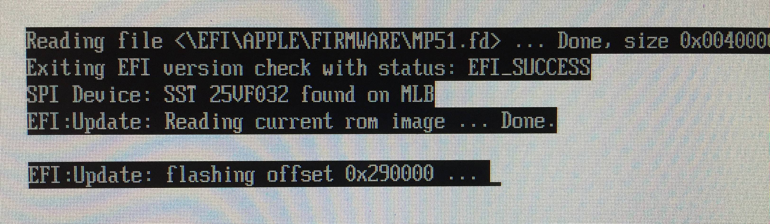

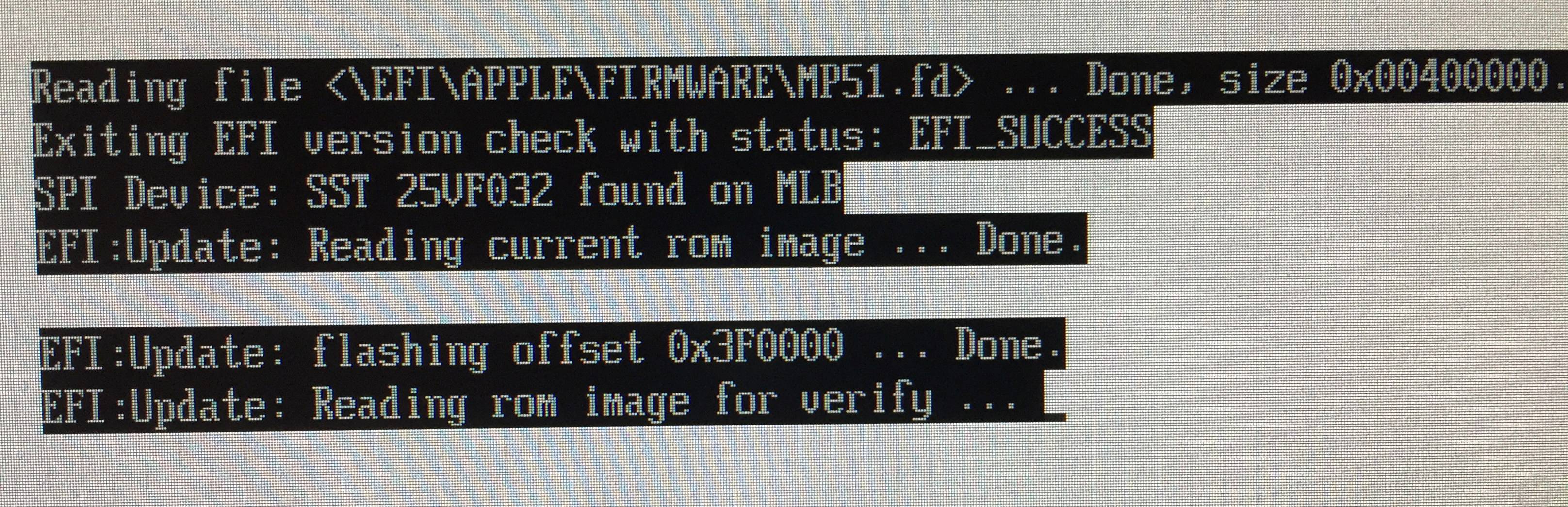

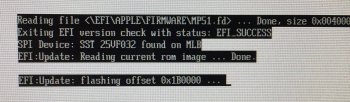

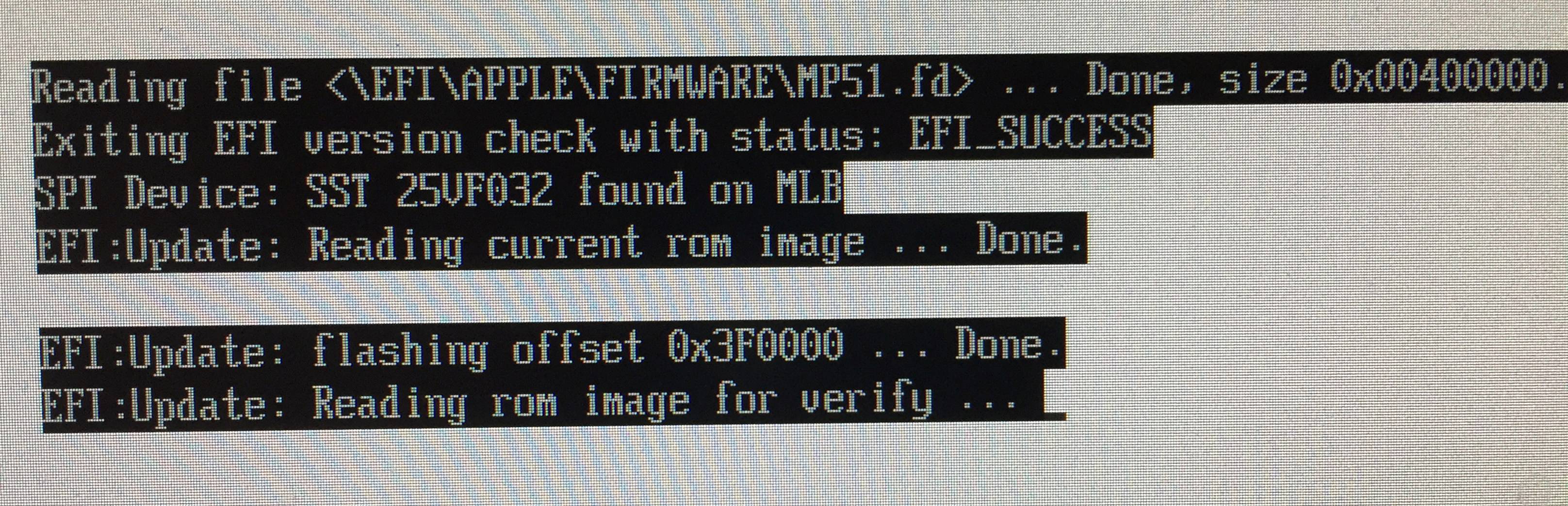

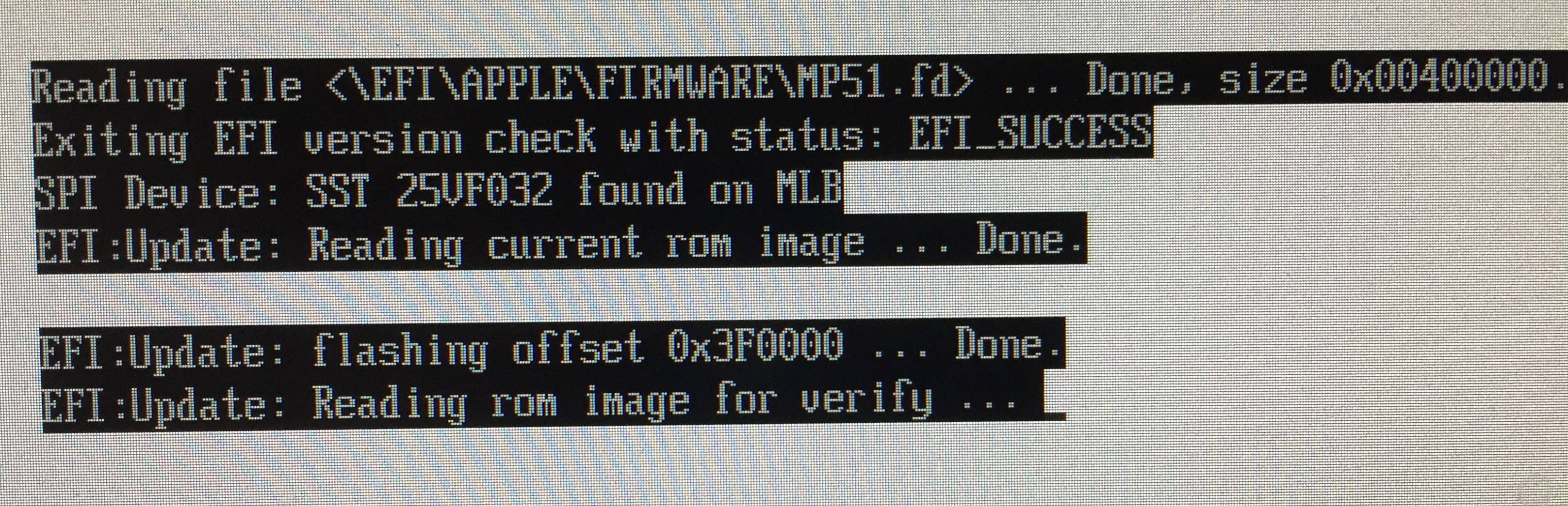

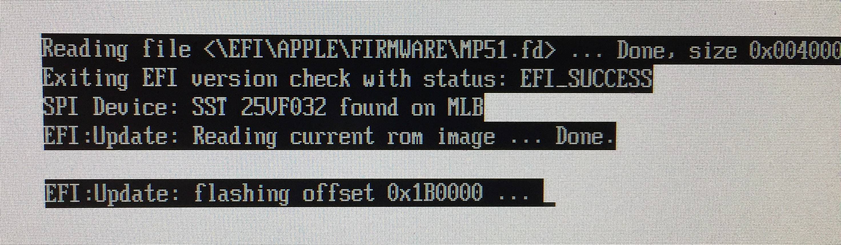

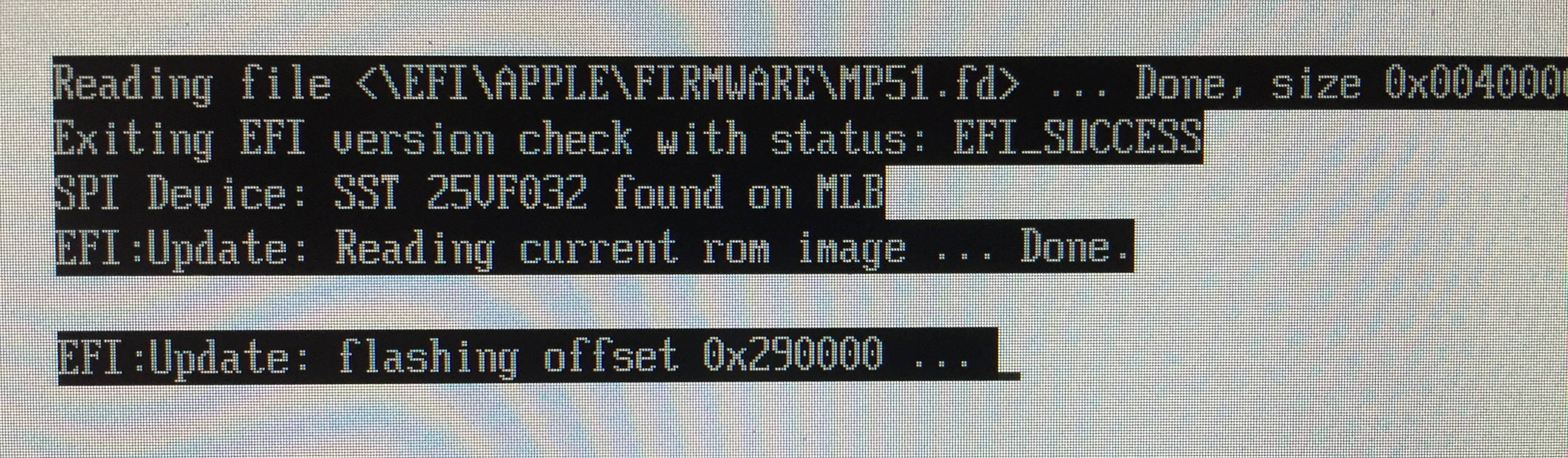

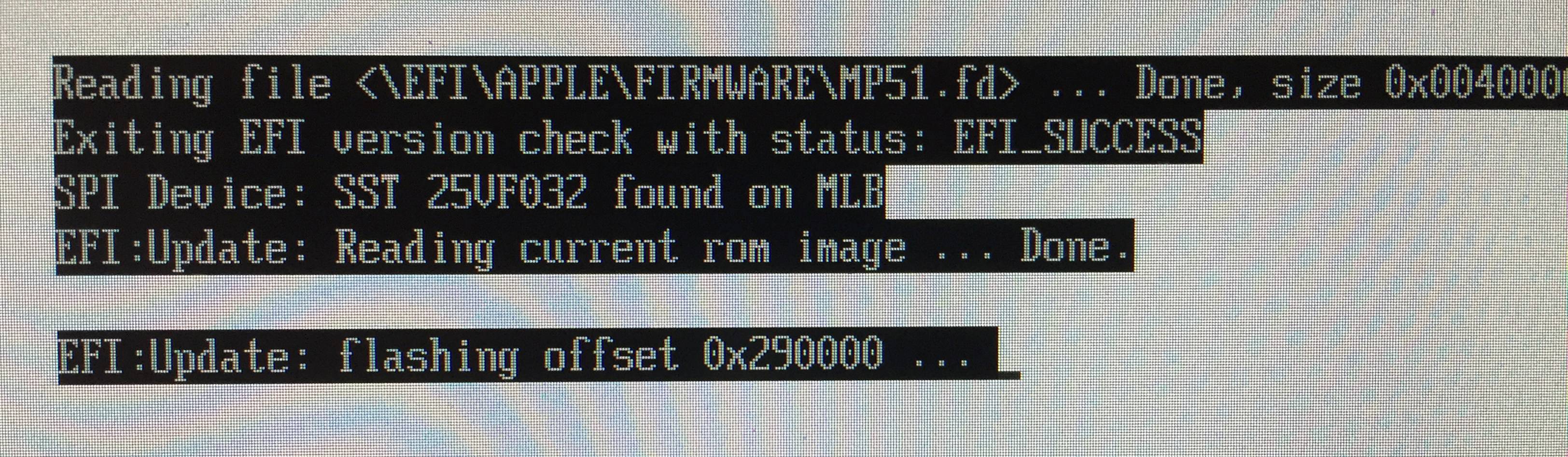

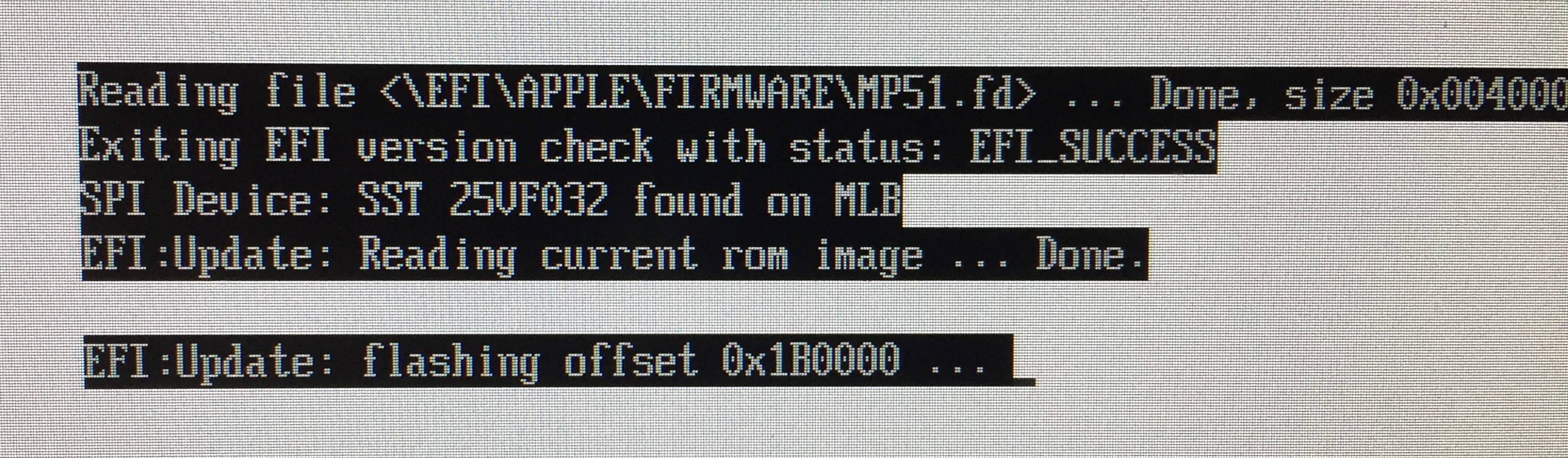

Just did the firmware upgrade 138.0.0.0.0 with the Mojave installer.
EFI-GTX Titan X (Maxwell)
No progress bar, but progress text.
Cannot confirm that the firmware upgrade took longer than other firmware upgrades before (about 30 seconds).

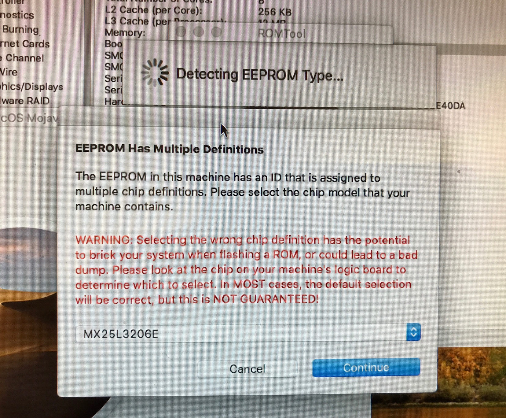

Booting from a spare 10.13.6 high Sierra, my 2010 finally made the jump to 0138.

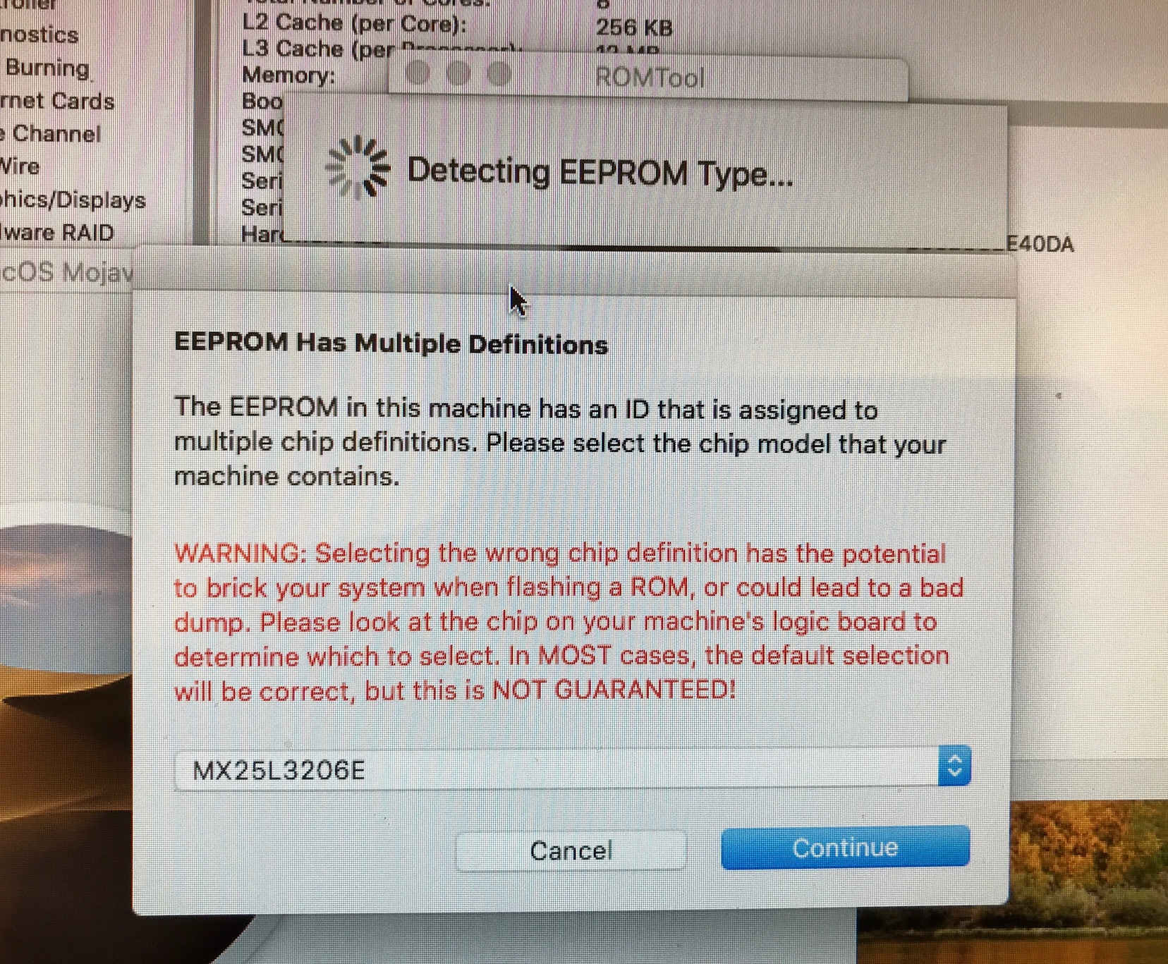

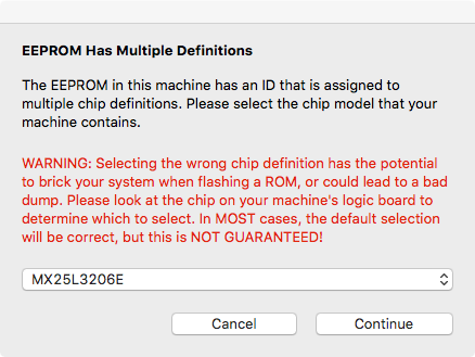

Backing up the 0138 rom with romtool, I was greeted by a new warning screen. At least the 2010 is half way there.
Any thoughts on which chip is correct for the 2010?

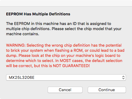

Never got the multiple definitions screen, flashed a dozens of times this week with v2.0, check your SPI-Flash before trying anything.
SST25VF032B, btw.
SST25VF032B, btw.
I got that screen with every flash and used the default profile. I was using v. 2.0
I should have, but wasn’t able at check my chip. dosdude said the default profile for cMP would be correct since using RomTool v.1 presented no problems. It’s the same as v.1
I’ll check the default for mine and report back. Mine is a Mid-2012.
I had one Mac Pro with Macronix 25L32050, @Pandanl one it's the second that I saw.
Wow, two Macronix SPI-flashes in one day. Maybe it's more common in cMPs than I thought.
Mine was built in Feb 2013, so perhaps by that time, they were using whatever parts were still left for these things.

Thanks. So it 'should work'. Looking at the chip to read the number is still suggested.
The new version seems to work on Mojave b7.
Mine reports the same chip. No way to be 100% without looking, but odds are in your favor.
Since you flashed with v1 of the tool, there is every reason to believe this will be trouble free for you.
Christmas has a come early this year. I can finally use my Mac Pro as a htpc.
For info, this is NOT the 1st time that Apple provide the GPU audio drive in beta OS. They also did that in High Sierra beta, but then remove that in the official release.

Thinking about it. I have the HDMI audio driver patch installed. It had been non functional for a while.
Then most likely just the new kext allow the HDMIAudio to load properly again, not really has the audio driver included.
