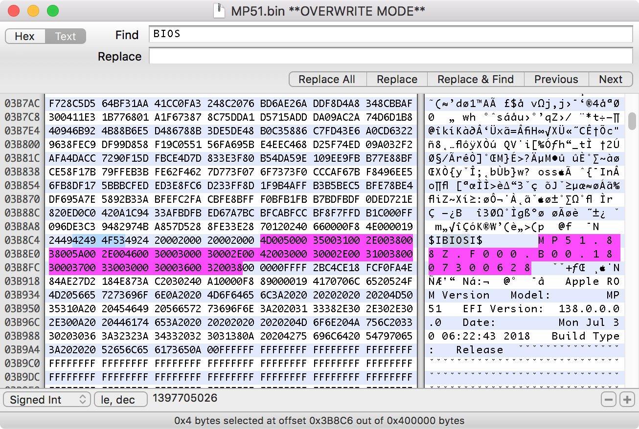

The BIOS version for 138.0.0.0.0, like on Geekbench, is MP51.88Z.F000.B00.1807300628.

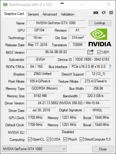

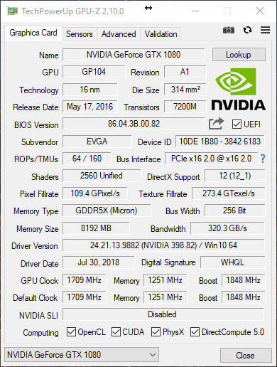

im happy to report that with testing by @Gamer9430
the new BootROM enables PCIe 2.0 for his stock GTX 1070 in windows (BIOS install IIRC) 😀
ill let him post the pictures 🙂

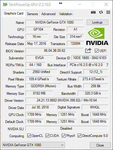

I can also confirm that GTX1080 is at full PCIe 2.0 speed under bootcamp. feels like in heaven 😀

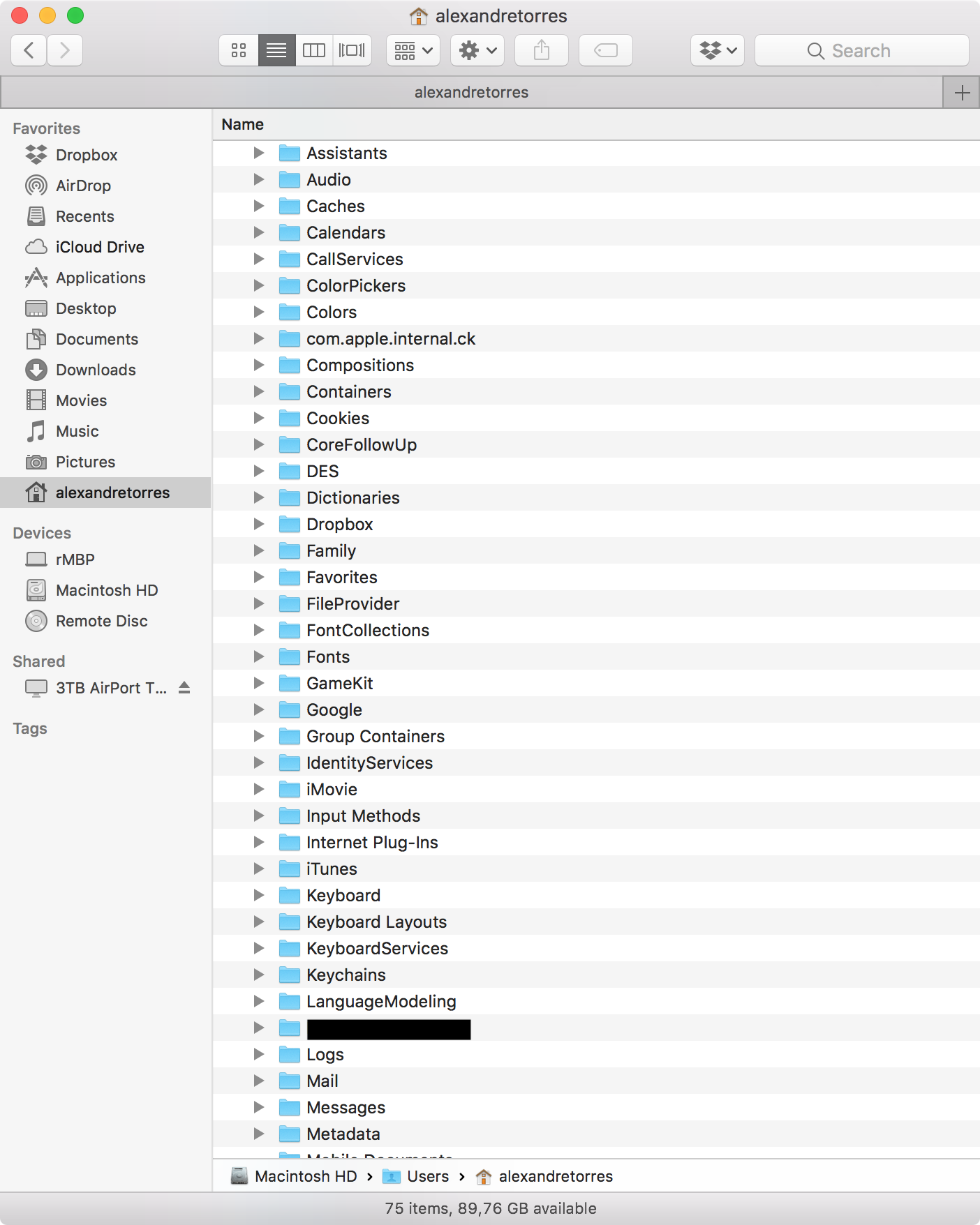

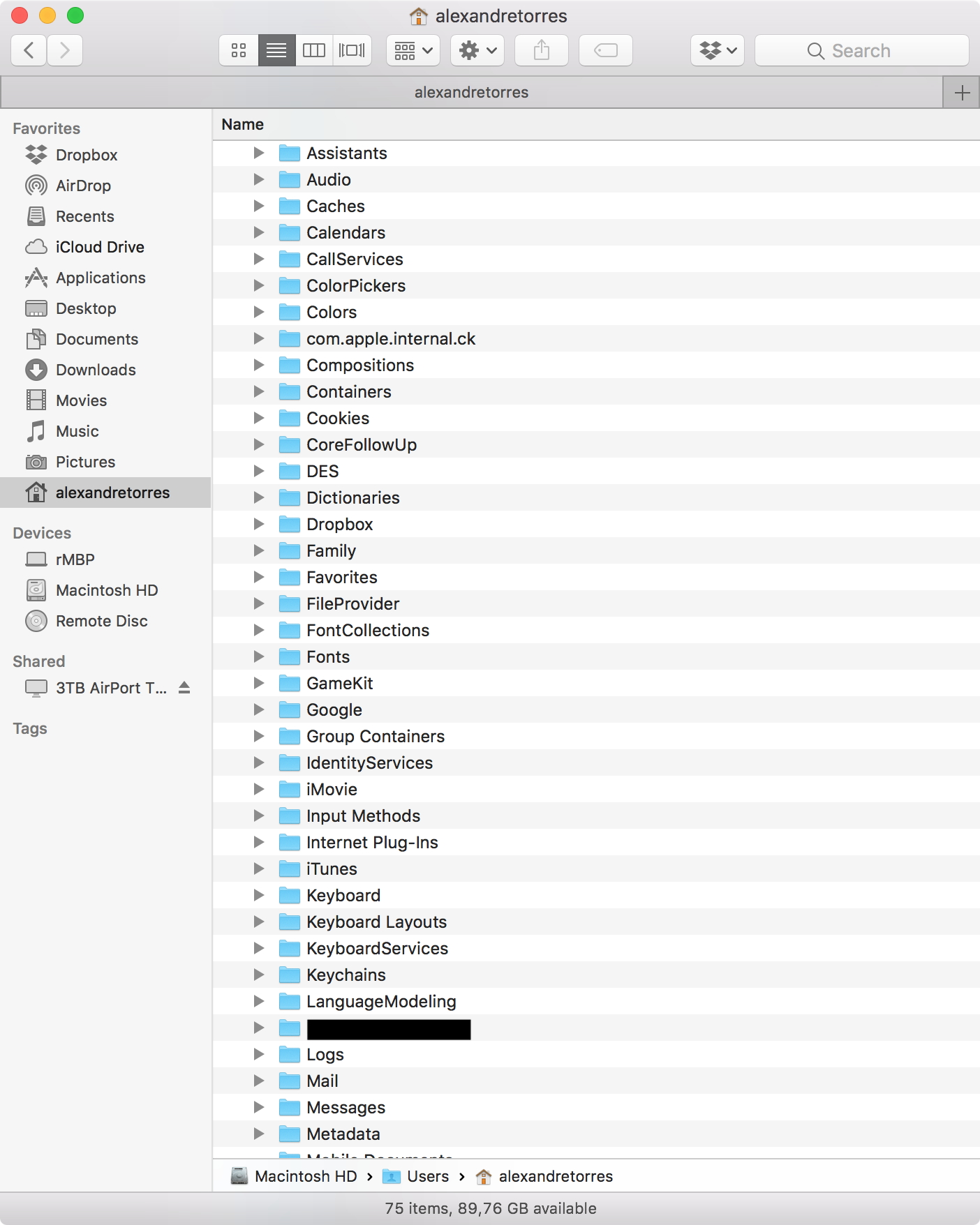

[doublepost=1534337729][/doublepost]When eventually happens, it's something like this (I've made that on my rMBP, just to illustrate)
This is a driver bug and it exist since WebDriver-387.10.10.10.25.160 (if I recall correctly)
it is easy to reproduce as you guys see in the screenshot below

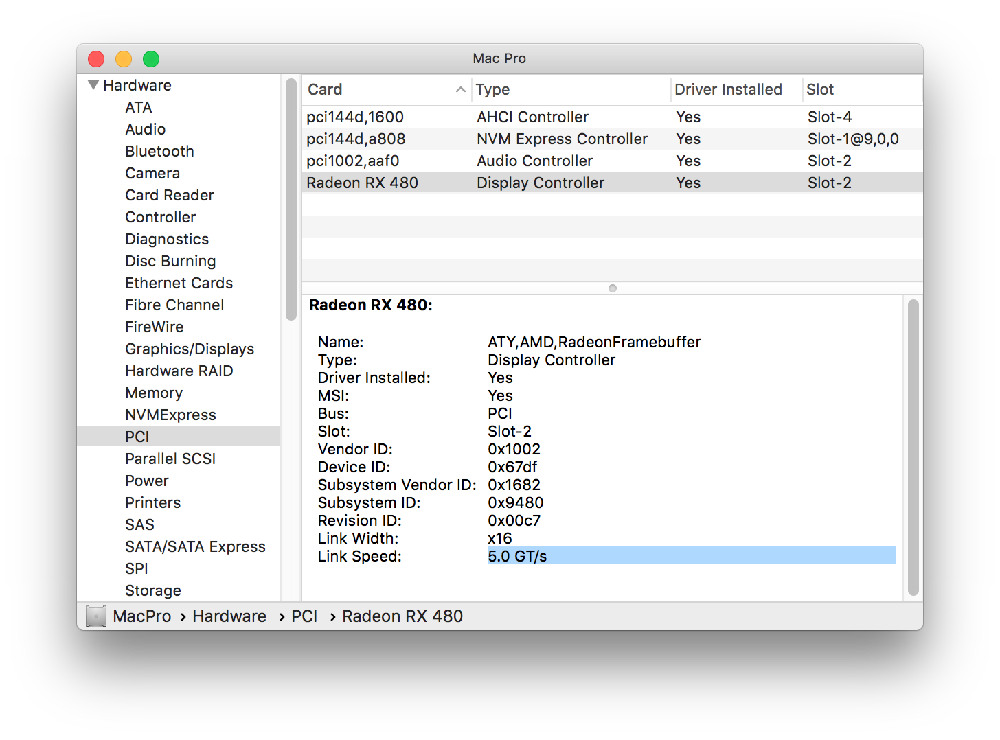

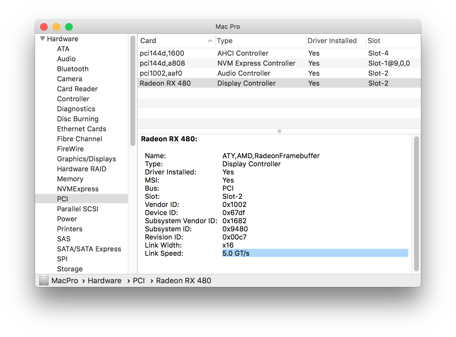

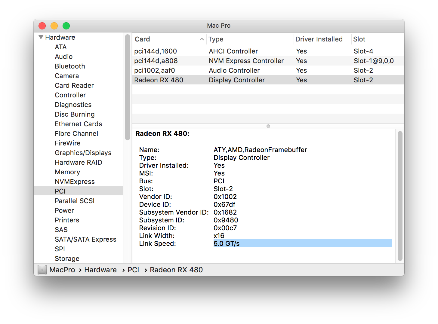

Running 10.13.6 with EFI firmware 0138 also allows the RX480 to run at 5.0 GT/s and the hdmi audio patch to work.

In Mojave beta and high sierra 10.13.6 with HDMIaudio kext installed, the RX480 has HDMI audio enabled in safari with firmware 0138.

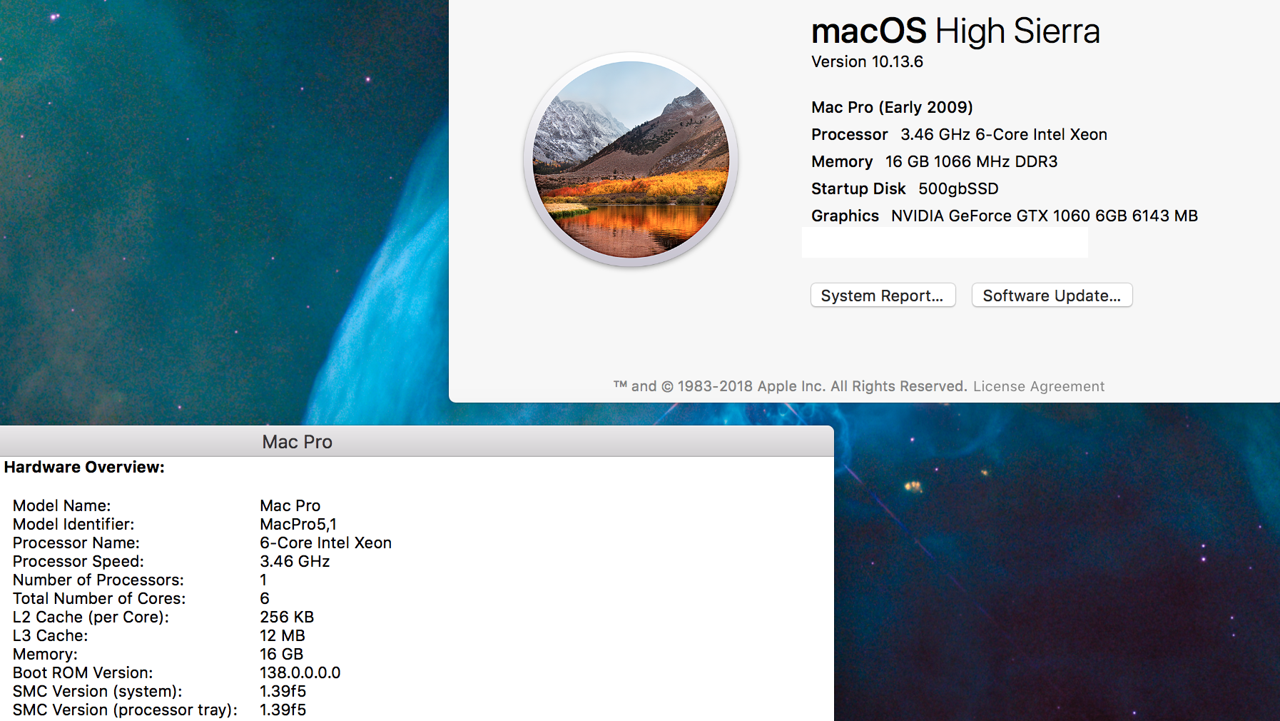

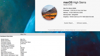

For anyone wondering, tsialex was right on the money. No problems installing the firmware on a Mac Pro 4,1->5,1, running 10.13.6, with a Geforce 1060:
