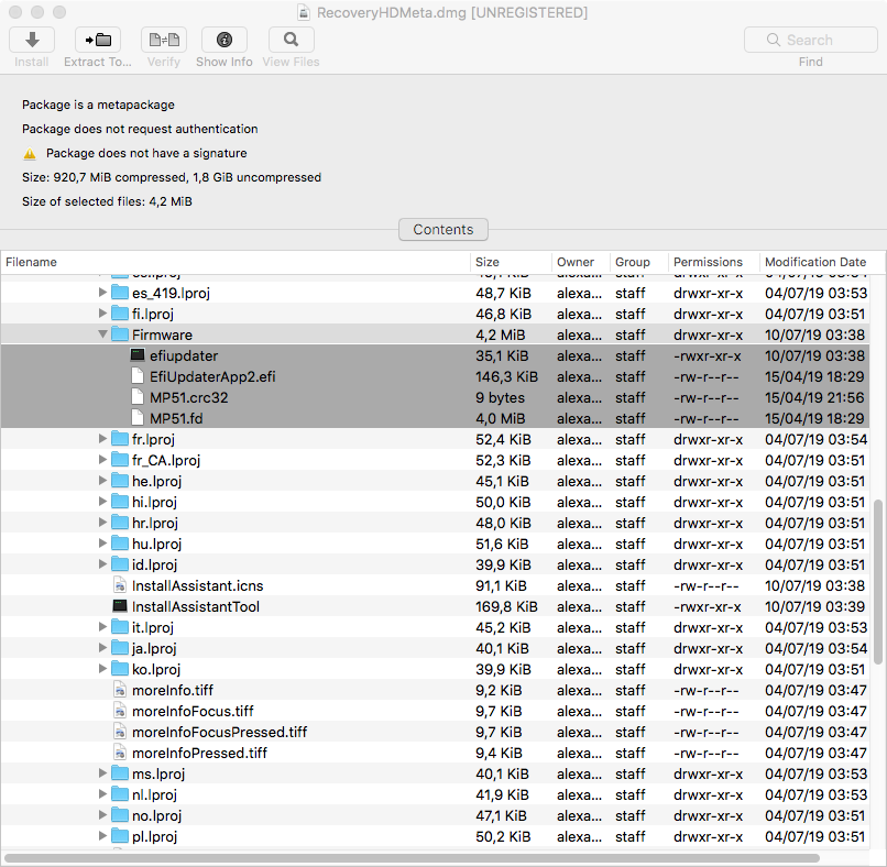

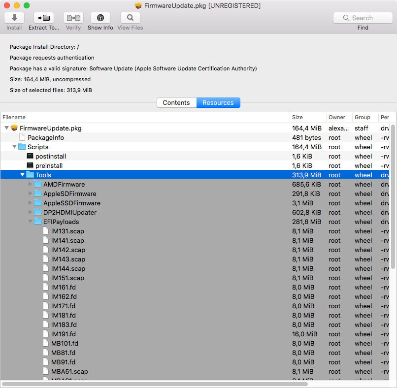

I just downloaded the FirmwareUpdate.pkg from the newly released 10.14.6 DP5 (18G75a), no new firmwares that I saw.
Unless I've gone completely blind, it seems that there isn't a bootrom update for the cMP5,1 anymore in the latest Mojave Installer.
I swear to god I've seen it before here.
