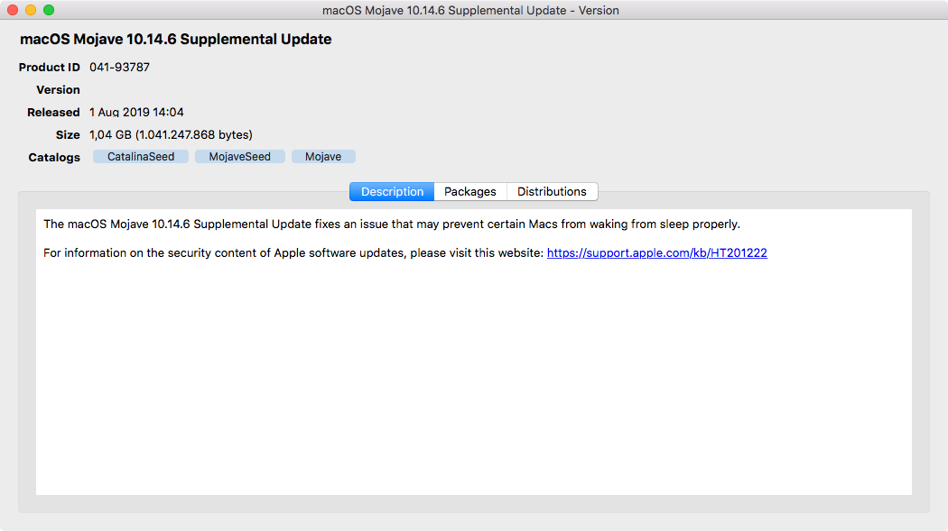

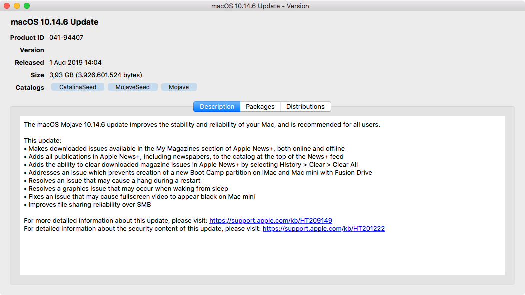

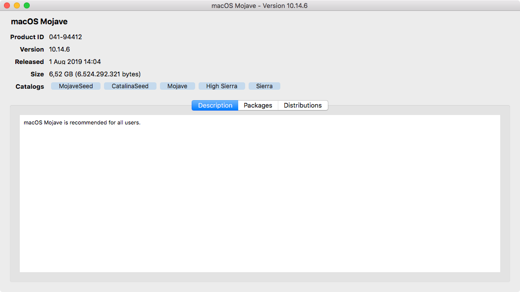

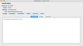

Apple re-issued today the full set of 10.14.6 updates along the Supplemental Update:
  • MAS Mojave 10.14.6 full installer, macOS Mojave 041-94412
  • Delta, macOS 10.14.6 Update 041-94411
  • Combo, macOS 10.14.6 Update 041-94407
  • BridgeOS, BridgeOSUpdateCustomer 041-94415
  • macOS Mojave 10.14.6 Supplemental Update 041-93787
Screen Shot 2019-08-01 at 16.35.22.png Screen Shot 2019-08-01 at 16.35.04.png Screen Shot 2019-08-01 at 16.39.06.png Screen Shot 2019-08-01 at 16.38.46.png Screen Shot 2019-08-01 at 16.40.01.png
The new versions for the MAS full installer, Combo and Delta Updates already have the macOS Mojave 10.14.6 Supplemental Update - build 18G87 that:
The macOS Mojave 10.14.6 Supplemental Update fixes an issue that may prevent certain Macs from waking from sleep properly.
For information on the security content of Apple software updates, please visit this website: https://support.apple.com/kb/HT201222
