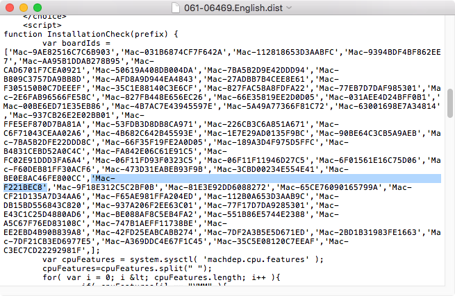

I wonder if this last Supplemental Update (Version 3?) is for a special or new Mac/MacBook?
No, all Mojave supported Macs including MP5,1 that installed the deprecated 18G87 build - see the board-id highlighted in the screenshot:
[doublepost=1567636894][/doublepost]
remind me how we download the full combo version?
AFAIK, Apple did not yet updated the Support site for the 18G95 build, still link to 18G87 061-06464 from August 26.
