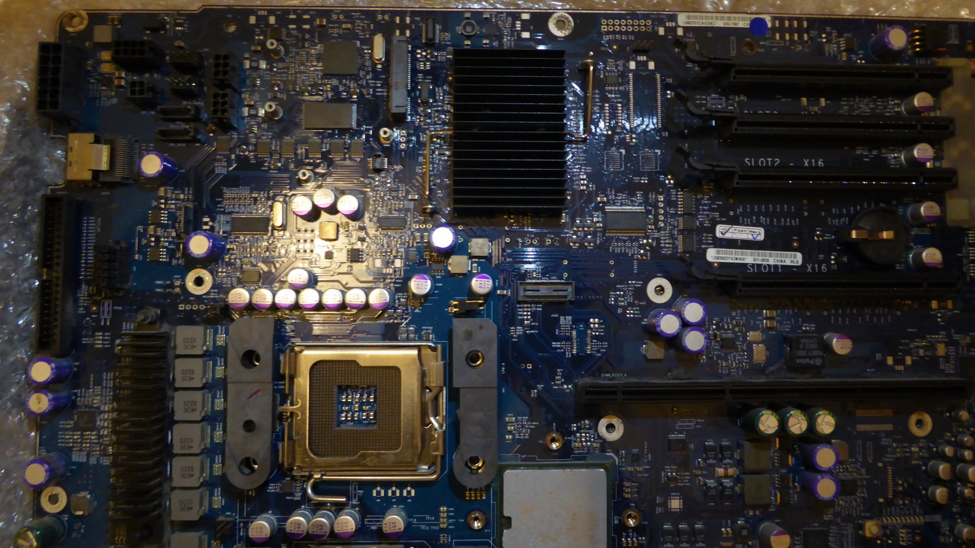

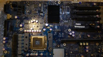

Hi there. Can you help me identify where is the Mac Pro 3.1 rom chip on the board? My board is bricked and I'm hoping to revive it by replacing it with a fresh efi rom and chip. I know the size of the rom is 2Mb but I can't seem to figure out which chip contains it. After replacing it, I would be using the ROMtool to edit it and insert the serial number. But before anything, I need to find the right chip. Would be great if you or someone else could shed some light into it. Many thanks.
