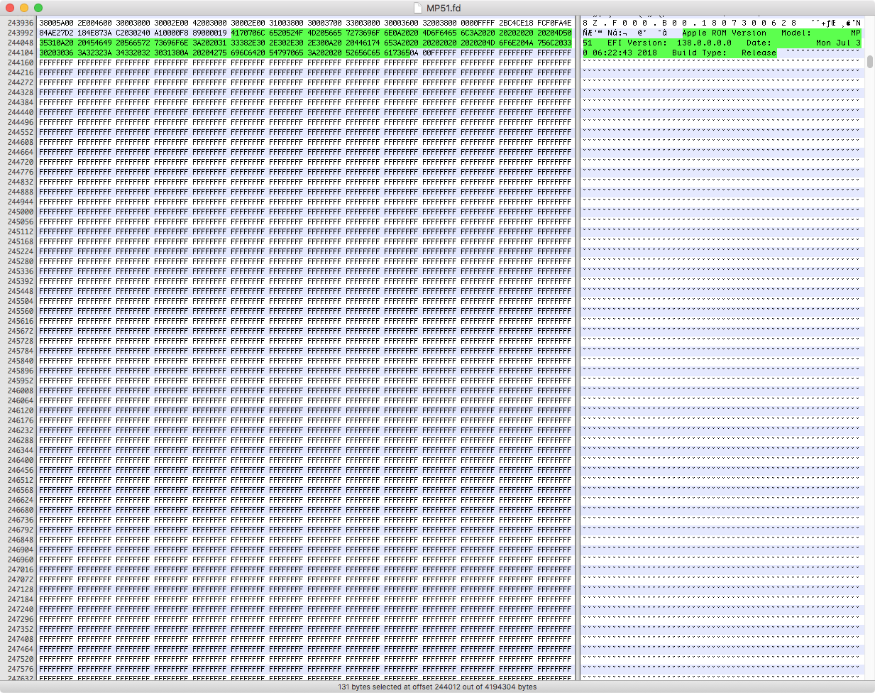

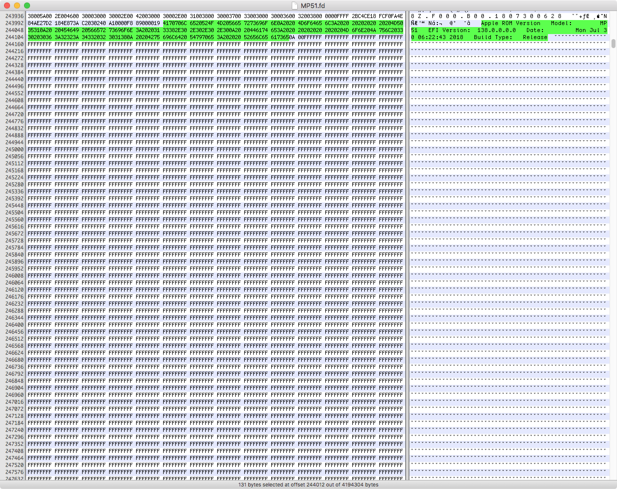

It's not a easy task, since the NVRAM space, SSN_HWC_SON block and the LBSN_BD sector are not present in the LOCKED.fd files. You can't just check your DUMP with the LOCKED.fd one.
I'm using HexFiend, binwalk, UEFITool to inspect the dumps.
With HexFiend I check for things like:
  • if the SSN_HWC_SON block is correct, in the correct address in the private part of the NVRAM. I saw one totally out of place, before base_20 binary.
  • if the LBSN_BD sector is correct and in the correct address, end of the BootROM. I saw one 4 bytes out of place.
  • compare sections of the ROMDump with the LOCKED.fd
With binwalk I check for things like:
  • strange things on the NVRAM, I've found macOS install logs in plist format (that was weird, seems a botched/interrupted macOS install).
  • duplicated NVRAM.
  • volumes out of place.
  • volumes bigger/smaller than the same ones in the LOCKED.fd files.
  • added DXEs
With UEFITool I check for things like:
  • valid checksums for the volumes.
  • if all the FFS are present.
  • sizes.
  • signatures.

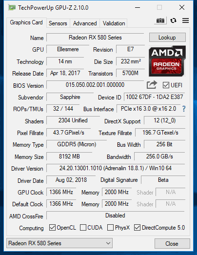

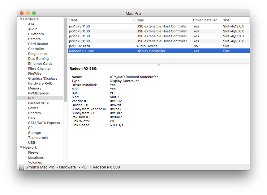

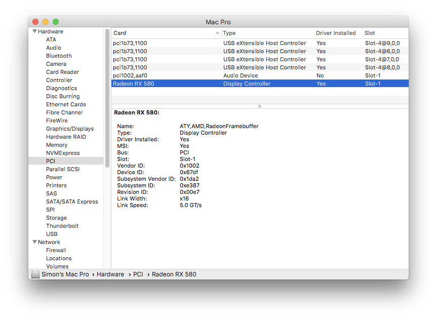

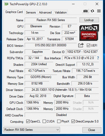

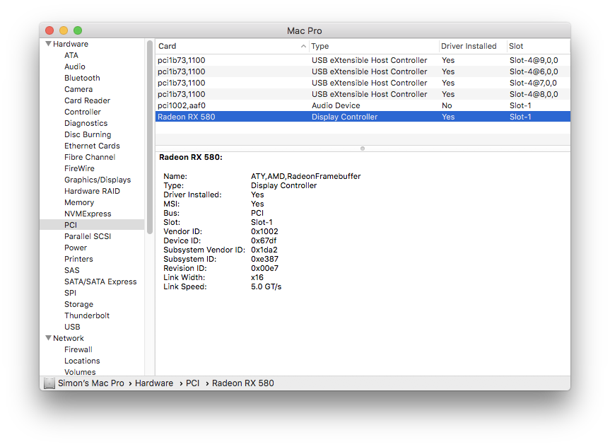

Here's a screenshot for my RX 580 in High Sierra, decided to take a look myself so I updated the firmware. The first time it failed to update (the system just rebooted after the flashing light/long tone) but the second time it took.

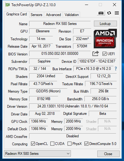

And here's a screenshot from GPU-Z in Windows 10.

As people have said before windows and mac os
I was specifically referring to the GTX 1080. I know the RX580 shows up as 5GT/s in the Mac OS with the new FW. But the GTX 1080 does not, at least for me, as I have previously posted. Although the issue is only cosmetic.

Here's a screenshot for my RX 580 in High Sierra, decided to take a look myself so I updated the firmware. The first time it failed to update (the system just rebooted after the flashing light/long tone) but the second time it took. View attachment 776919
The ? looks correct. It recognizes your video card as a PCIe 3.0 device that's been initialized at PCIe 2.0 x16

Okay. That sounds complicated. Instead of fixing it up is there a way we can easily virginize the firmware like it is on a new logic board? Then set the serial with Apple’s CD?
Yes, but…
The LOCKED.fd files are the full BootROM missing:
  1. The LBSN_HWC sector at the last bytes of the BootROM. That are set at the build time by the factory.
  2. The, what I'm calling, hardware descriptor compressed blob and the SSN_HWC_SON in the private part of the NVRAM space.
You can boot from the LOCKED.fd file restored to the BootROM, then can use BlankBoardSerializer to insert the SSN. That works ok until you try to access iMessage/Facetime/iCloud. Apple will block you like they block a hackintosh, since you're still missing SON and the LBSN_BD sector and your hardware UUID is incomplete.
So you need to extract the, what I'm calling, hardware descriptor compressed blob and the SSN_HWC_SON from your corrupted BootROM and insert in the LOCKED.fd.
If you your BootROM is so corrupted that you can even extract the 5 identifiers, and you don't have a backup dump, you can get at least 3 of them:
  • SSN is the same serial number that Apple printed on the backside gray/white label.
  • HWC is the 3 last digits of the serial number on 2009/2010, 4 last digits with 2012.
  • SON can be the Apple Order Number from your sales order/receipt or the Apple SKU for your model (easy to find)
  • LBSN is printed in a black label on the logic board, next to the tray connector, you'll have to remove the CPU tray cage (some work but totally doable).
  • DB you can use the data showed by Apple Serial Number decoders on the internet. It's not correct but it's better than leaving empty. (checked various SSNs and the date that the decoders show is more or less a month wrong, but totally wrong for Refurb Mac Pros)
With all this info inserted on the LOCKED.fd you will pass Apple checks and iCloud/iMessage/FaceTime will work.

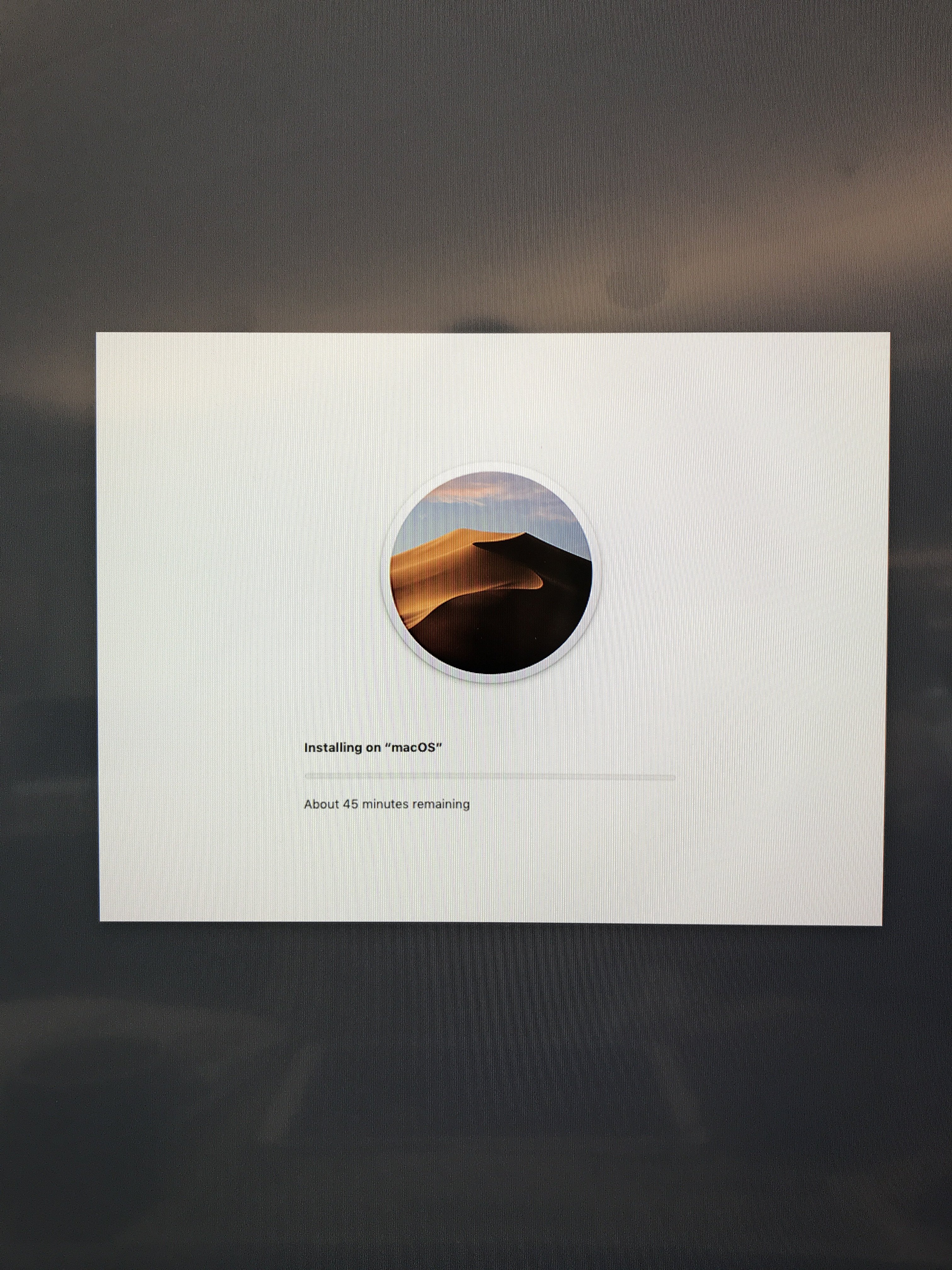

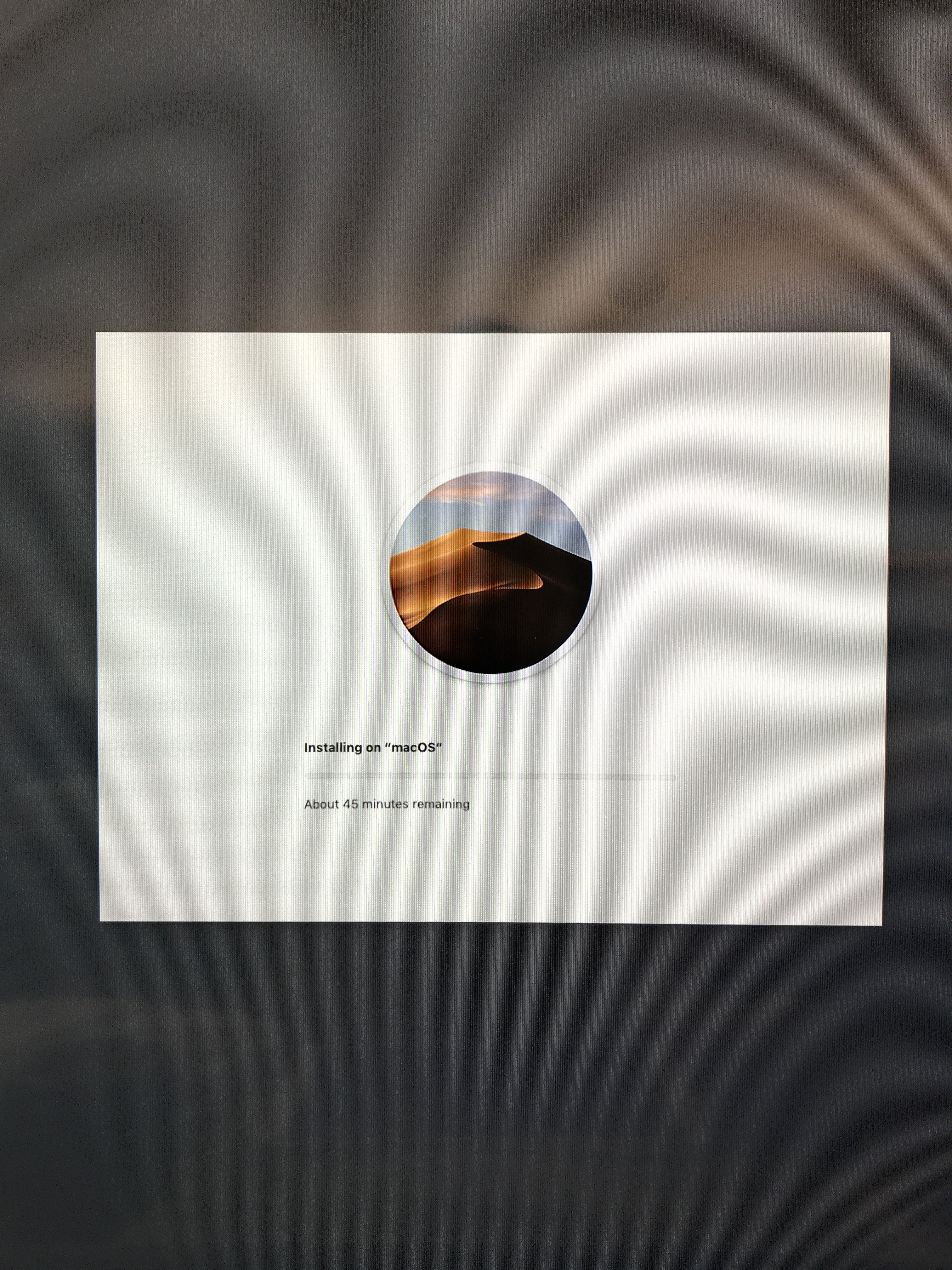

New install / update screens for the non efi crowd.
I got that too, it’s quite interesting it seems like it’s in a recovery mode or something as it has language preferences and wifi status. Anyone have further info on what this PB7/DB8 brought?
Edit: this update took a lot longer than the rest, I didn’t get any startup chime during the entire process and most of the update was spent on a black screen, the new updater seems to have promise for more.
