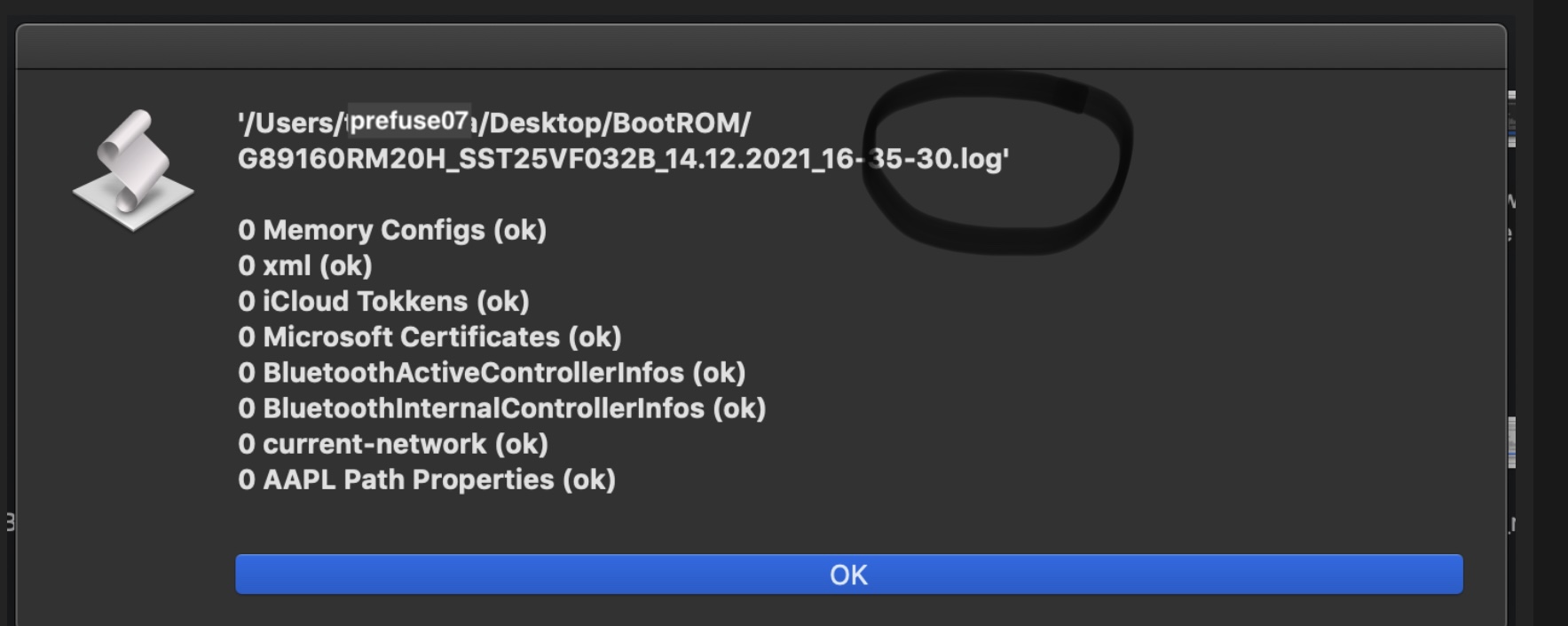

Anyway, back to the results from @Macschrauber tool, zero MemoryConfigs being present are just impossible - it's like to say you booted without RAM being identified and configured. So, something is seriously wrong with your NVRAM volume/hardware.
He analyzed a log file. Never thought about someone throwing a log file to the test firmware part of the script. Maybe I do some probing before, just in case.
Reactions: tsialex
