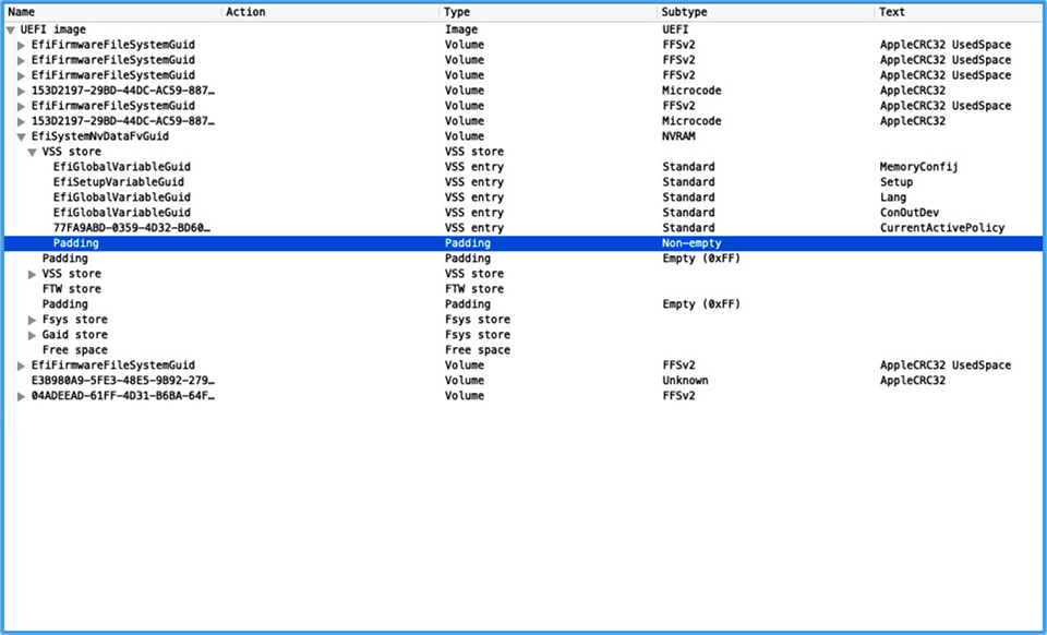

In case it helps...
In case it helps...
Not really useful, these you linked are ancient generic firmware upgrade images, years before 138.0.0.0.0 where Apple corrected the PCIe v1.0 being set to all non- cards.
  • Firmware Restoration CD 1.9 = MP51_007F_03B.fd (MP51.007F.B03)
  • Firmware Restoration CD 1.8 = MP41_0081_07B.fd (MP41.0081.B07) and XS31_0081_06B.fd (XS31.0081.B06)
10.14.6 Mac App Store installer have the 144.0.0.0.0 MP51.fd:
Code:
Install\ macOS\ Mojave/Install\ macOS\ Mojave.app/Contents/Resources/Firmware/MP51.fd
1st post have the link, look at "What to do if your Mac Pro bricked:".
Thanks. PCI-E Completion Timeout is in there.

Hi @tsialex,
I have an early 2009 Mac Pro 4.1, flashed to 5.1 and BootROM 144.0.0.0, running Mojave with a RX 570, and Windows 10 installed in UEFI mode. 😬 I wish, I had discovered this loooong but very informative thread earlier…
I made a ROM dump as described in post #1 … and now I'm afraid, I'm on the verge of bricking my Mac Pro.
Can you please PM me regarding the BootROM reconstruction service?
Thank you.
Hi @tsialex,
Thank you.
Sure, get everything as instructed and I'll get back to you ASAP.
My current BootROM:
Fixed: Yes
Base: 127BCDh
Address: FFD27BCDh
Offset: 7885h
Full size: 8433h (33843)
My saved BootROM from 2020-07-16 (how can I check if it's version 144.0.0.0?):
Fixed:Yes
Base: 1256F3h
Address: FFD256F3h
offset:56A8h
Fuls1ze: 980n 43777
Does this mean I should flash my BootROM with the older one which has more free space? Haven't done it since @tsialex helped me clean the ROM a couple of years ago. Would be good to verify that it's version 144.0.0.0 if possible, but I think it is.
Thanks for any assistance!
