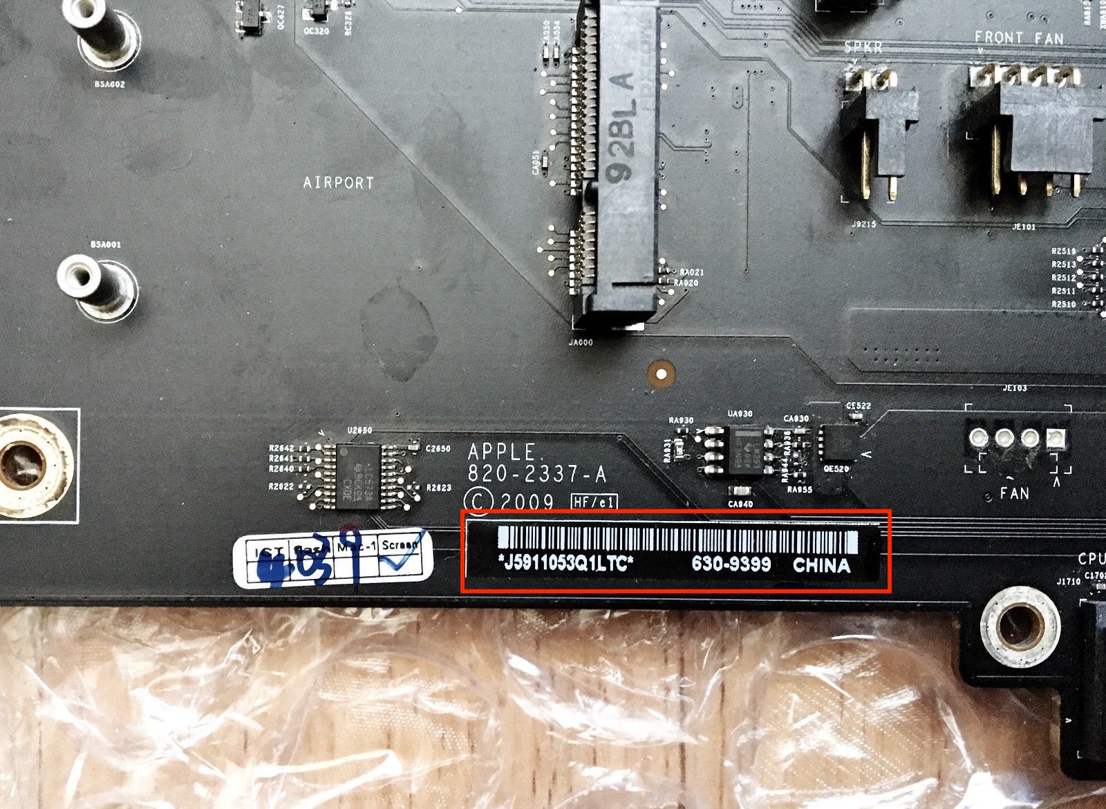

On the MP5,1 Logic Board:
MLB SN is printed on a black/white label near the AirPort connector and the male CPU tray connector. It's usually to the left of the male CPU tray connector, but can be placed to the right too.
Example picture:
In the picture above, MLB SN is J5911053Q1LTC and the part number/SKU of this logic board is 630-9399. BD is not present on the labels of the logic board.

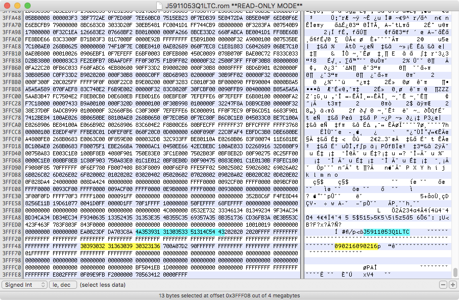

On the MP5,1 BootROM:
MLB SN and BD don't have ASCII labels showing their location in the BootROM, they have fixed positions and are used to calculate the Mac Pro Hardware UUID:
Identifier:Start address:End address:
LBSN0x3FFF080x3FFF14
BD0x3FFF500x3FFF5B
Example picture:
In the picture above, MLB SN (cyan) is J5911053Q1LTC and BD (yellow) is 090216090216. It's easy to find the MLB SN and BD position, it's at the very end of the BootROM.

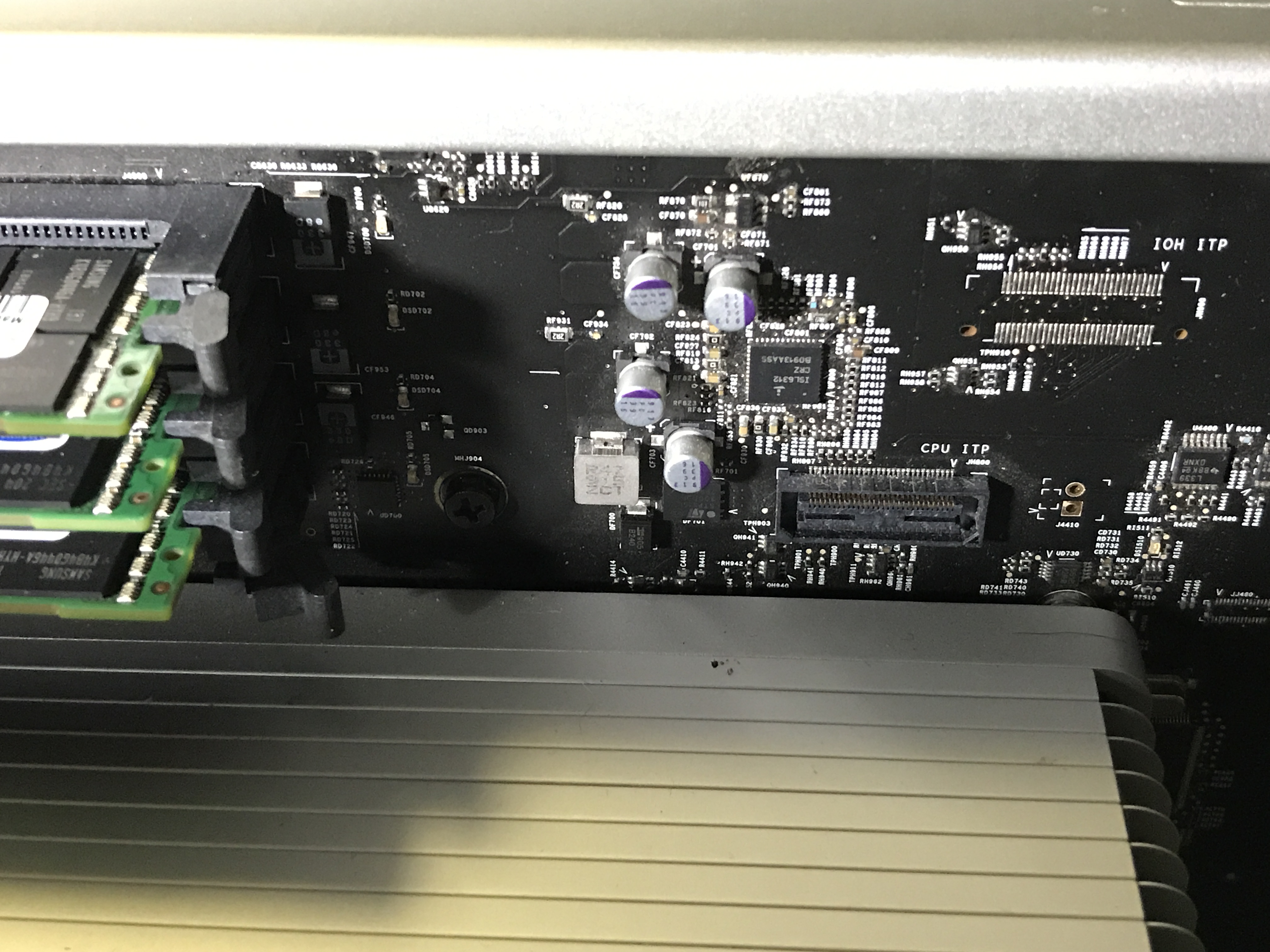

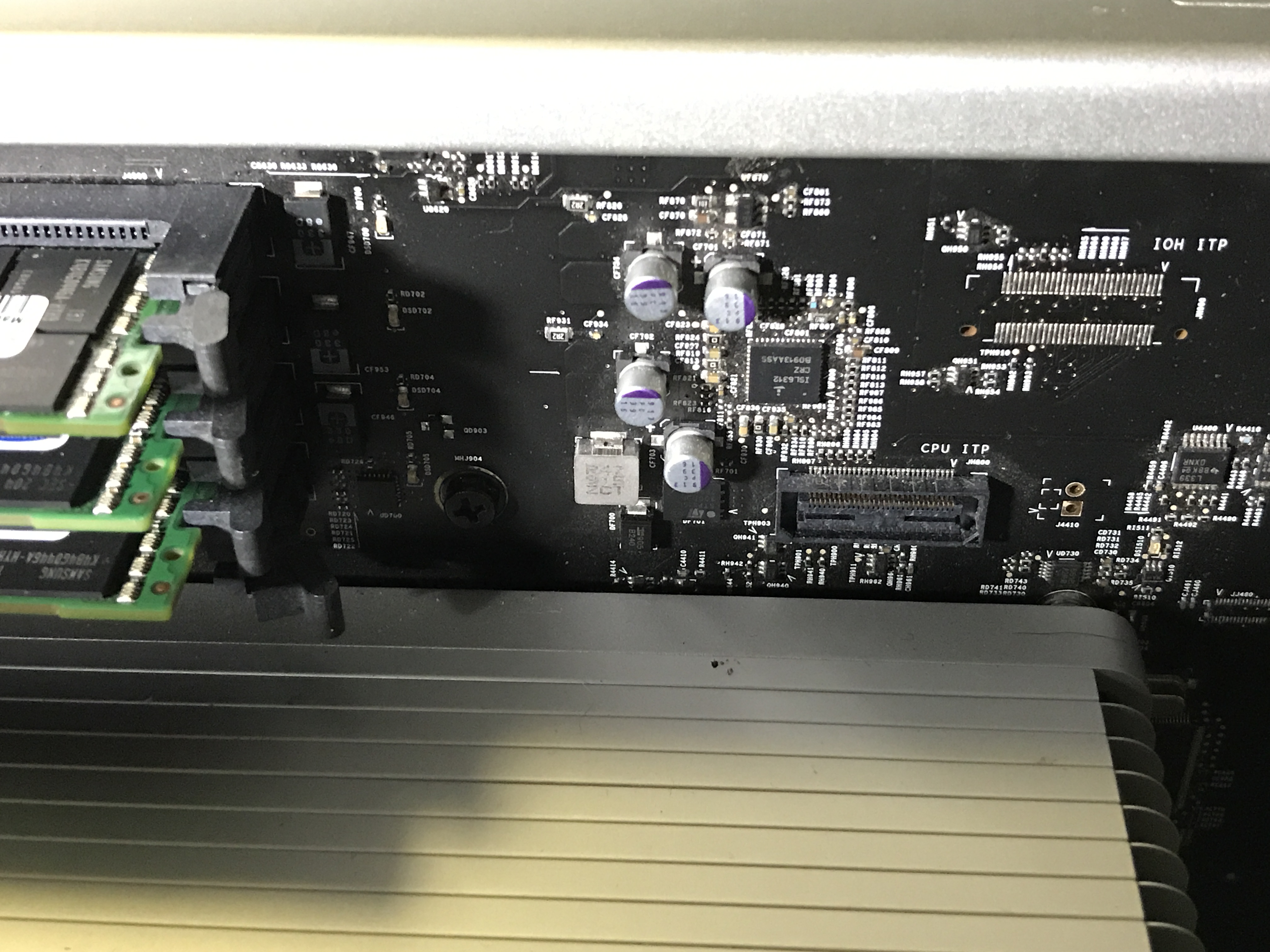

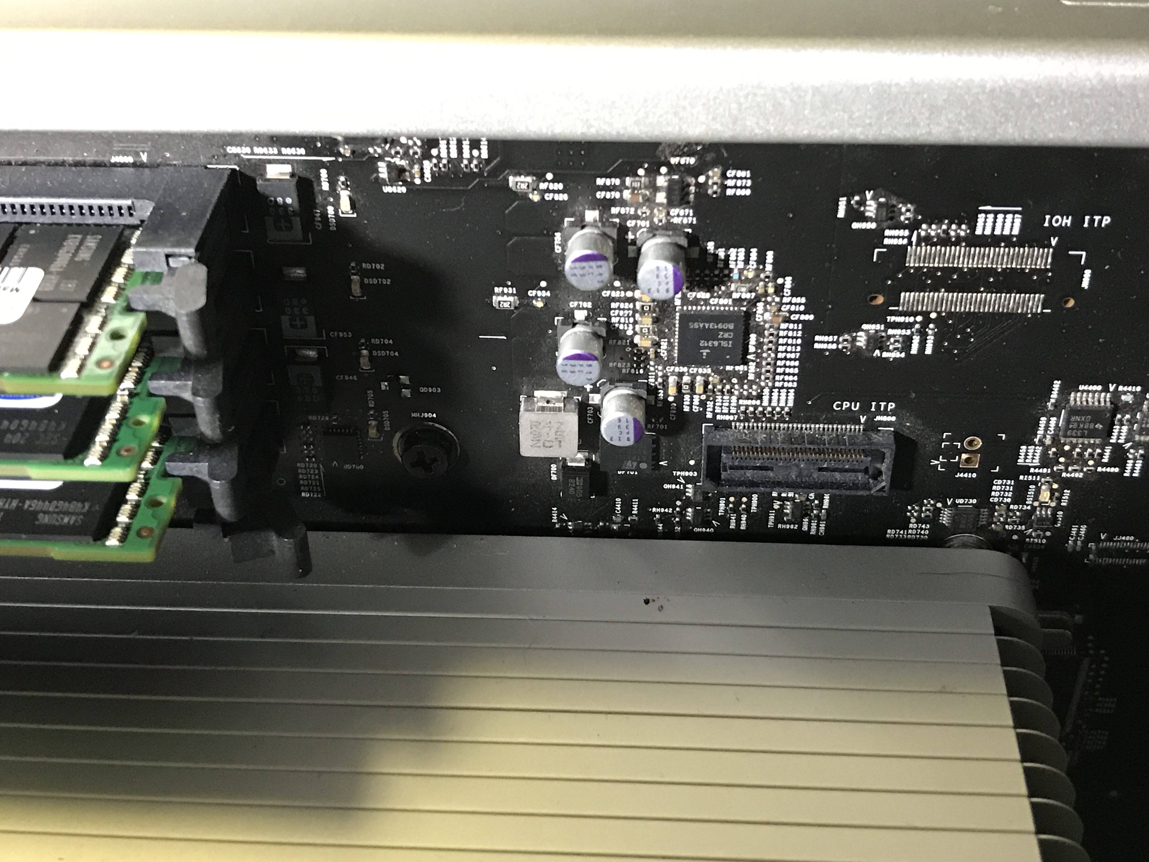

The connector on the 4,1 / 5,1 is shared with MacBook Pros from the 2009/2010 timeframe. Early production 2009's only have one connector on the logic board. Newer 2009's and beyond also feature the same connector on the CPU tray.
While I currently forget the exact molex connector name, I've posted the details in this forum the past when I first brought up the product as an option that's far too costly for it's own good.
About the CPU tray molex connector, I don't think that is correct. My dual 4,1 B08 with logic board build date 20100626 only has the pads on the tray and my 4,1 single with build date 20091209 don’t have the connector soldered too.
Btw, my B08 isn’t a refurb one.
About the CPU tray molex connector, I don't think that is correct. My dual 4,1 B08 with logic board build date 20100626 only has the pads on the tray neither my 4,1 single with build date 20091209 has the connector soldered.
Btw, my B08 one isn’t a refurb one.
My 2009, purchased shortly after introduction does not have any molex connectors on it. The pads are there for placement, but there are no connectors.
The 2009 replacement I picked up in 2013, has a molex connector on the cpu tray.
The replacement cpu tray I purchased from Ebay does not.
Most CPU trays do not have the connector.
Looking at a spare 5,1 dual tray, there are no connectors mounted.
I wonder what's up with that? Perhaps a refurb tray?
I think that beyond some date all trays are factory programmed to 1.39f11, trays for 2009 models were made for little more than a year, almost 4 years for 1.39f11.
If Apple needs 1.39f5, the repair centre installs it soldering the molex connector and reprogram it. Trays refurbished needs the connector on the pads for diagnostics too.
Btw, that's BIG FRANK on your tray. Can you see any flux residue?

Interesting, the IOH ITP pads are tinned on your board, on my trays none are.
No residue. It looks like a clean surface mount job on par with all other components on the cpu tray.
The connector is hooked up to the CPU ITP, not the IOH ITP.

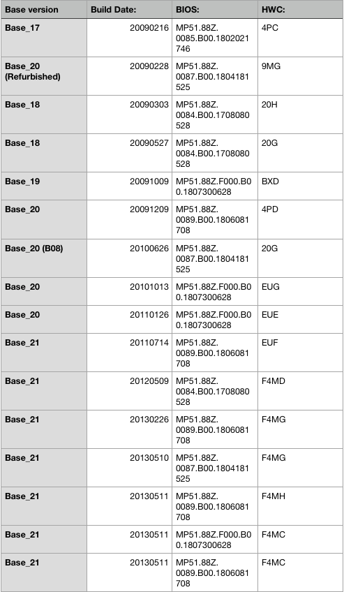

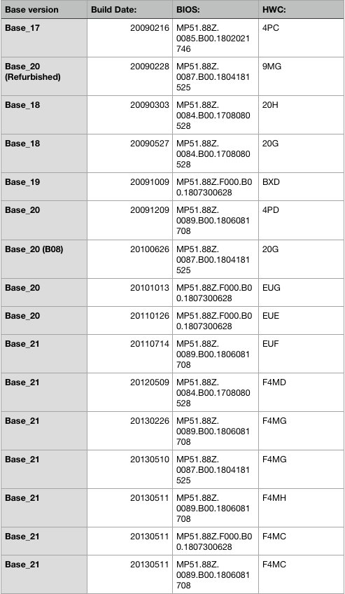

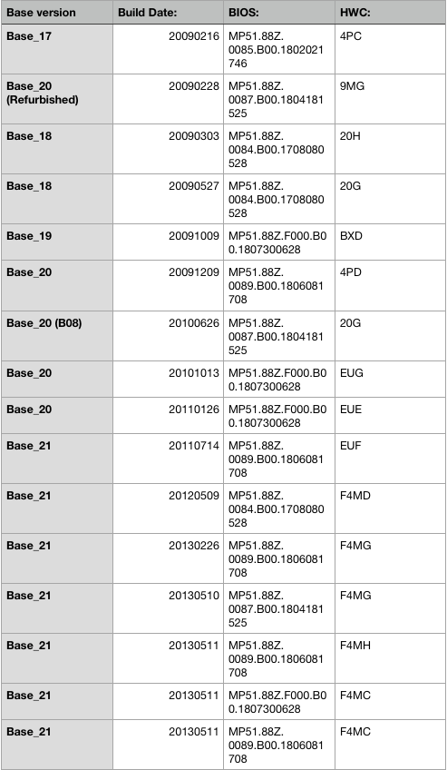

Checked 17 different MP51 so far. Found some things in this dataset:
  • Base_17 was used in February 2009
  • Base_18 was used from March to May 2009
  • Base_19 was used in October 2009
  • Base_20 was used from December 2009 to January 2011
  • Two Refurbished 2009 ones got Base_20
  • Base_21 was used from July 2011 to May 2012
  • Three were build at the same day, one a day earlier, maybe was the last day logic boards for new MP51 were produced?
Looking at my firmware, mine is Base_20, EUH, manufactured May 2011.
Update: I searched for all the identifiers you listed in your post #601. They are all present and look good. 🙂
