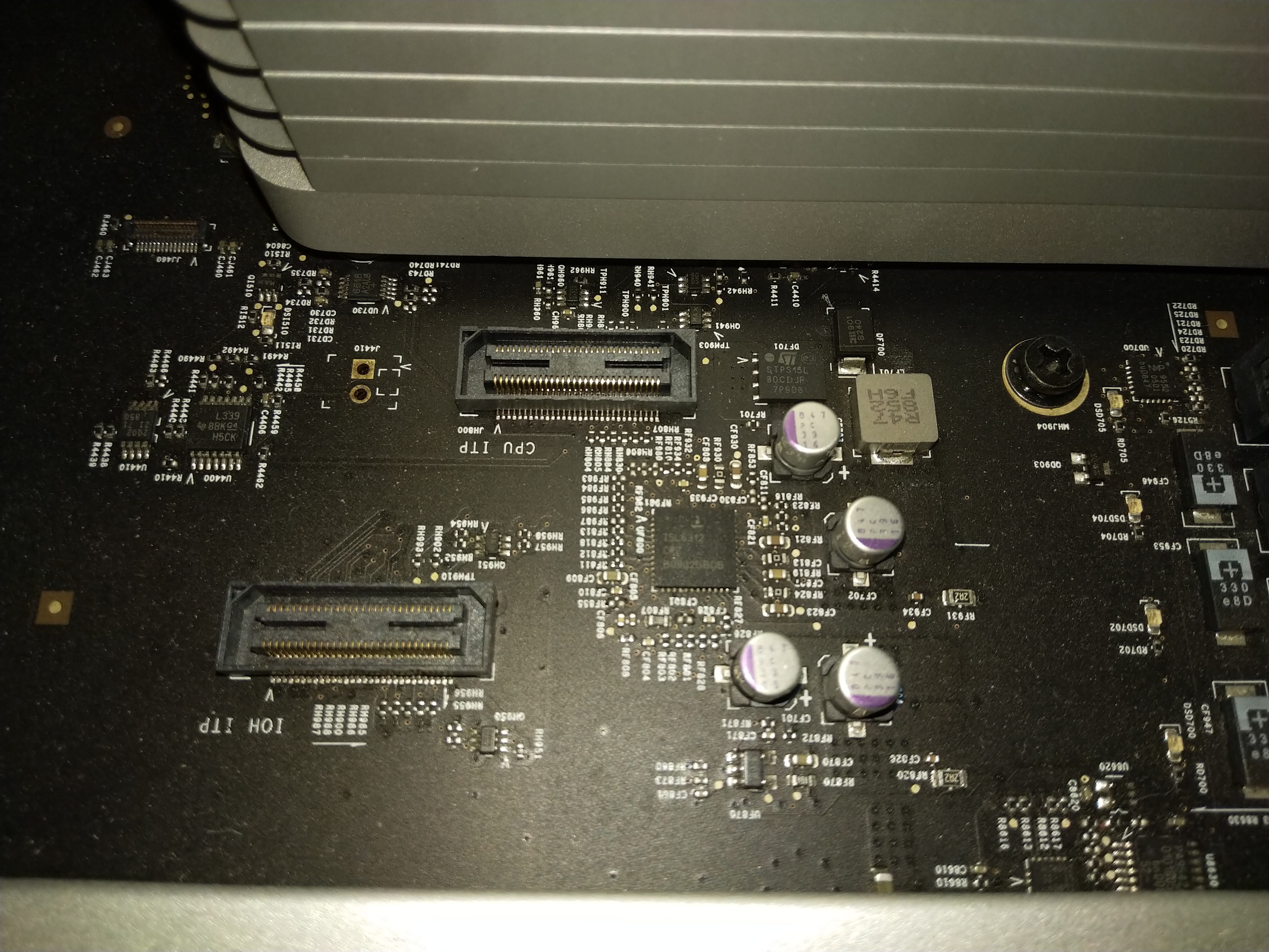

About the CPU tray molex connector, I don't think that is correct. My dual 4,1 B08 with logic board build date 20100626 only has the pads on the tray and my 4,1 single with build date 20091209 don’t have the connector soldered too.
Btw, my B08 isn’t a refurb one.
@tsialex FWIW, in case it's helpful... I have a 2009 I picked up a few weeks ago that has both connectors soldered to the tray.
Could you please post pictures of the connectors on your board. I'd like to see it.

I thought that the left pad one used Molex connector like LITTLE FRANK, now we know that’s both use the same connector as BIG FRANK.
