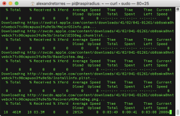

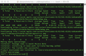

got this error in terminal:
curl: (56) Recv failure: Connection reset by peer
Could not replicate http://swcdn.apple.com/content/down...webck7tx90cmpuso3fu9e5b/RecoveryHDMetaDmg.pkg: Command '['/usr/bin/curl', '-fL', '--create-dirs', '-o', './content/downloads/41/02/041-01261/ob0saka8hntwebck7tx90cmpuso3fu9e5b/RecoveryHDMetaDmg.pkg', 'http://swcdn.apple.com/content/down...webck7tx90cmpuso3fu9e5b/RecoveryHDMetaDmg.pkg']' returned non-zero exit status 56
I've erased my cached RecoveryHDMetaDMG.pkg to check and It's working here:
Screen Shot 2018-09-01 at 14.03.07.png Screen Shot 2018-09-01 at 14.06.46.png
