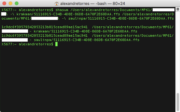

Just to everyone know:
Apple updated the MP61 NVMe DXE with 10.13.5 trashcan BootROM upgrade (MP61.0124.B00).
So, now everyone with NVMe on MP51 is outdated :p

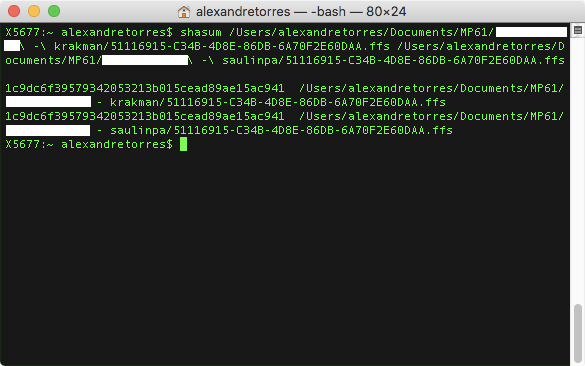

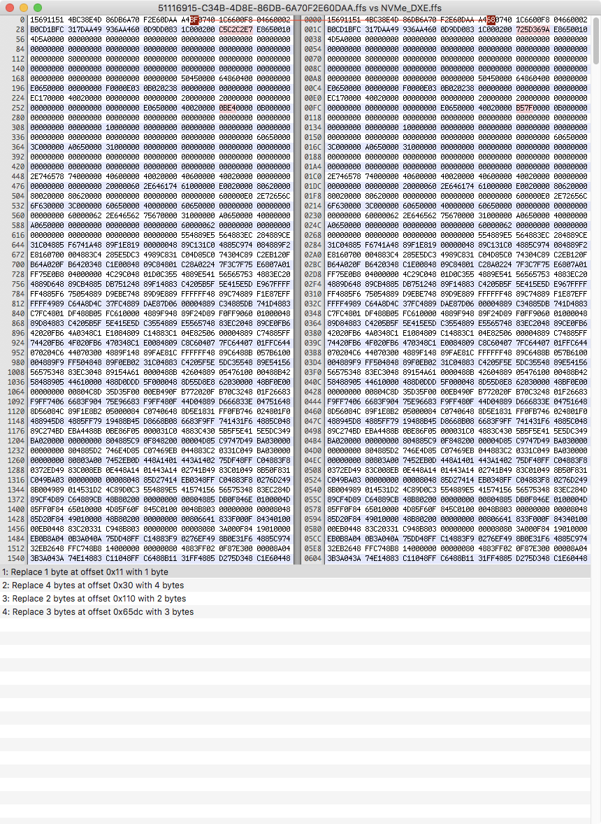

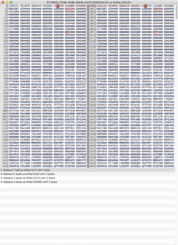

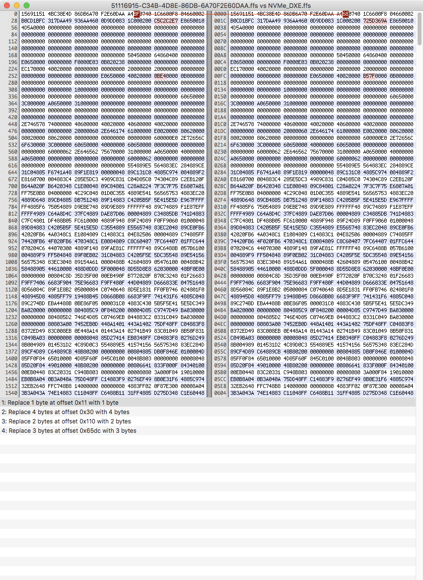

Checked the NVMe DXE from the two different MP61 MP61.0124.B00 dumps that I have (thx @krakman and @saulinpa) and compared with the usual NVMe DXE.
Changes are little, as you can see.
Screen Shot 2018-09-03 at 11.07.38.png Screen Shot 2018-09-03 at 11.11.57.png
[doublepost=1535984871][/doublepost]Who wants to test the new one? I only have SM951-AHCI and SSBUX at the moment.
View attachment 779412 View attachment 779413
