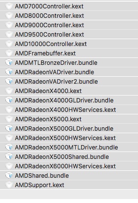

Which kext is that specified in? I can't find it in the 9500 or X4000 kexts. For Vega it's 1/yes for both encode and decode in the X5000 kext.

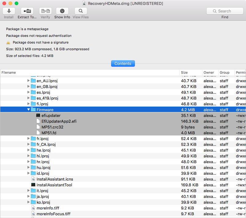

Ran the 18A384a installer on a machine already updated to 138, it didn't ask to flash the firmware.
It's the same, I've checked the MP51.crc32 file in Firmware folder of RecoveryHDMeta.dmg:

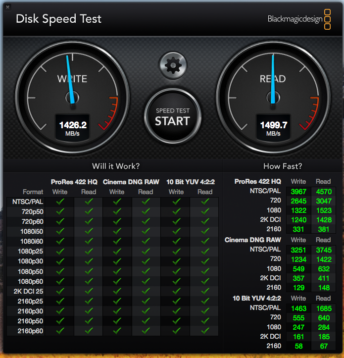

What adapter and slot are you using? I'm getting 1100-1300 Read and 700-800 Write speeds on mine so I know it should be a bit faster...256GB 970 EVO...so just wondering if I need to tweak or move something.

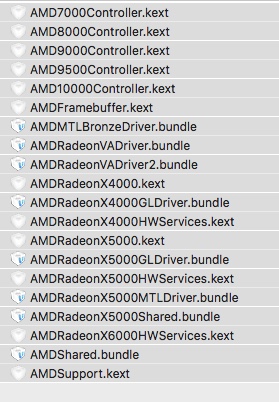

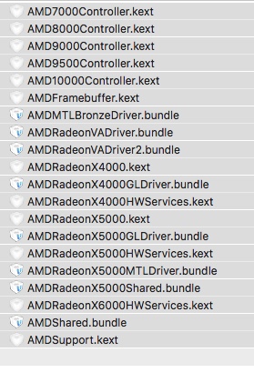

The AMD drivers in Mojave are version 2.0.36 Aug 23, 2018. The AMD drivers in HS are version 1.68.20 Jun 29, 2018. But I don't know which drivers are necessary for the RX-560 nor whether the Mojave drivers would work in HS. I'm too chicken to try without making a clone of HS first, which I don't have time for now. Anyone know which drivers and if safe to move to HS?
Before trying this, go to the macOS 10.14 Mojave on Unsupported Macs Thread and ask there if it's even feasible. I know that Mojave drivers are a lot different from 10.13.6 ones with totally different dependencies.
