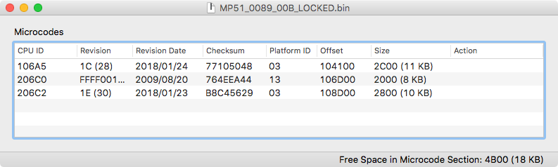

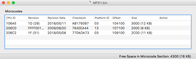

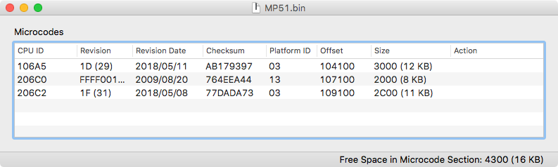

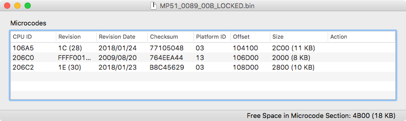

Is the 2kb difference enough to prohibit NVMe injection? I wouldn't think so personally, what do you think?
No, that's microcode space, not driver space.
You have to remove one of the microcodes, usually 206C0, if you need to add 106A4 microcode for some i7 and ES processors.

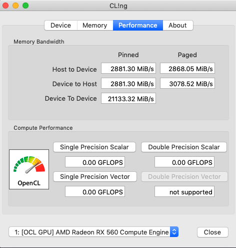

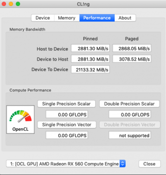

hey, these are my cl!ing results on 5gt/s on the rx560, is this right? i thought it should display ~5000 on paged and pinned?

i dont want to have this covered up in the depths of the forum becasue i think its important, my paged and pinned speeds should be at ~5000 since im at 5.0gt/s correct? or am I wrong?
