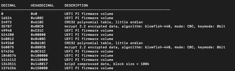

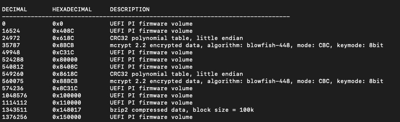

Very Very insightful thread. I was able to take my Mac Pro 4,1->5,1 and update to Mojave with the 140.0.0.0.0 BootRom. NVME boot is successful. Very Cool. I have to give tsialex 2 thumbs up. I've used Binwalk to get information about my ROM. The only concern I have is if in the future I decide to ever install Win10, What steps would I need to take to make sure my Bootrom doesn't get corrupted?
Use the steps in this tutorial. Works perfectly.

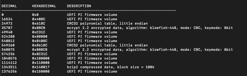

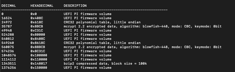

Thank you, I've managed to follow the instructions. Removed all Drives but the Windows one. Installed Windows 10 via DVD, it Boots, and works properly a few drivers issues, but that can be easily fixed. I booted back to macOS Mojave, Did another BootRom Dump and ran Binwalk. Looking Good.
Thanks again for everyone who have contributed to this thread. Awesome People here =)

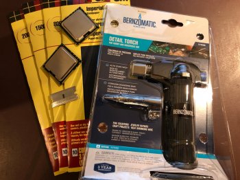

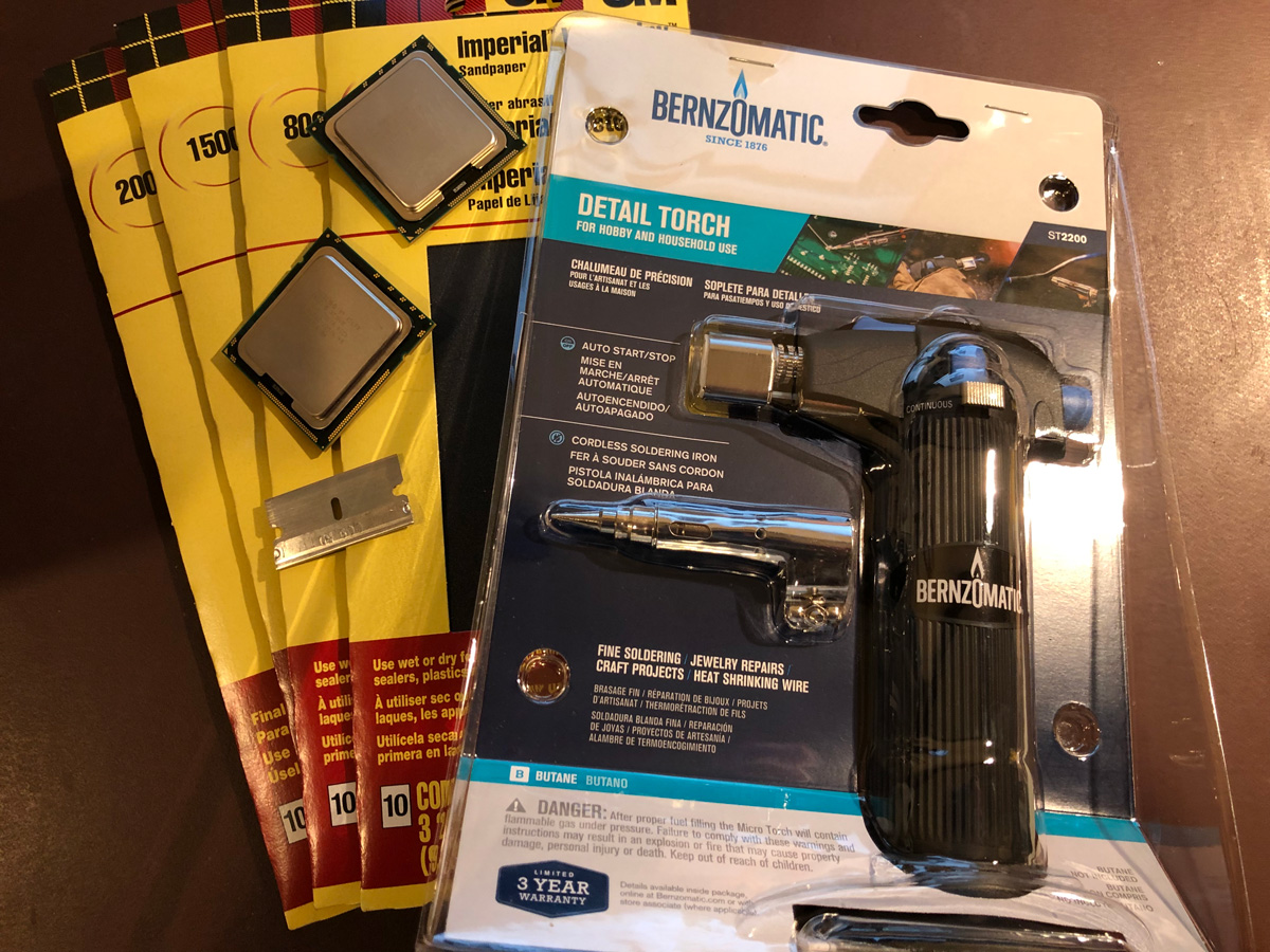

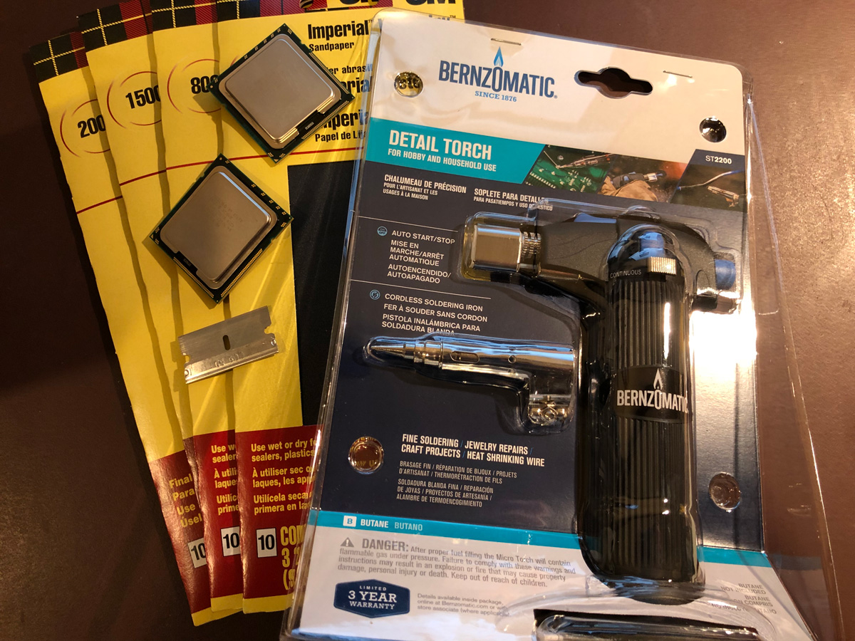

with a blowtorch it's almost impossible to control the heat. I googled at which temperature solder starts to melt. using an infrared temperature gun I measured the temp of my stove top (hotplate) and placed the CPU upside down onto it. before delidding I also inserted razorblades between the IHS and CPU carrier.
I used a butane lighter. After cutting the gasket, I used also used four straight razors to wedge between the IHS and CPU, then I suspended the whole contraption between two books. After like 5 seconds the CPU just falls to the table. I then cut the rest of the solder before polishing the CPU to a mirror finish.
EDIT: I found the pic I took of the stuff I bought to do the job. I guess it's not a "lighter" but more of a torch, but it's handheld and very easy to ensure that the heat was concentrated on the die.
