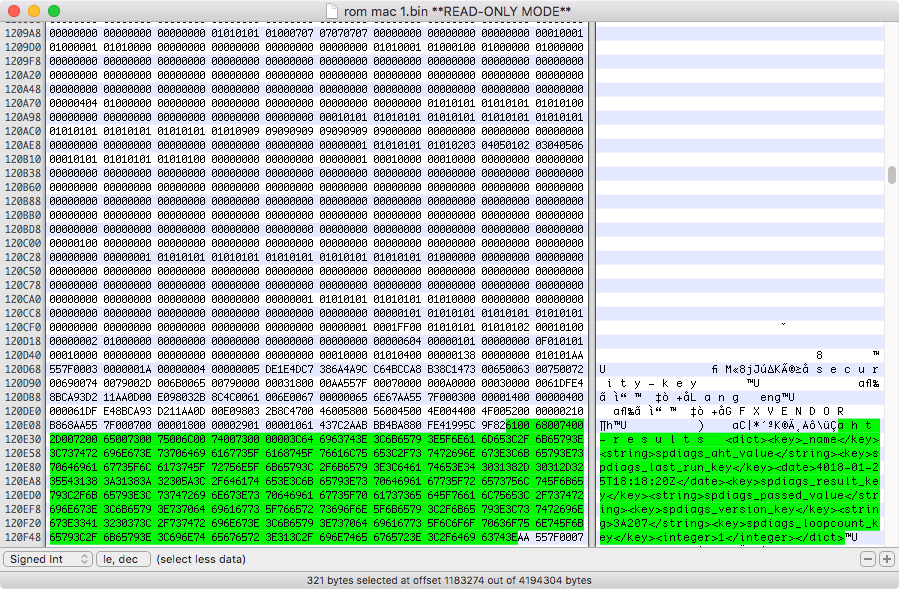

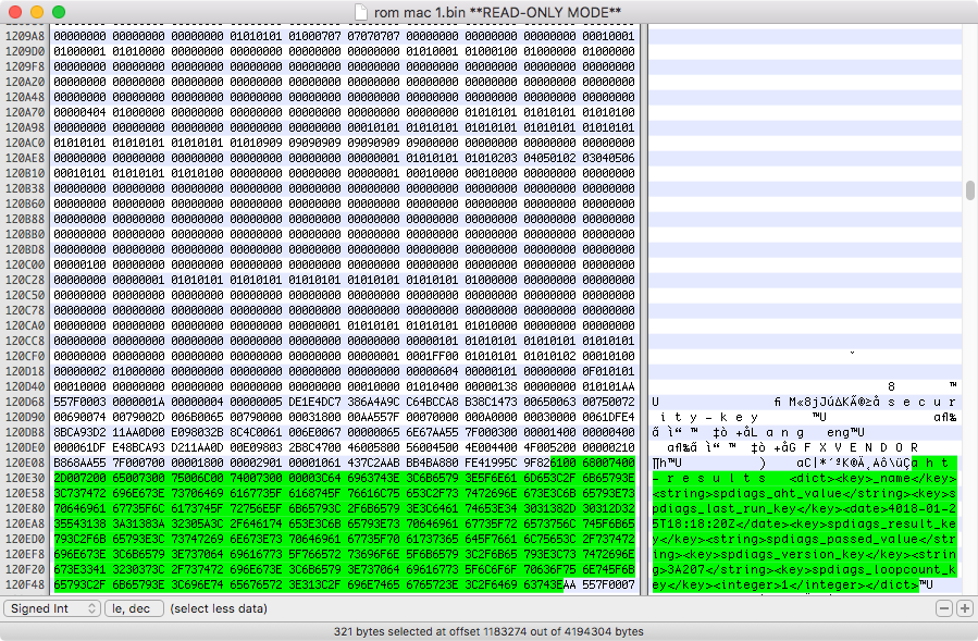

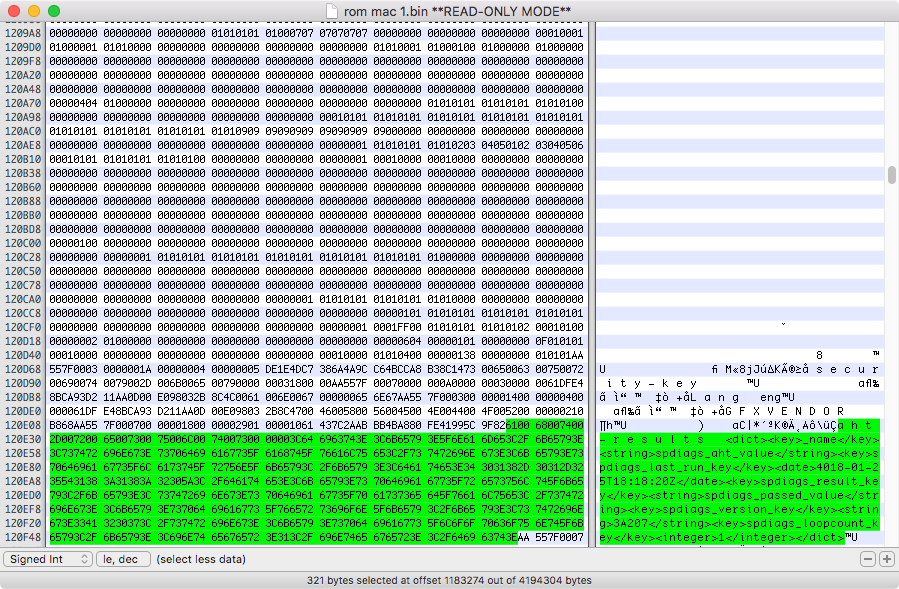

Just to document, when you run AHT, it saves the results into the first stream of the NVRAM volume, usually like this:
Code:
aht-results
<dict>
<key>_name</key>
<string>spdiags_aht_value</string>
<key>spdiags_last_run_key</key>
<date>4018-01-25T18:18:20Z</date>
<key>spdiags_result_key</key>
<string>spdiags_passed_value</string>
<key>spdiags_version_key</key>
<string>3A207</string>
<key>spdiags_loopcount_key</key>
<integer>1</integer>
</dict>
Code:
aht-results
<dict>
<key>_name</key>
</dict>
you can see the result of your AHT/ASD in system profiler under diagnostics too :)
