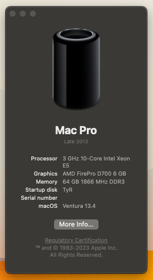

With OpenCore-Patcher 0.6.5, macOS Ventura 13.4 installed without an issue on my 2013 Mac Pro:
I want to thank all of you who work hard to keep OCLP current.
I just successfully upgraded my Mac Pro '13 to Ventura 13.4.
I have a relatively complex installation with many attached TB devices, including a Sonnet PCIe expansion box with Network and Storage cards. I have lots of software and use several Cloud and iCloud solutions. I also use Parallels to run a Windows 10 installation, which is installed on my BootCamp partition, and it all seems to work...

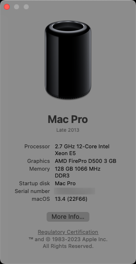

Using OpenCore Legacy Patcher v0.6.5, I followed the guide and installed the latest version of Ventura 13.4.
I don't know why I have problems with external drives. Either the system throws them away without warning or I have slow transfers. Do you have any ideas? I'm already tired of 45MB/s on NVME and similar highlights. It started with Monterey and Ventura didn't help. Hardware test says everything works beautifully. Ventura works like a dream but these drives....

One of the enclosures I'm testing is an ASUS TUF Gaming A1-USB-C 3.2 Gen 2x1 SSD and I'm using a USB-C to USB 3.1 cable with it, while the other is a UGREEN M.2 NVMe SSD Enclosure. Enty comes with a MICRO USB 3.1 cable and they are the original cables. An additional attraction is that if the external drive is plugged in the system charges very reluctantly. If I remove it the charging is instantaneous. As for the configuration I post it in the screenshot. I am now changing the RAM to 128GB. And that will be the only difference. Previous system was Monterey 12.6.6.

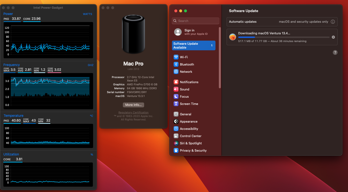

Power management with Ventura seems to be finally solved with today's OCLP 0.6.6 release:
