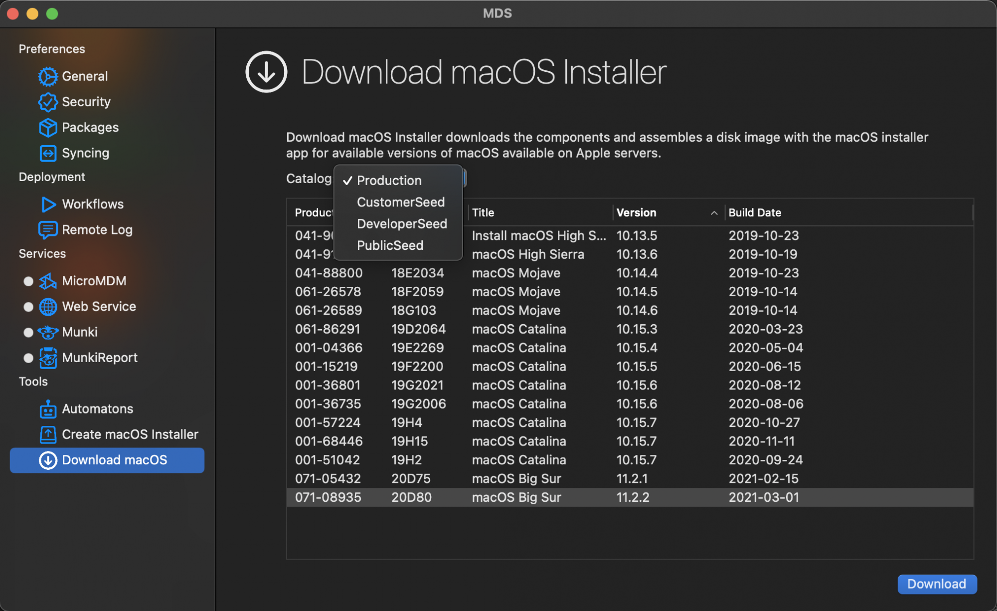

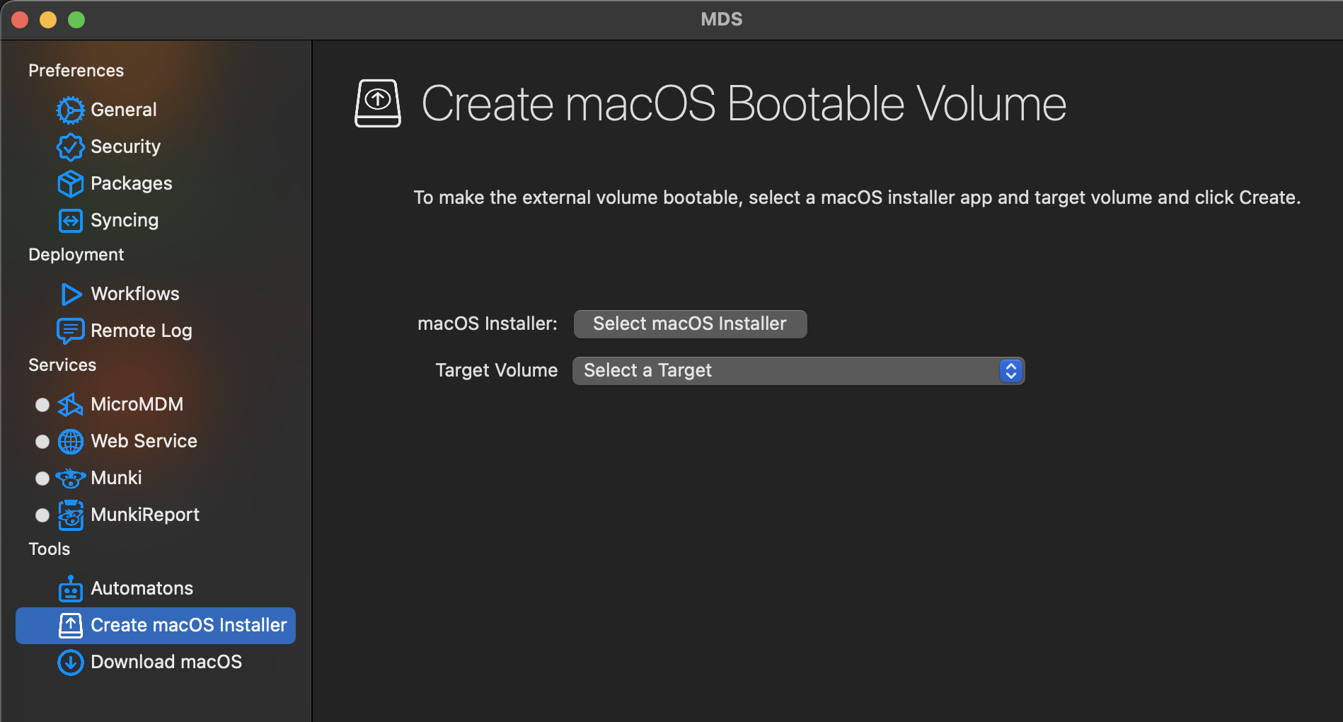

An alternative to step 2, avoiding use of the Terminal is MDS by Two Canoes.
It can download full installers from any of the Apple Catalogs and uses createinstallmedia to make a bootable flash drive with a user friendly UI.
It works and is free.

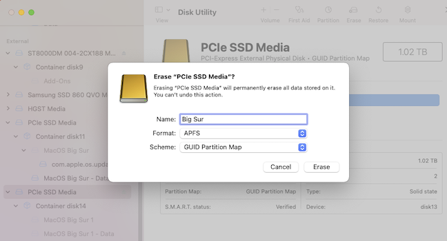

The first thing that you’ll need to do is to format your hard drive. With Big Sur this is a little bit trickier than with other versions of macOS. Please follow this step exactly as outlined because if you don’t complete this step correctly, then the entire procedure will fail. Of the 3 steps, this is one of the most important!
First things first, you’ll need to do your hard drive formatting from the M1, and not from an intel Mac. You will not need to go into Recovery to format (that works best for internal disks, not external). Since you will be doing this procedure from the desktop, it is more straight forward to simply perform this step from Disk Utility.
Go to Applications > Utilities folder > Disk Utility. Click the “View” button at the top of Disk Utilities and then choose “Show All Devices”. Find the Volume that you wish to format and click on the top level of it, then click on Erase:
A new window will popup:
For “Name” type in what you wish to name your hard drive.
For “Format” you’ll need to choose “APFS”.
For “Scheme” you’ll need to choose “GUID Partition Map” and then click on the Erase button.

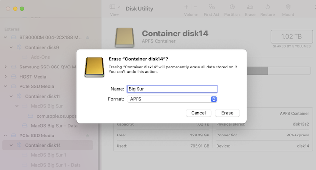

Your hard drive is now formatted for your M1, however I always like to take an extra step just to make sure that the container is properly formatted. You can skip this step if you wish.
Click on the next level right below the top level.
It will say “Container” with the number of your Volume. With the Container level highlighted, click on the Erase button on the top menu. A popup will appear:
For “Format” choose “APFS” and then click on the Erase button.
Step one is now completed. You can close Disk Utility. You can now move onto step two.

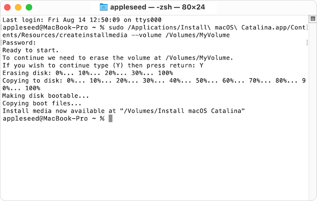

With the MyVolume USB flash drive plugged into your M1, open Terminal, which is in the Utilities folder of your Applications folder.
Copy and paste in the following command into Terminal;
Code:
sudo /Applications/Install\ macOS\ Big\ Sur.app/Contents/Resources/createinstallmedia --volume /Volumes/MyVolume
After pasting in the command press Return. When prompted, type in your administrator password and press the Return key again. You probably won’t see your password as you type it in. This is normal and is a security feature.
When prompted, type Y to confirm that you want to erase the volume, then press Return. Terminal will show you the progress as the USB flash drive is being erased.
After the USB flash drive has been erased, you will see an alert that Terminal would like to access files on a removable volume. Click OK to allow the copy process to proceed.
When Terminal says “Install media now available at…” the process has completed and the installer will be renamed “Install macOS Big Sur”.
Step two has now been completed, and you can now close down Terminal.

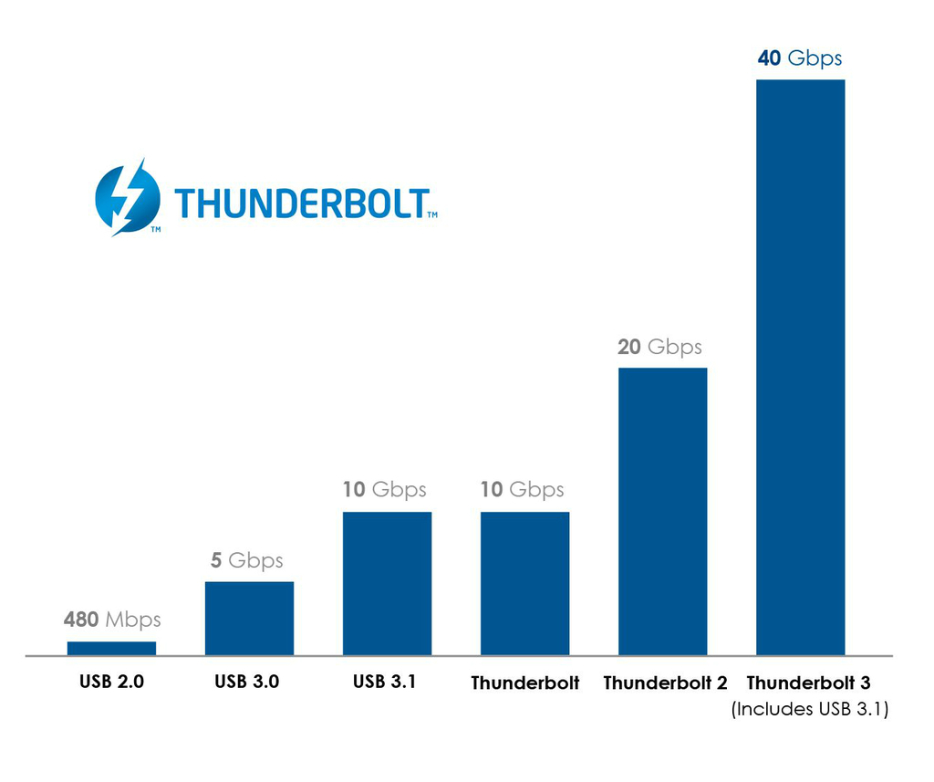

Just remember that $200 external 2TB SSD is a whole lot slower than the internal SSD.
To approach the internal SSD speeds you need to move to a thunderbolt3 NVMe external, and those cost a bunch more.
Example: Amazon.com: SAMSUNG X5 Portable SSD 2TB - Up to 2800MB/s -Thunderbolt 3 NVMe External Solid State Drive, Gray/Red (MU-PB2T0B/AM): Computers & Accessories
What makes sense though depends on the user's specific needs / use case. I'd not want to depend on an external with a portable such as MBA or MBP, so the extra cost of having the internal storage is worth it to me. (I also don't need 2TB so the price delta's not so large)

has anyone actually tried it using Samsung T7 drive or is this going to be too slow since it isn't TB3?
While the T7 should work, it will be much harder to get it to work, plus it will be much, much slower.

so TB3 is from a HW standpoint much easier to setup this way for booting, do I understand it correctly? Then TB3 enclosure and a fitting M.2 SSD should do it...?
