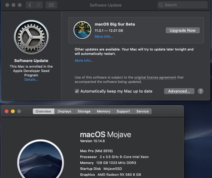

As @cdf mentioned Mojave-->Catalina still needs VMM. After unenrolling from the beta seed:
