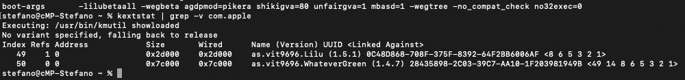

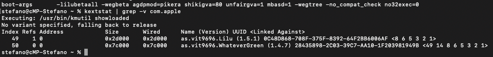

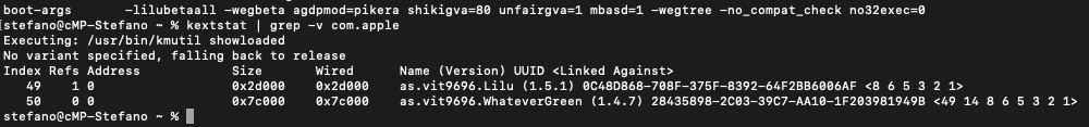

Please enter the following command in Terminal, what's the return?
nvram boot-args
kextstat | grep -v com.apple
Here's the results. Thank u
