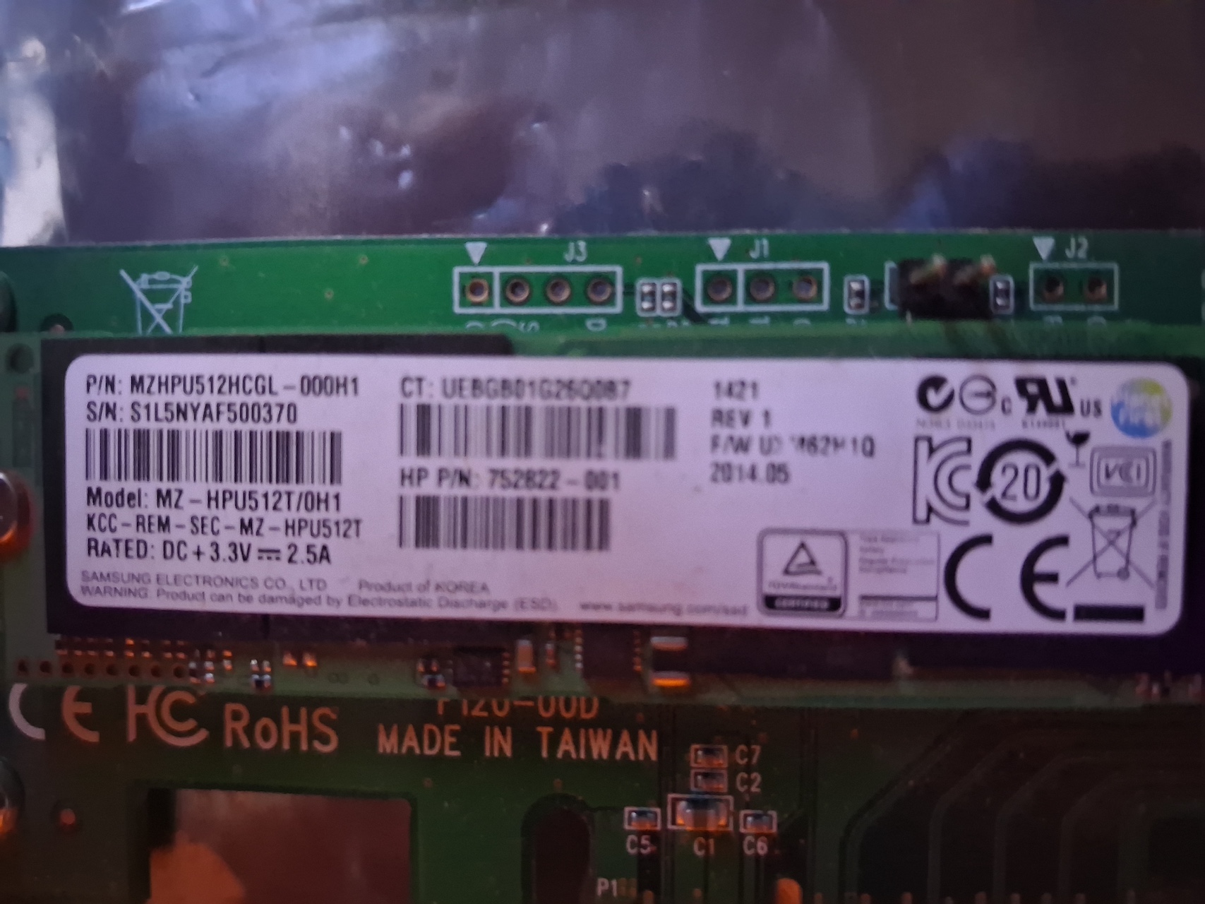

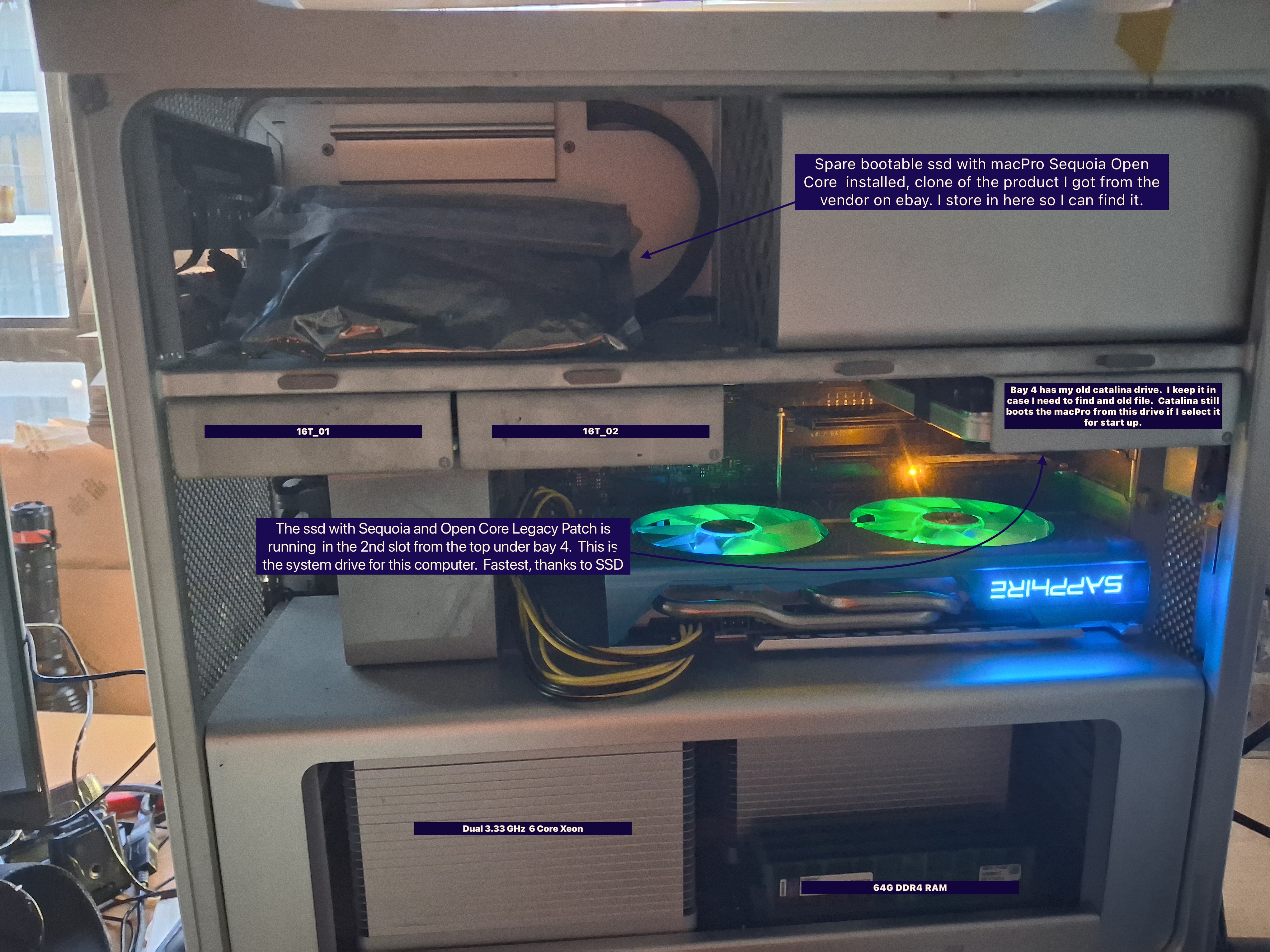

Hi Forum,
I am in a bit of a pickle.
I had a mid 2010 that just went south after many moons of great service. I was running OCLP on an NVME with Sequoia installed. I had a spare Mid 2012 handy so I took the NVME's and installed them. I have two NVME cards in the machine. The 1st one has The sequoia install and the other is a new blank. The 2nd has my old Mojave install that I was using before the joys of OCLP. So I popped the Radeon RX 580/8gb and the two NVME blades. Rebooted the mid 2012 and its booted fine into Mojave. I downloaded OCLP 2.4.1 and installed it on Mojave and selected Mojave for the EFI when Prompted. I also made two installers for sonoma and sequoia on separate 64MB USB keys. I disconnected all of my Sled Drives and rebooted as per instruction and help the option key. No Reboot just a whitish screen that goes nowhere and when I press the power key it powers off. I have tried a myriad of combos to see if I can get it working. THe install process was a breeze so I at a loss at to whats happening.
I am wondering if it is the blades??. I have a USB 3.0 card in one of the PCI's as well. Is it the keyboard?
