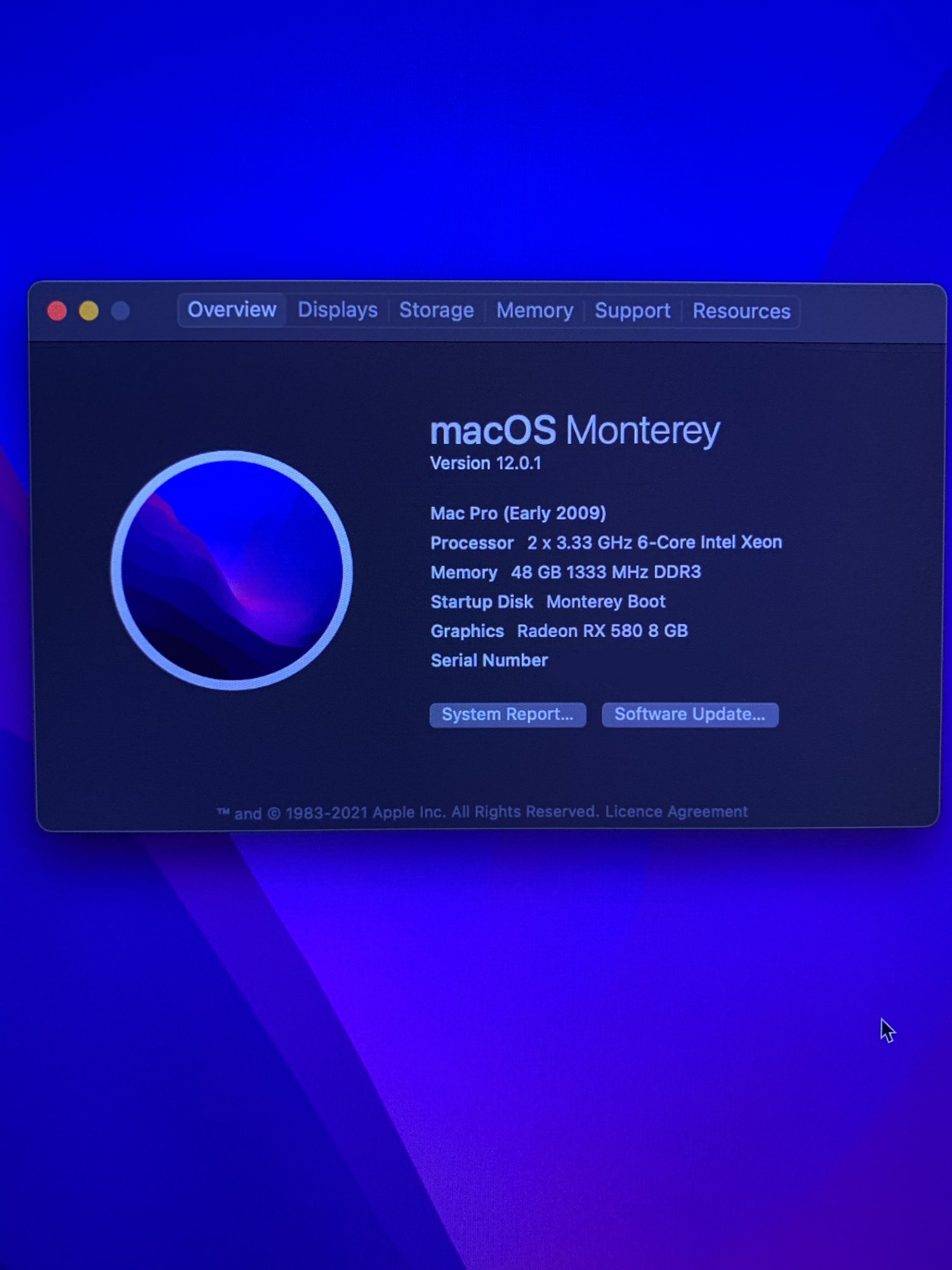

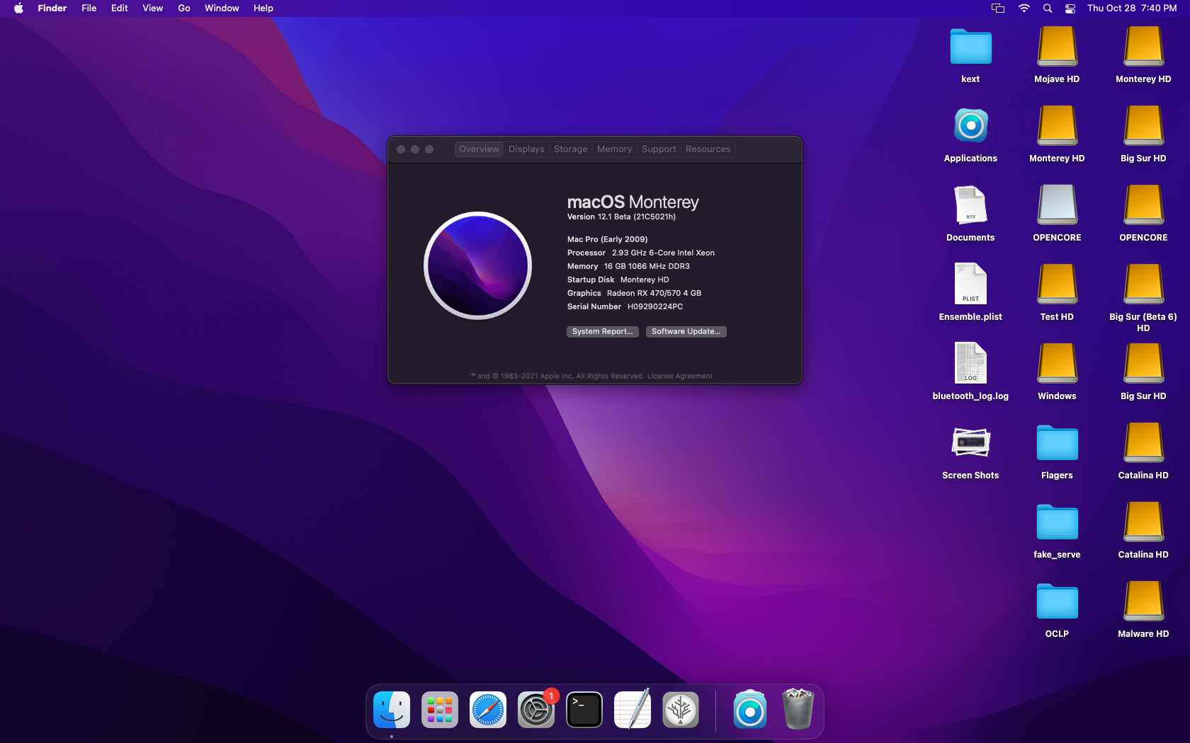

@Syncretic's done their magic again, was able to boot a MacPro4,1 to 12.1 Beta 1!View attachment 1882706
@Syncretic rules, no doubt!
I'm curious, how did you made a Westmere hex-core run on a MacPro4,1? Did you replaced all the CPU support EFI modules and added the necessary microcodes inside the MP4,1 EFI or it's just a cross-flashed early-2009 to MP5,1 with Model Identifier = MacPro5,1?

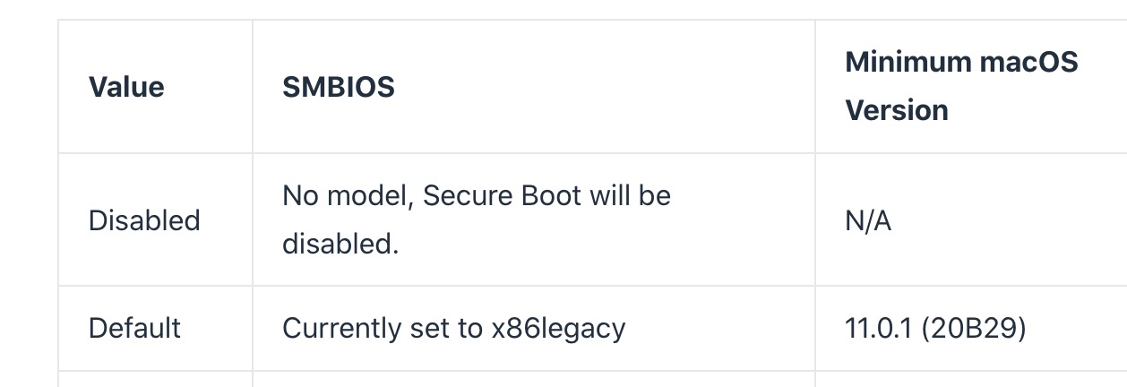

I've tested SecureBootModel set to Default with Big Sur and Monterey. Since 0.7.4, the Default option takes the model matching the board ID. I haven't tested this in Catalina.
ok. I just read up about it, I'm amazed that when I installed OC 0.7.4 with this parameter set to default, that Catalina continued to boot, considering the docs on Dortania say the following:
But it seems like changing it to "disabled" should be fine though arguably less secure. I will give that a try. If so then I can use one single OC config for both Catalina and Monterey.
My recommendation for installing Monterey (SecureBootModel and updated firmware features) was based on the release candidates, which had VMM left out. The flag will likely work with future updates (without SecureBootModel and firmware features), so that might be your answer.
The documentation is outdated. As of 0.7.4, Default takes the model matching the board ID, so it makes sense that Catalina can still boot because iMacPro1,1 (and MacPro7,1) are supported in Catalina. Thanks for confirming.
But if Catalina can still boot with Default, you could just use that.
