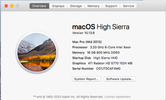

Hi I am not a programmer, I has have Catalina installed on an SSD mid 2012 Mac Pro and other then the graphics card issue it seems to be working fine. I did use dosdude1 Catalina patcher successfully, I want to upgrade to Big Sur.
I also have High Sierra installed natively on an HDD, so that I can switch between OS's
My question is that if I follow the Guide for Open Core, what is my next step to get to Big Sur?

Lots of people are happy to help. Let's start with some questions.
It appears from your screen shot that you have the original graphics card installed. Is that correct? If so you would need a metal compatible graphics card.
Second question - what boot rom are you running? The most recent is 144.0.0.0.0.
Thanks I do have a new card coming in which if I have done my research correctly it should be compatible with the latest OS, the new card will be AMD Radeon Sapphire HD 7950 3GB.
My boot rom is MP51.0089.B00, and so is there a guide to get the most recent boot rom installed?

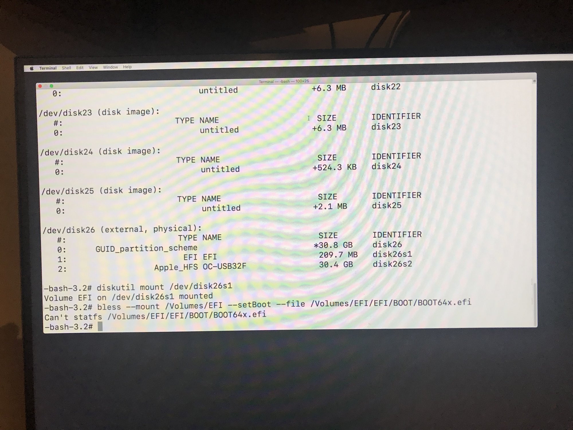

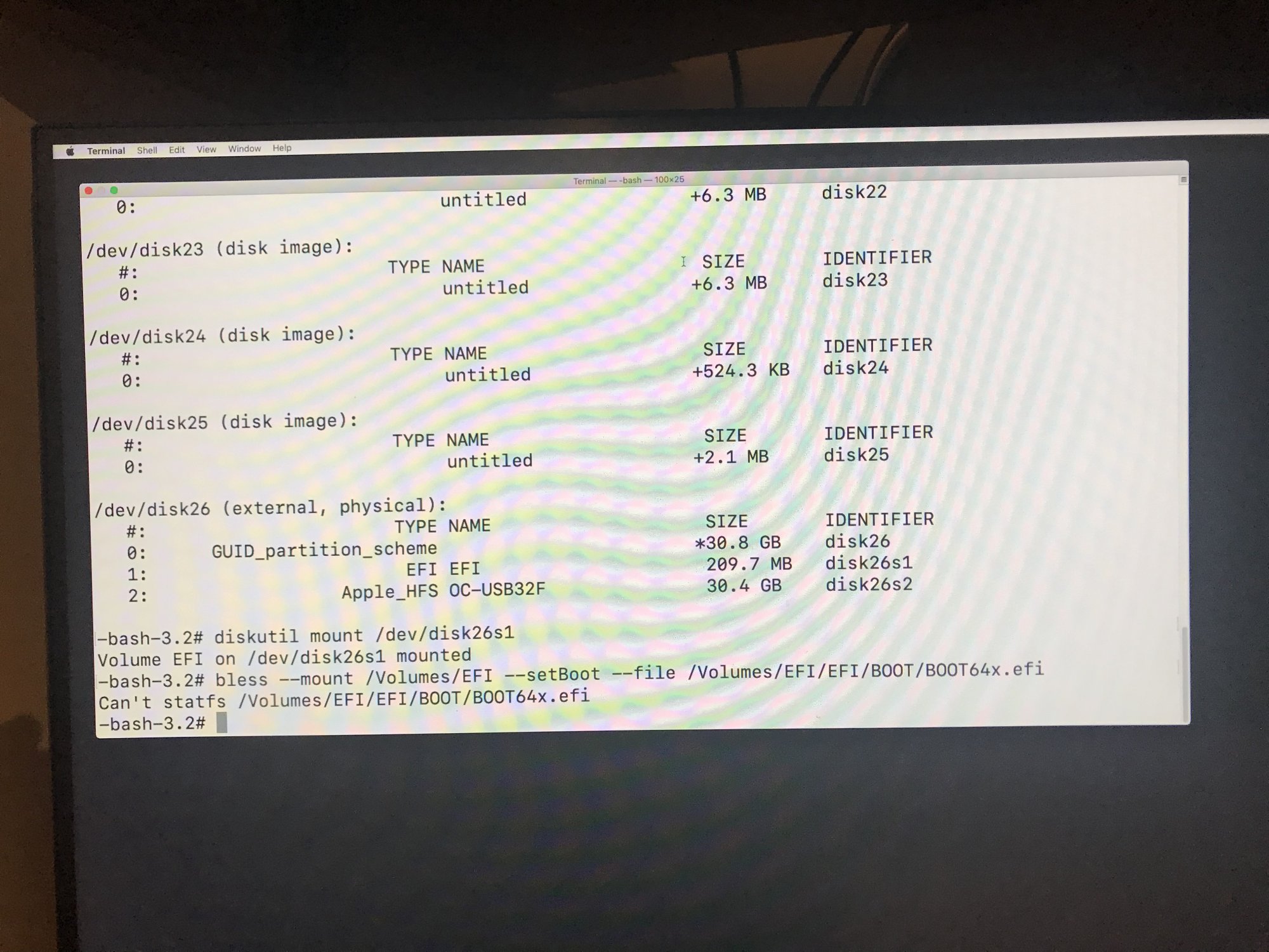

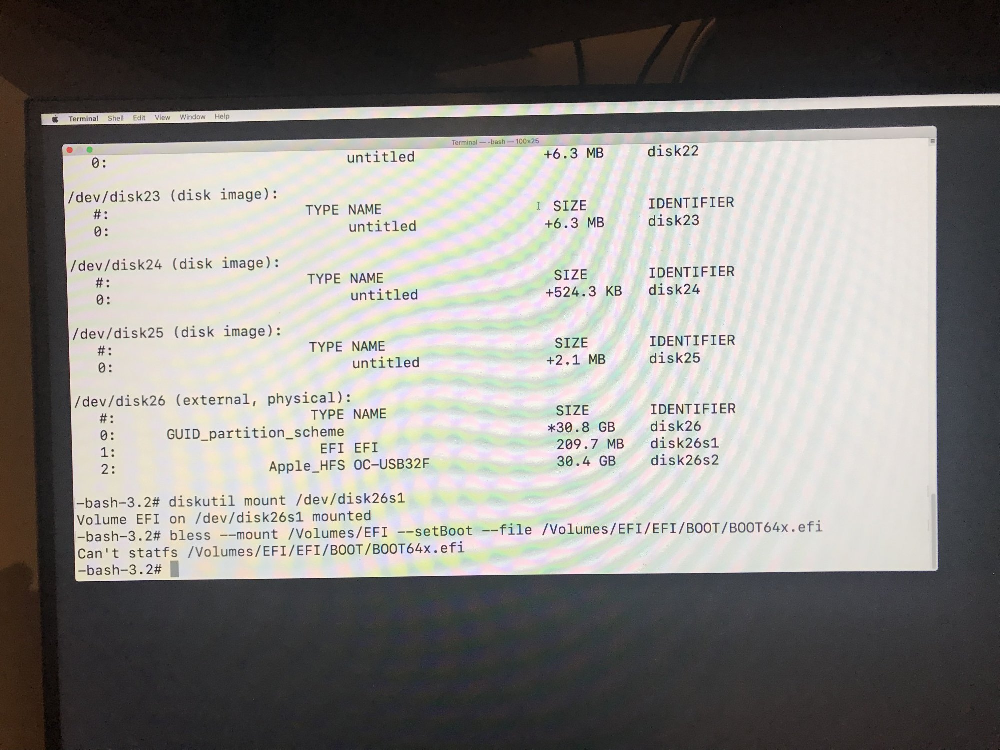

Sometimes I see when trying to bless OC USB Can’t statfs, what does it mean? What have I done wrong?
