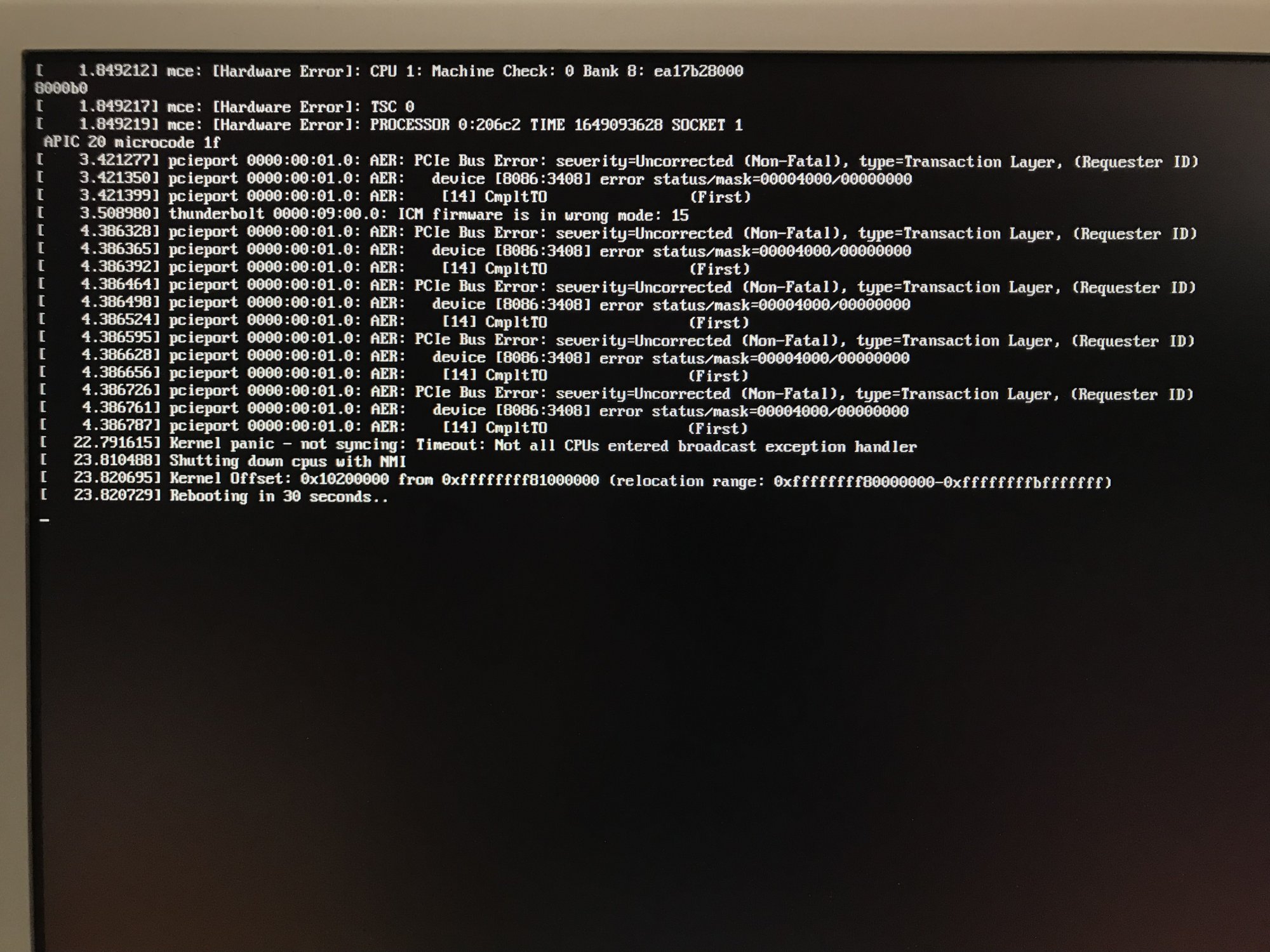

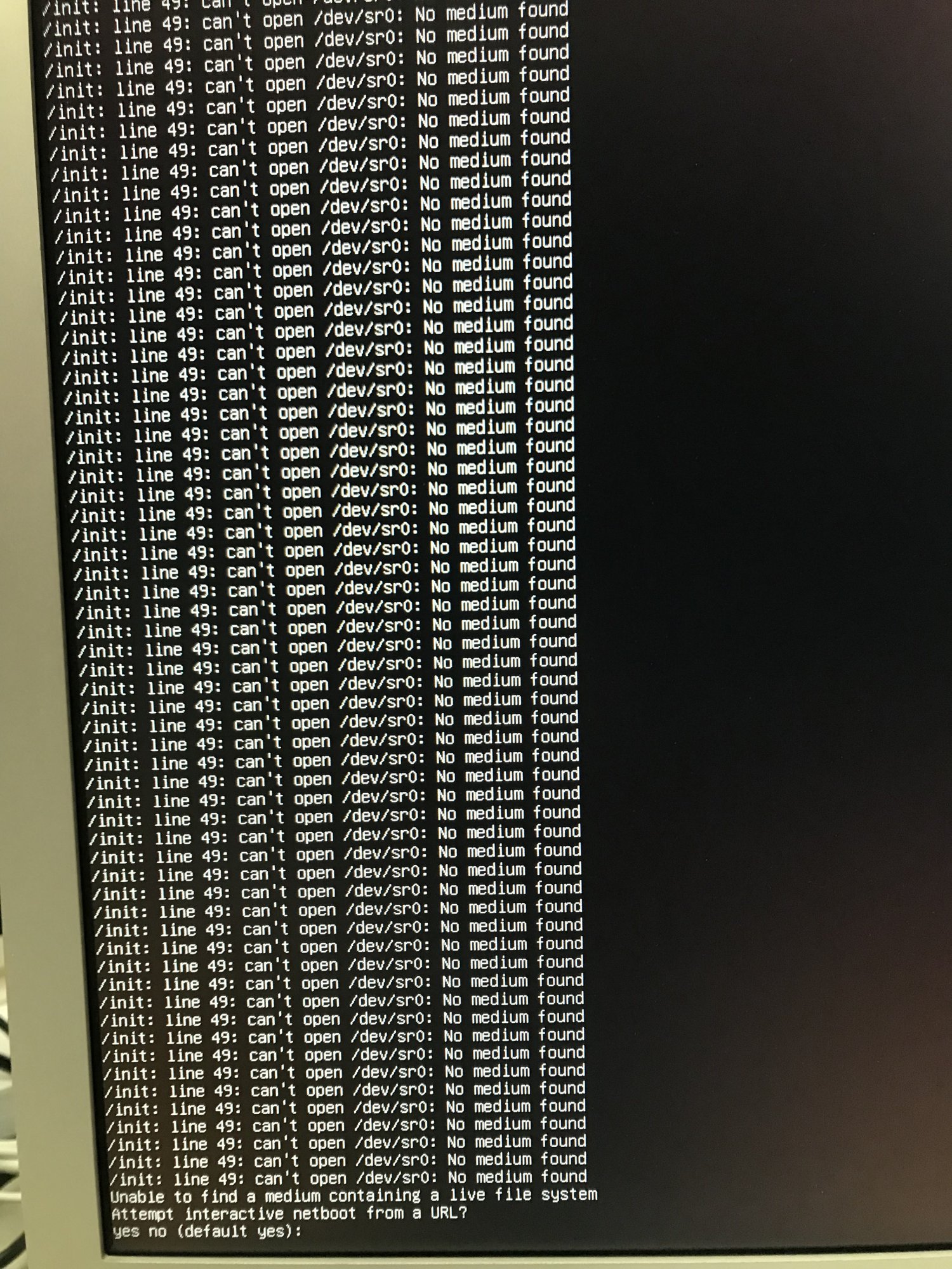

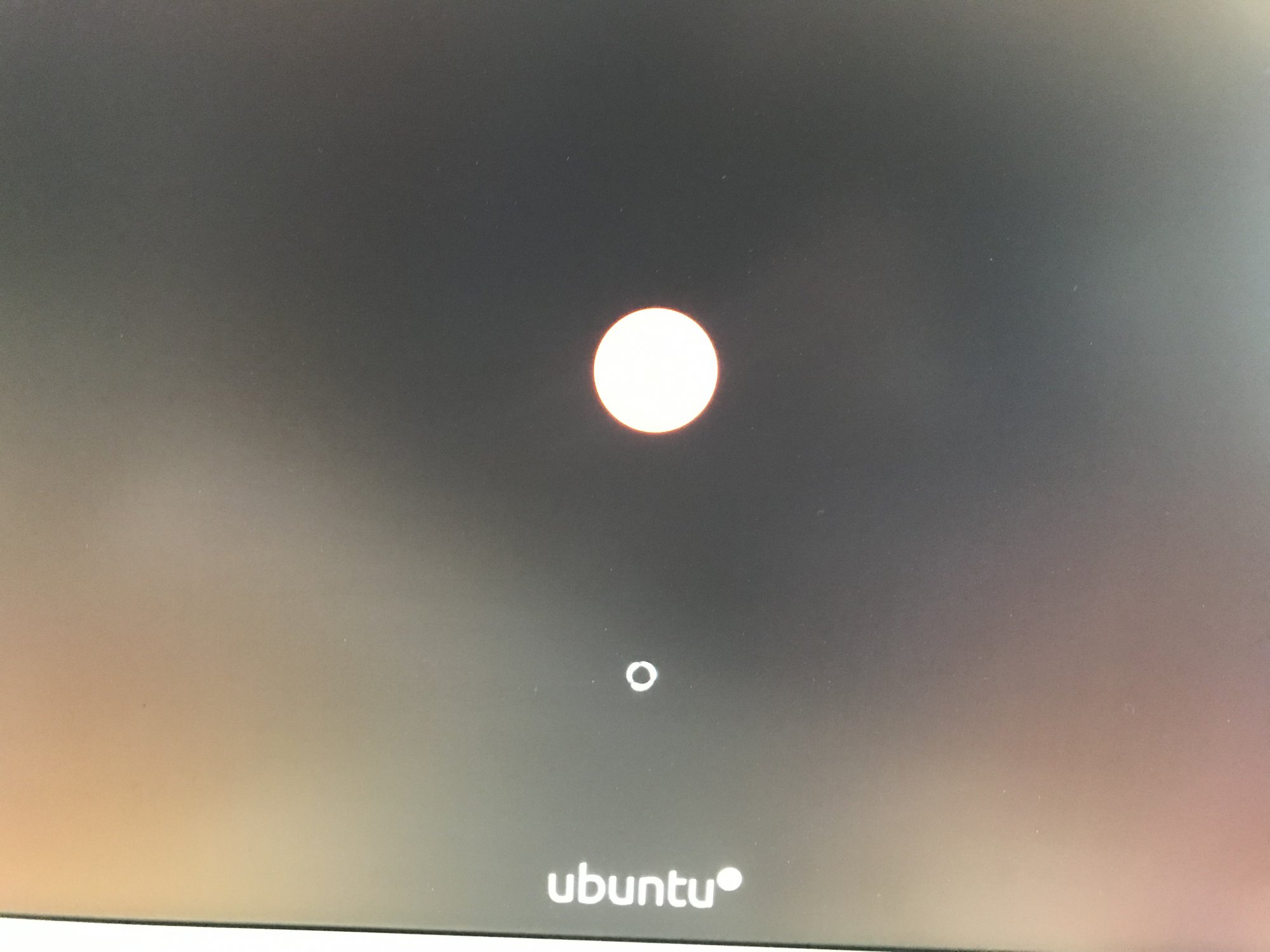

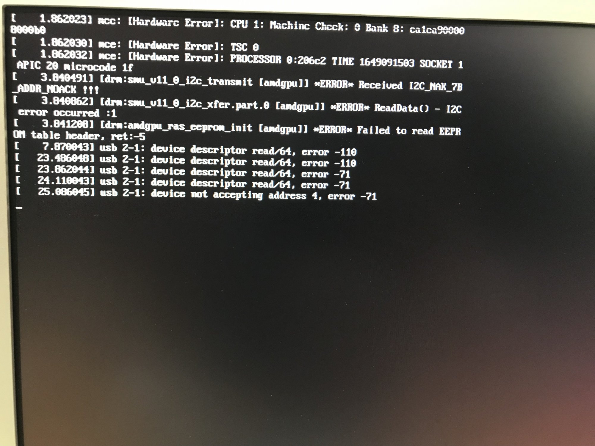

Hi everyone, I have a dual CPU cMP5,1 with Martin's OC 0.7.9 installed, currently dual booting Monterey 12.2.1 + W10 and no problems so far since starting using it with OC 0.7.6.
So I have been trying to use and install some Linux distros for testing for myself and I am unable to install due to errors during live booting from USB drive. I usually am competent enough and can fix the issues when it comes to MacOS or Windows myself with all the info here and elsewhere, but since Linux is quite new to me, I am lost as to where to start to solve this.
Any input would be greatly appreciated!
Some info:
I have updated my OC EFI with the required OpenLinuxBoot.efi and ext4_x64.efi in drivers folder and enabled in config.plist in drivers section. Also, I have checked RequestBootVarRouting and LauncherOption are enabled.
I have tried Ubuntu, Mint and Manjaro and I haven't been able to start or install neither of them.
This is the screens in order I get when trying to live boot Ubuntu:
1.
2.
3.
This is the screen I get when trying to live boot Mint:
