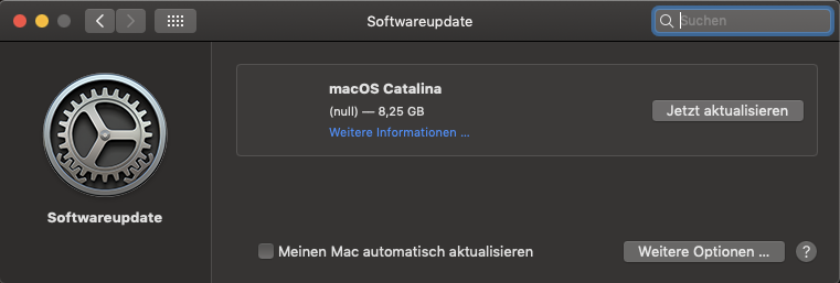

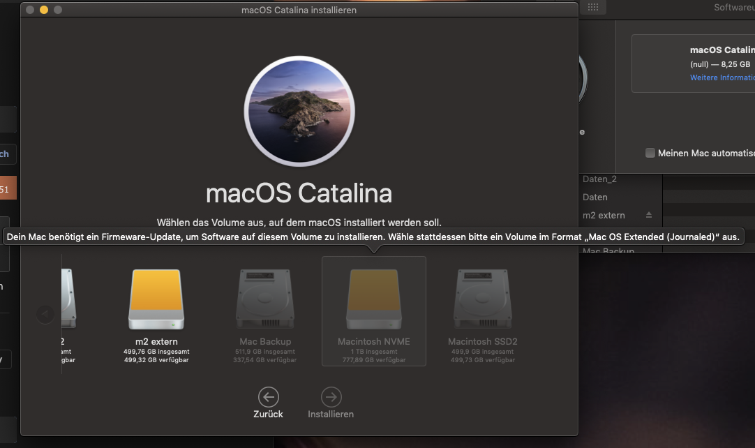

Hello guys, I´m on 10.14.6, everything works great so far!
When I try to download Mac OS Catalina using SoftwareUpdate I got the failure u see in Picture 1, I cannot Download the installer.
When I download the installer with the Dosdude tool I get another error...
I´m on Firmware 144.0.0.0.0
Can anybody help me to find a solution?

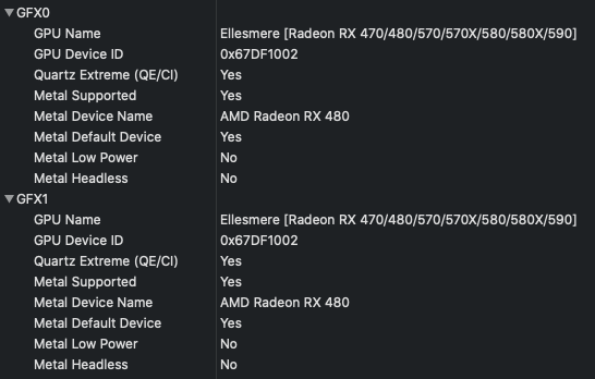

How about multiple videocards? No wegtree? For external-->internal drives there is still need for something like Innie, right?How about DRM decoding?
I believe that the device properties for one GPU provides the settings for all of them. These settings take care of device renaming (wegtree) as well as Shiki for DRM. For internal drives, I will add a section for adding the built-in property; alternatively, Innie can be used.

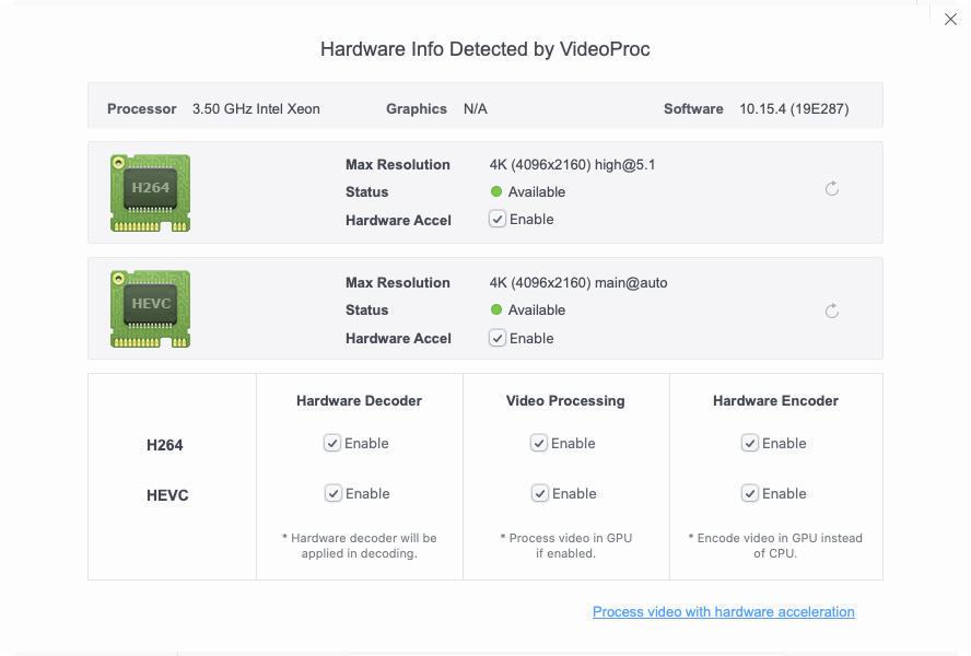

Big update: The guide now includes a how-to for hardware acceleration. No boot arguments needed 😉

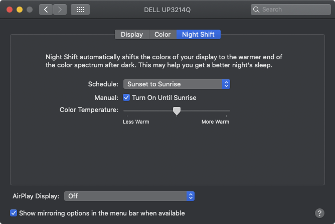

Working great, thank you! HWAccel and Night Shift, damn name typo. 😀

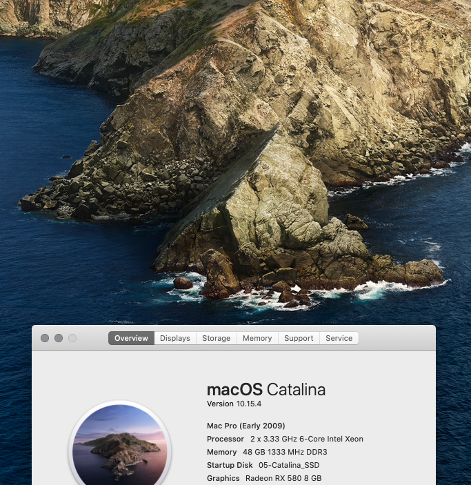

You forget to turn off SMBIOS spoofing
As far as I can see, that covered everything we did in the boot argument, but with specific device path. Still have agdpmod=pikera, shikigva=80, and -wegtree. Just in another format. So, all functions should work properly.
I am thinking, for multiple graphic cards setup, this should be a better approach, because we can specify which GPU to handle HWAccel.
Boot argument of course is easier, because WEG will automatically do all required patch for us, but we also have no control about which graphic card to do HWAccel.
Actually, the device properties for one GPU provides the settings for all of them. Using device properties is a good practice that follows the OpenCore philosophy of reserving boot arguments for temporary configurations.
Reactions: w1z
I mean multiple different GPU. e.g. A RX580 + Radeon VII
Should that make any difference?

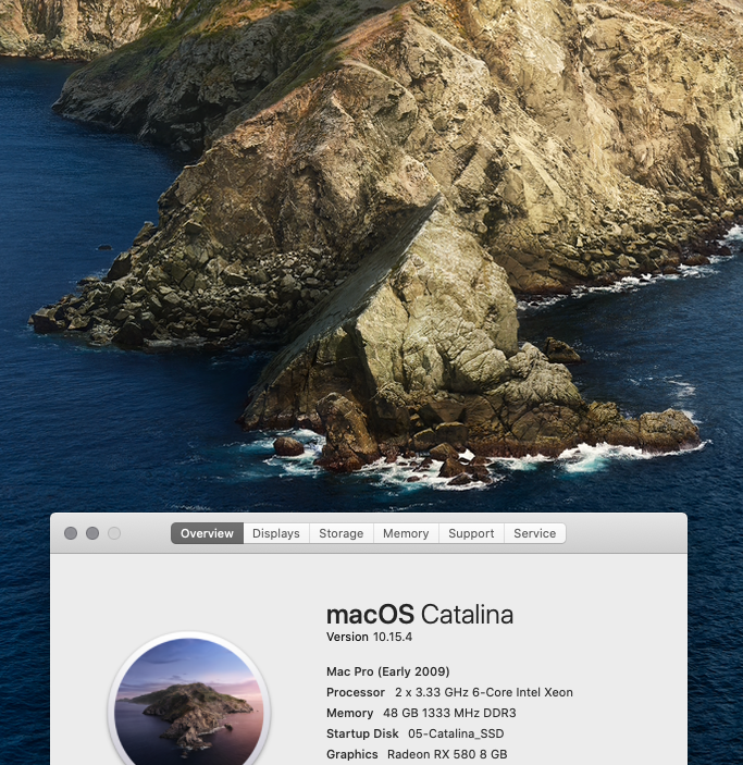

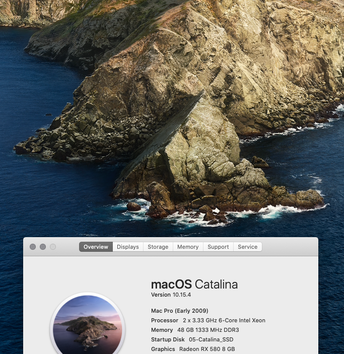

Better late than never, I finally got my cMP 2009 5,1 booting Catalina. I still have a lot of work to do, and reading as well. I wanted to thank OP, cdf and all the other contributors to this thread. Having a disk picker and Catalina are not the be all end all, as I'm rooted to the past at 72. I really like the concept, and how well it worked, especially to overcome the corporate overseer. Now to the acceleration...

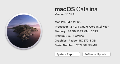

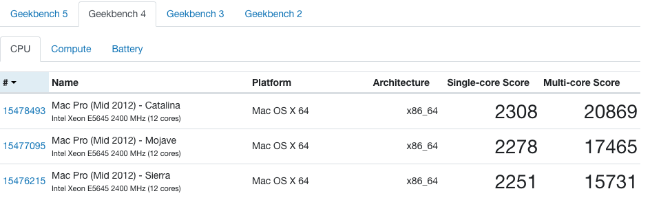

did someone test the CPU after upgrading to Catalina using OpenCore ?!
I just did it... There is no enhancement on my "default" Mac Pro 2012... I bought it last week, updated to Mojave yesterday morning and then used Opencore in the evening... so here it goes:
I have my loading screen, GPU is native*(used a GT120 for upgrading to Mojave though), and I use the 1,2,3,5,6,7 slots to add 8Gbs of RAM each... so it's 20% faster in results.. you know that deal, right... And it updated without a flaw... added the details of the first post for acceleration etc...
