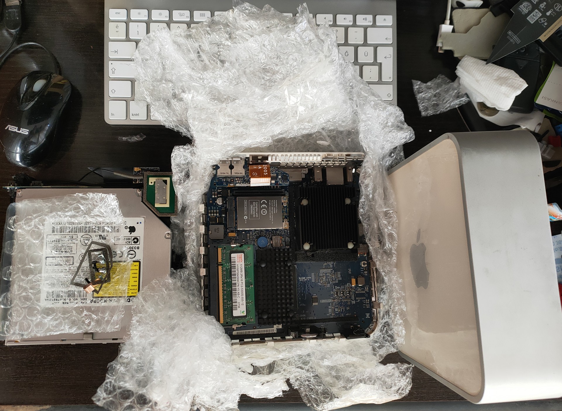

I've got a question. First the intro:
Recently I've bought a defective Mac mini mid-2007 2.0GHz (listed as "parts only" and the PSU, the harddisk not included) for $12 shipping included. (I usually buy such cheap & defective Mac minis for fun & profit) When I got it, its parts were dismantled like this:

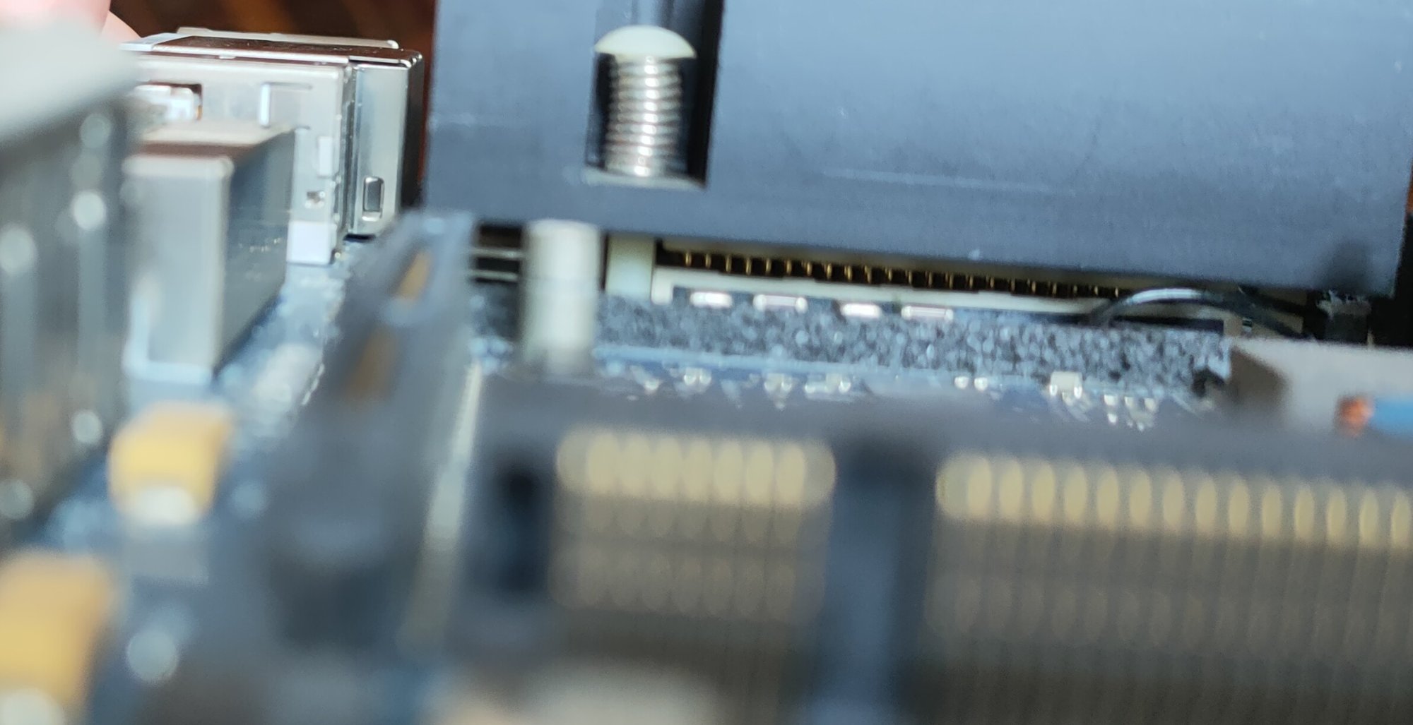

I've installed a Leopard 10.5.8 harddisk and 2GB DDR2 RAM and powered it on. It powered on but no chime sound came. I did a hard shutdown and it did hard shutdown so the logic board must have been fine. I assumed it must have been either a bad GPU or CPU preventing the chime sound. Bad GPU is a quite common occurance but abad CPU? You don't hear bad CPU often. Nonetheless, I decided to replace the Intel T7200 CPU with the T2300 which had been lying around in my drawer for a decade! Before removing the heat sink, I took a look at it from its side.
It's quite hard to photograph that section using a cellphone so it's a bit blurry. Whops! The pins of the CPU are seen from the side. The CPU seemed not fitted in the socket, it seemed angled to the right.
I removed the heat sink and I saw the CPU locking screw was close but not at the lock position. I rotated the lock screw to relieve the CPU from its angled position, put it back right into socket and rotated the lock screw to its lock position. Powered the Mac mini on again and wow! the chime sound came out and it booted without any issues. So the culprit was definitely that misfitted CPU.
The question is: How could that CPU have come to that angled/miplaced position at the first place? Did anybody ever see such misplaced CPU before?
