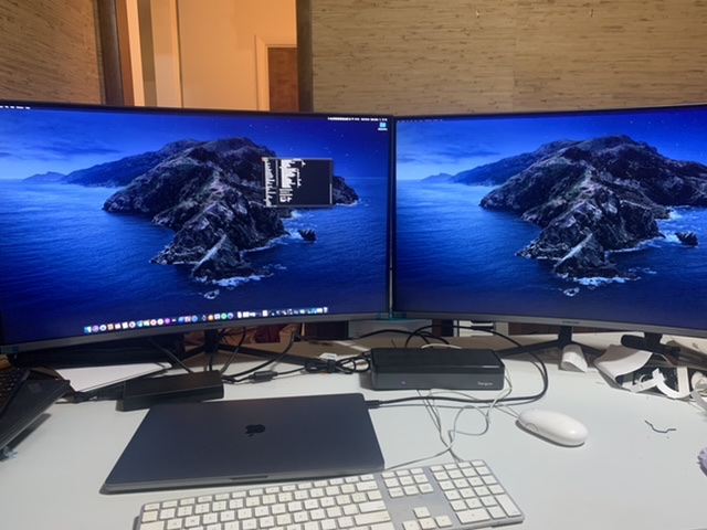

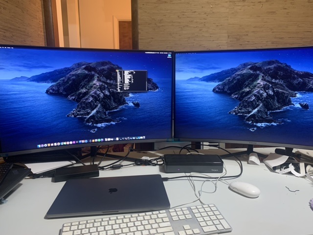

Sorry for the delay. Yes, it worked in clamshell mode with two 4k displays.
Oh man, great to hear. Apologies if you answered this already, but what GPU do you have? I think that's part of the sleep problem a lot of folks are having. (I can't clamshell with 2 4K screens without a dock, just straight into the MBP). It sounds like it might be a driver issue. I'd be willing to give this Targus dock a shot though.
No, I didn't mention GPU earlier. Mine has the 5500M 8GB. I'll do another test tonight and post a pic or something showing the screens and laptop clamshelled.
