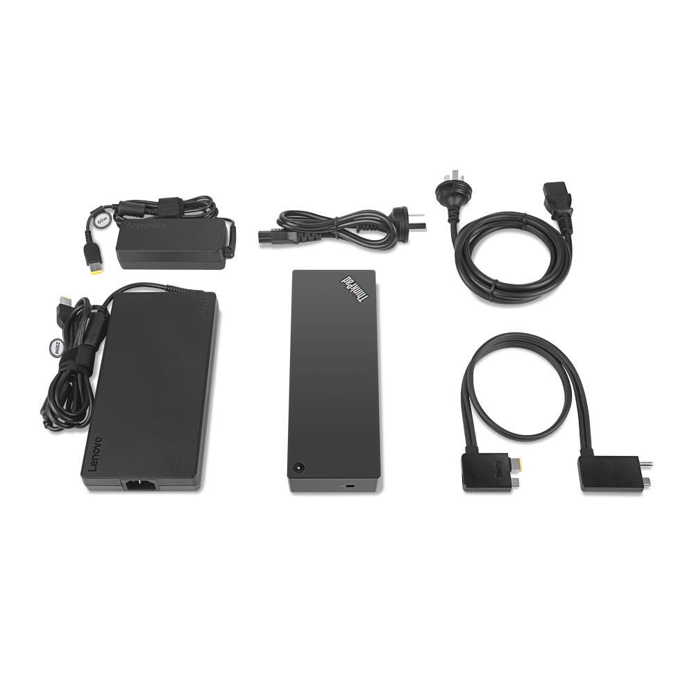

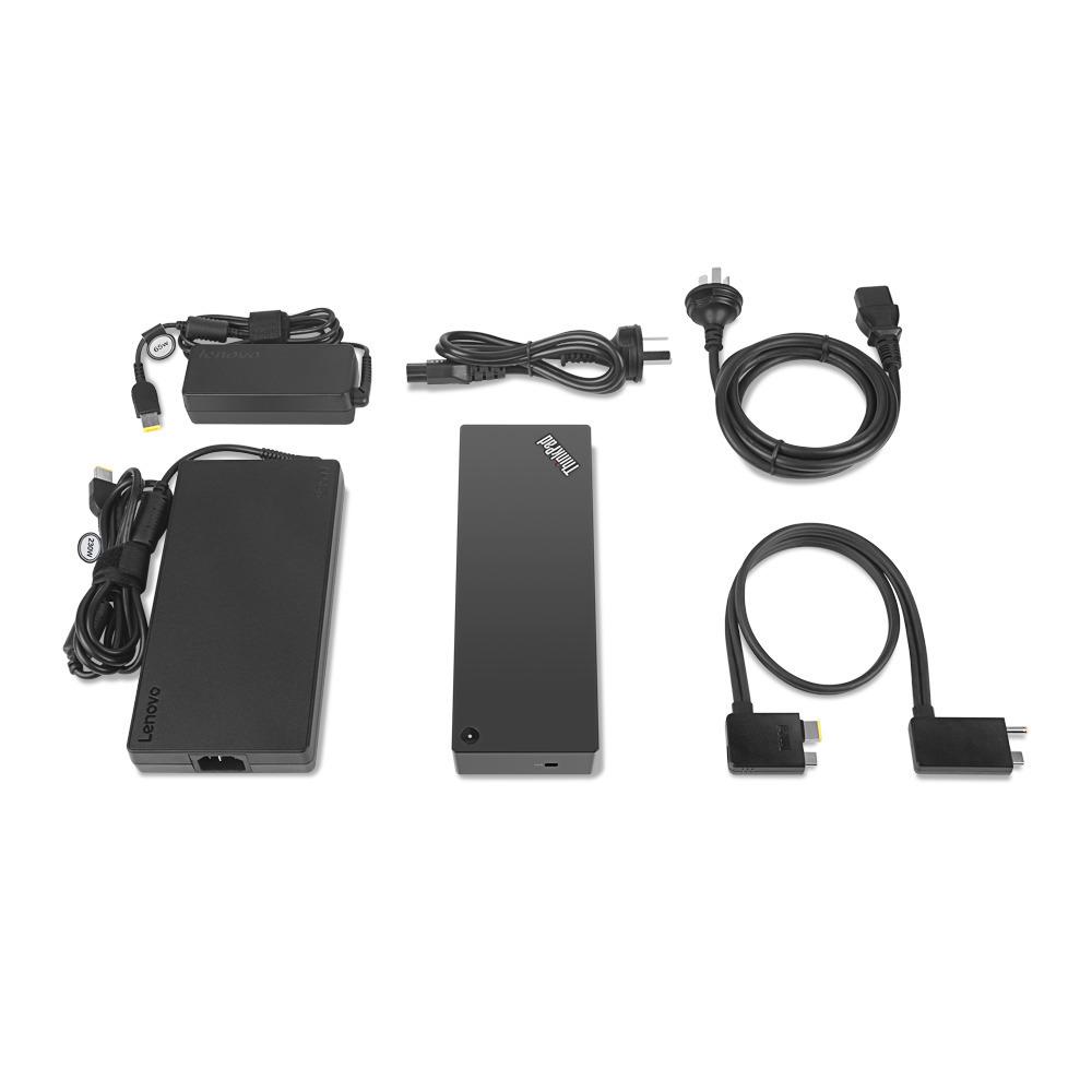

This Lenovo one might do the trick. Says “230 Charging” .... but that seems like it might not be accurate.
Already looked at it, will not work.
Included cable is custom: "Thunderbolt and Power customized cable"
"up to 230W to charge high-performance ThinkPad Mobile Workstations"
AC Plug: slim tip
Hardware Requirements: ThinkPad
OS Requirements: Win10
