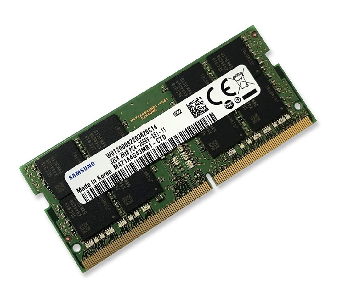

CAS Latency can usually be found on the sticker on the memory module. But if *all* memory vendors sell CL19 as iMac RAM, it has CL19 for sure.
As long as you get the modules listed in first post it’s fine.
Samsung makes memory more for OEMs and less for retail. That’s why almost nobody will have thoughts about Samsung, but it’s still a good memory brand. Good point of it is that they use their own DRAM chip, Samsung being a DRAM chip maker. So the whole module is Samsung made, just like Crucial which is Micron. Kingston is usually a mix of Hynix and Micron depending on which costs less when they order a batch of DRAM chips.

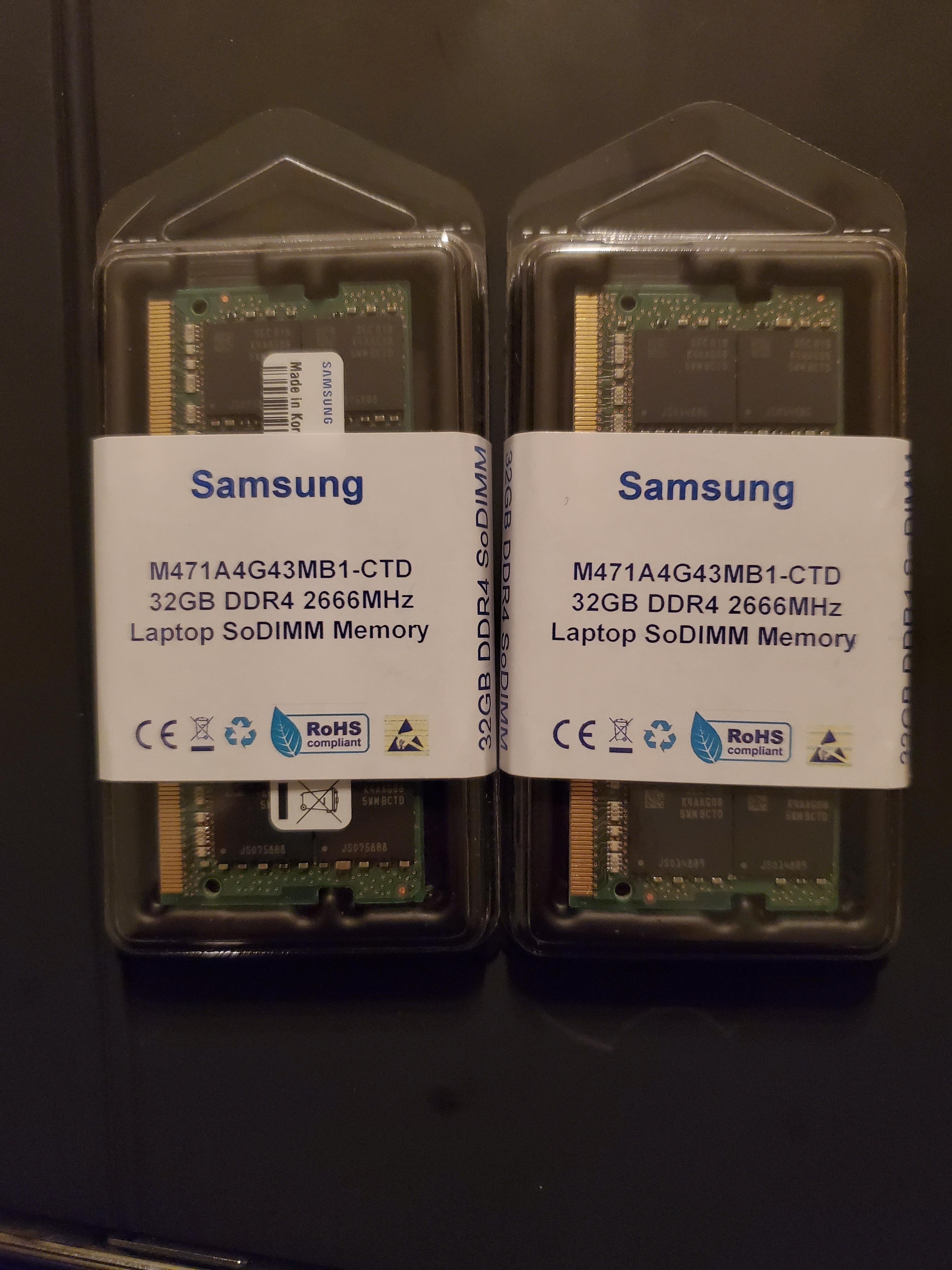

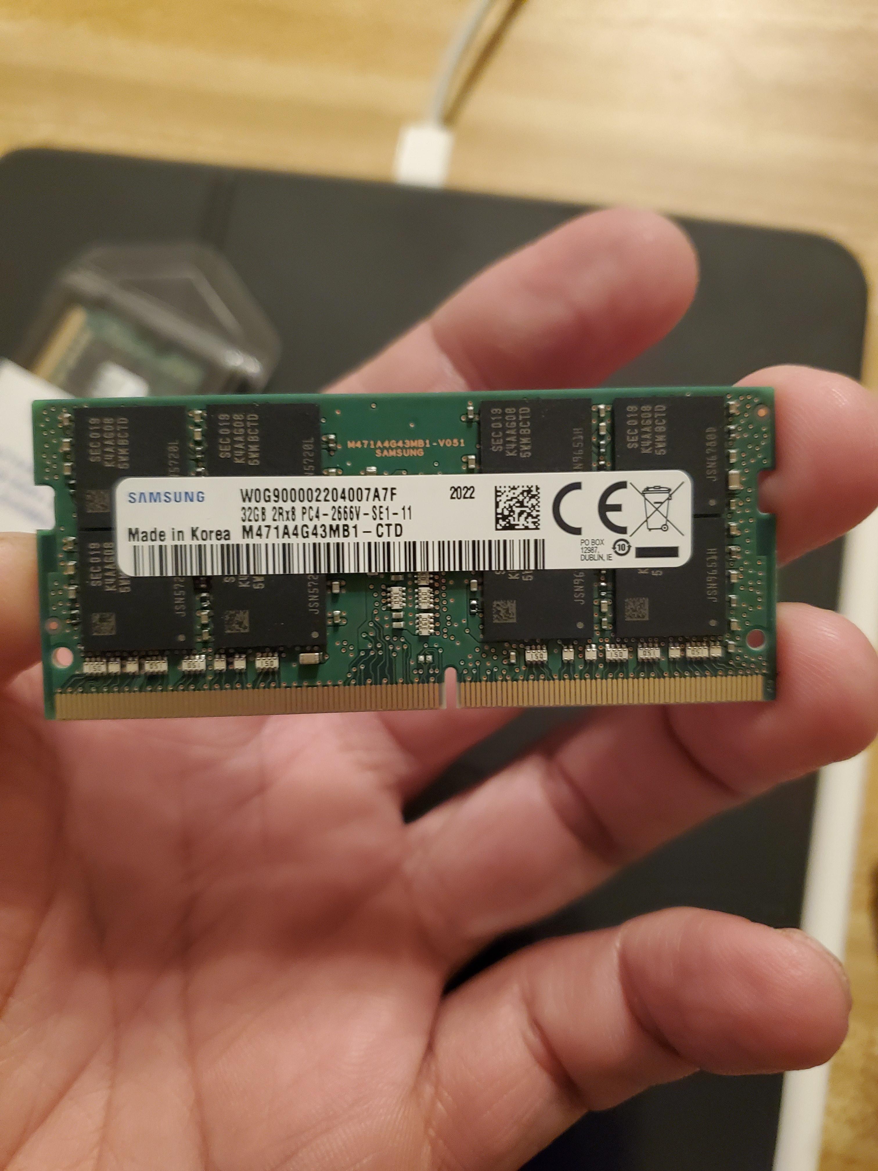

The module listed is missing the "-CTD" at the end of the part number, would this make any difference? Also, they only sell the singles, and you mentioned it's better to buy the kits, would you still recommend 2 of these over the TimeTec which does sell the kit?
Thanks.
Thanks.
I don’t think the -CTD means really something. I really can’t find any of these modules with -CTD.
I would buy 2 Single modules over TimeTec memory since I know the source of DRAM chips. I can’t find the DRAM supplier of TimeTec.
Thanks, went with the Samsung's, like you said it's the better brand. The TimeTecs were temping because of the black boards and they're made in the USA, I like to support US companies when I can. They were both around the $240, so quite a bit cheaper than Crucial or OWC.
