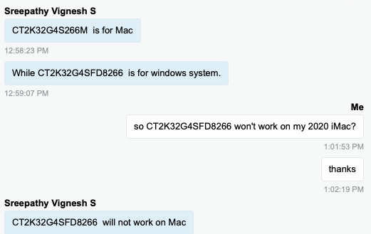

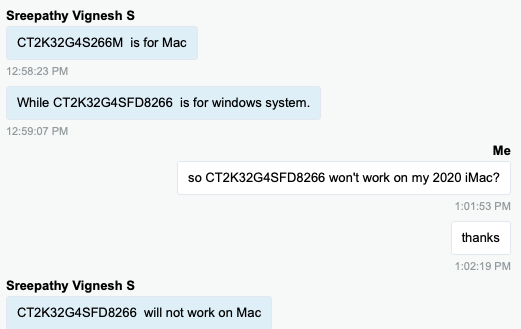

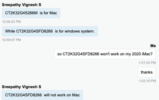

The Crucial stuff is confusing. Could I just order two 64gb kits? (2 x CT2K32G4S266M)? There's also CT2K32G4SFD8266 but still not clear what the difference is there between those two. CT2K32G4S266M is out of stock in Amazon. I prefer Amazon due to easy return if it doesn't work.
Wondering if I can get thoughts on a 128gb kit. I guess only OWC has one listed in the first post. What do you think of OWC memory?

No. the -VK model is the 2666 MHz and this is the required module.
Ok. Thank you.

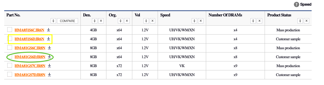

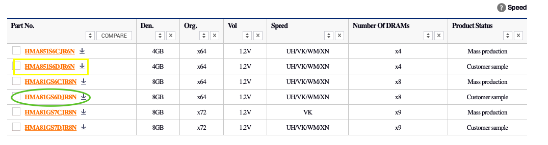

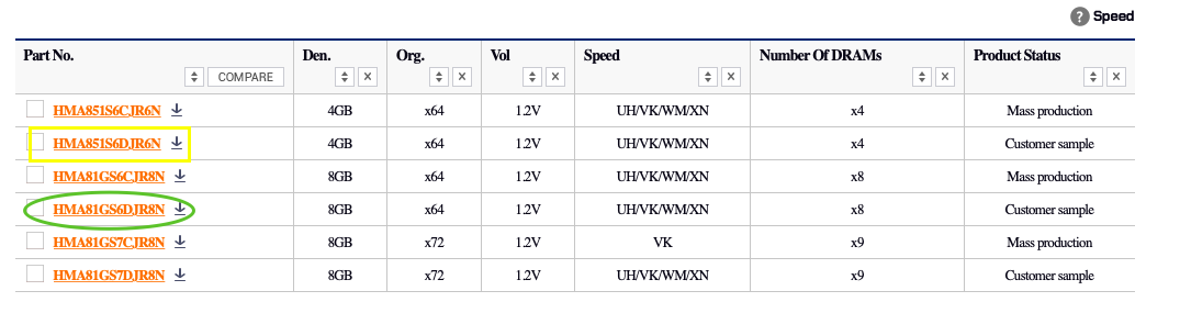

So I checked on Hynix's website what SODIMM RAM they are offering right now and I got this:
Apparently the letter before "JR6N" shows on what die (whatever that is) memory chip is based on. So HMA851S6DJR6N-VK (which is the model present in the base model iMac 2020 as stated above in this thread) is based on D-die (according to its technical data sheet) and the HMA81GS6CJR8N model I mentioned before is based on C-die (according to its technical data sheet).
Therefore judging by the information provided on Hynix's website - most similar 8GB RAM chip to the RAM which Apple is putting in the iMac is the HMA81GS6DJR8N-VK model.
I will buy two 8GB chips of those and try to run 24GB of RAM on 2666Mhz. Wish me luck haha

I don't see why it shouldn't work. They have the exact same specs... Maybe the chat guy just read his sheet of paper.
Yeah, I'm thinking the same.It makes zero sense to me that it shouldn't work if the specs are identical.
Maybe I will take one for the team and actually try them out...

CT2K32G4S266M:
PC speed - PC4-21300 (peak data transfer rate MB/s)
2048Meg x 64 • lead free • halogen free • for Mac
CT2K32G4SFD8266:
PC speed - PC4-25600 (peak data transfer rate MB/s)
I guess it could be a typo; or maybe they just peak differently, even tho they are both PC4-21300, no idea.
