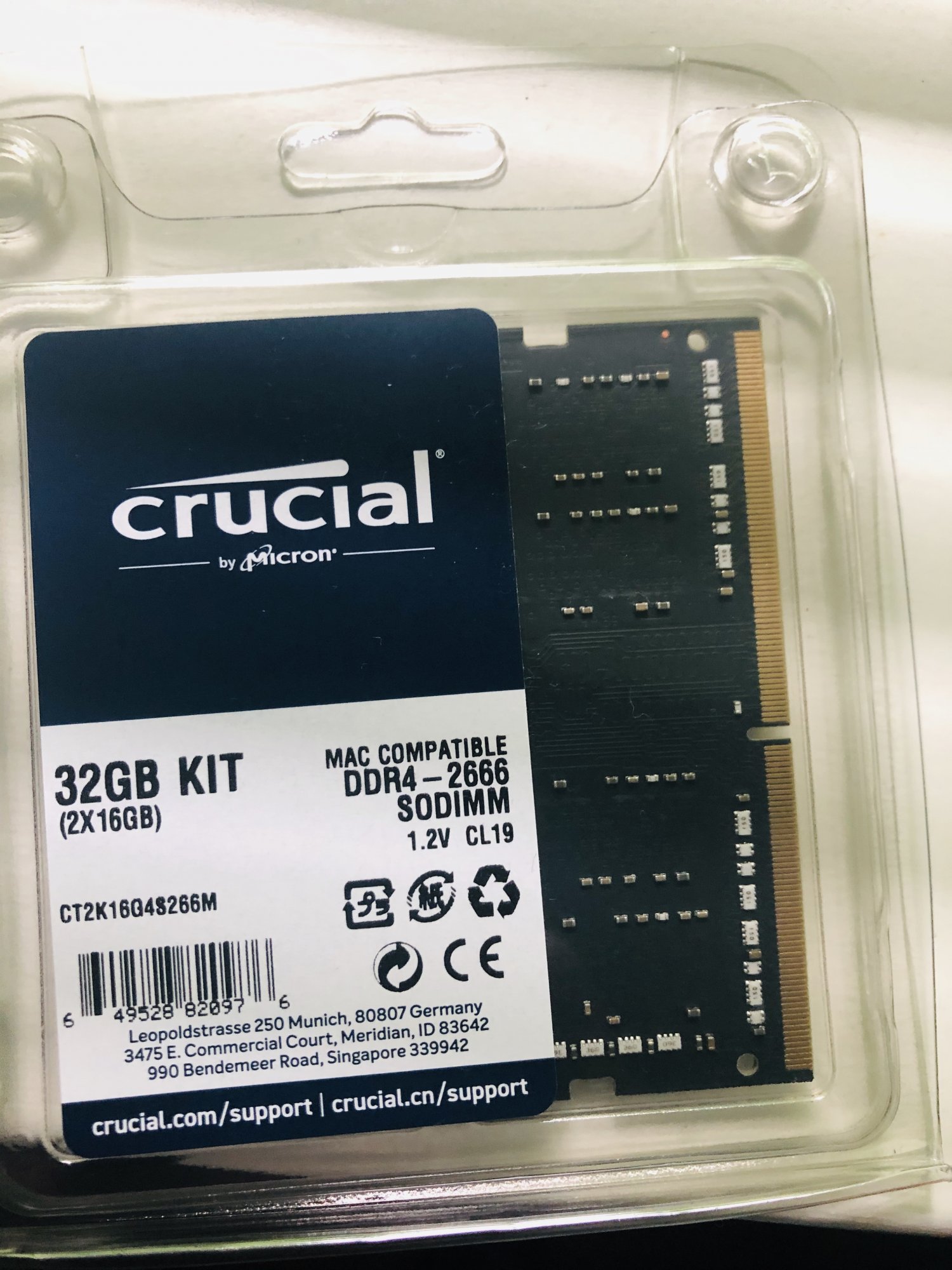

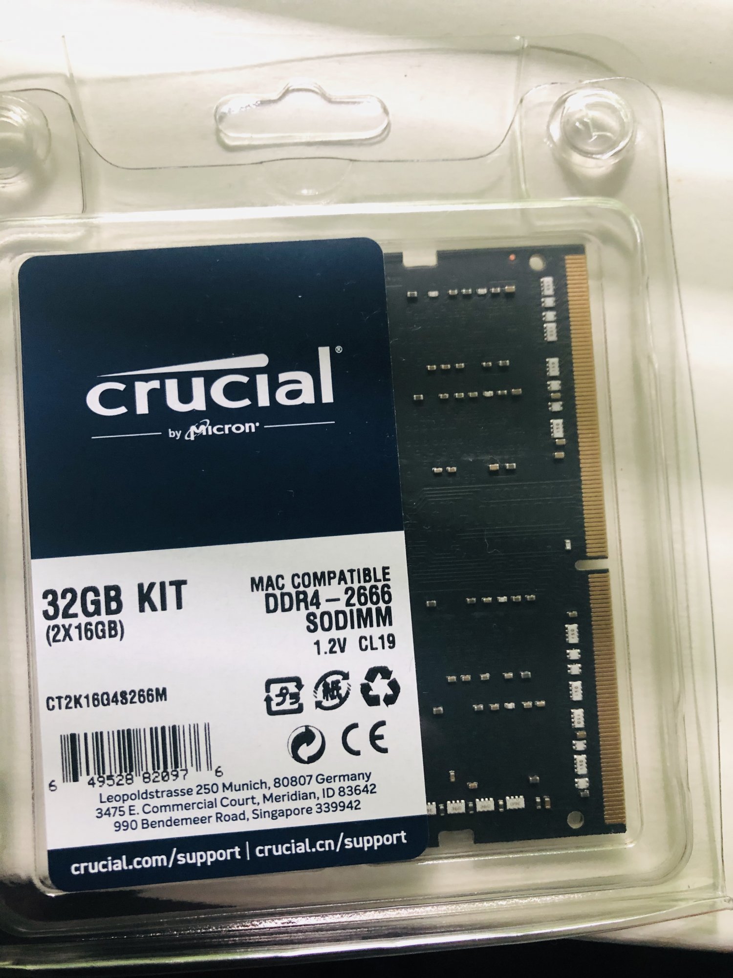

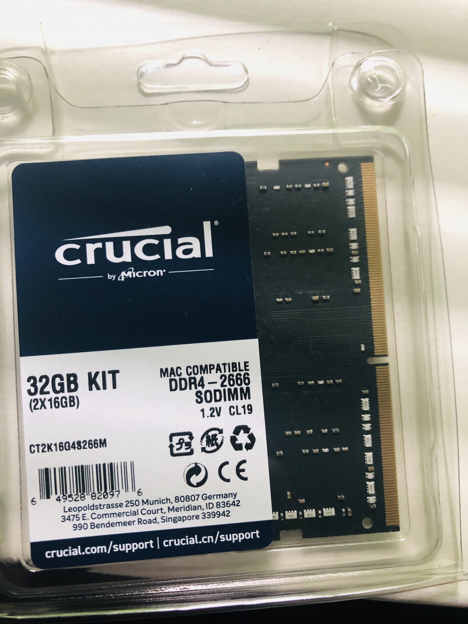

As I said :
The correct, fully certified kit is CT2K16G4S266M . Up to you to chose it or not. Someone already tested CT16G4SFD8266 and it worked, so there is no problem. I don't know what is the difference between both modules. I prefer to take the certified kit. I don't see any reason not to take this certified kit over the generic kit.
Ok fair enough, i have ordered the CT2K16G4S266M kit. And i will post the test.

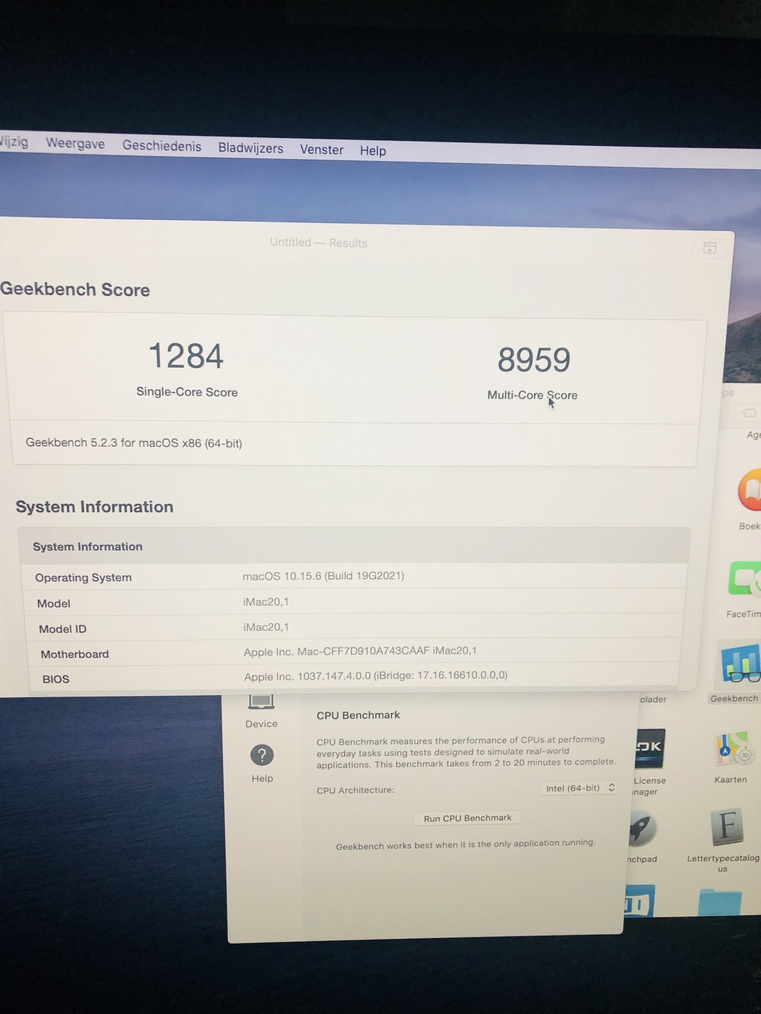

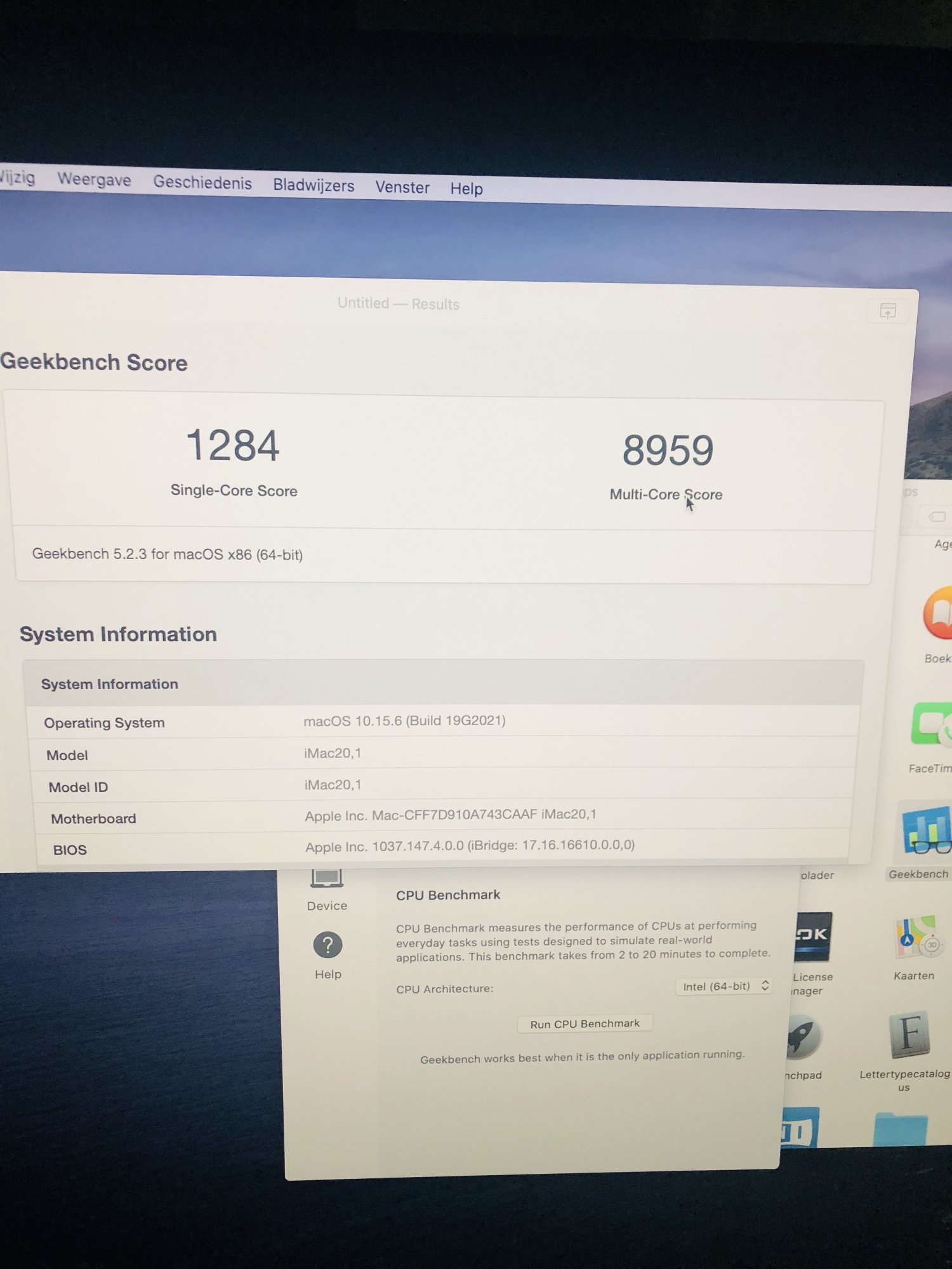

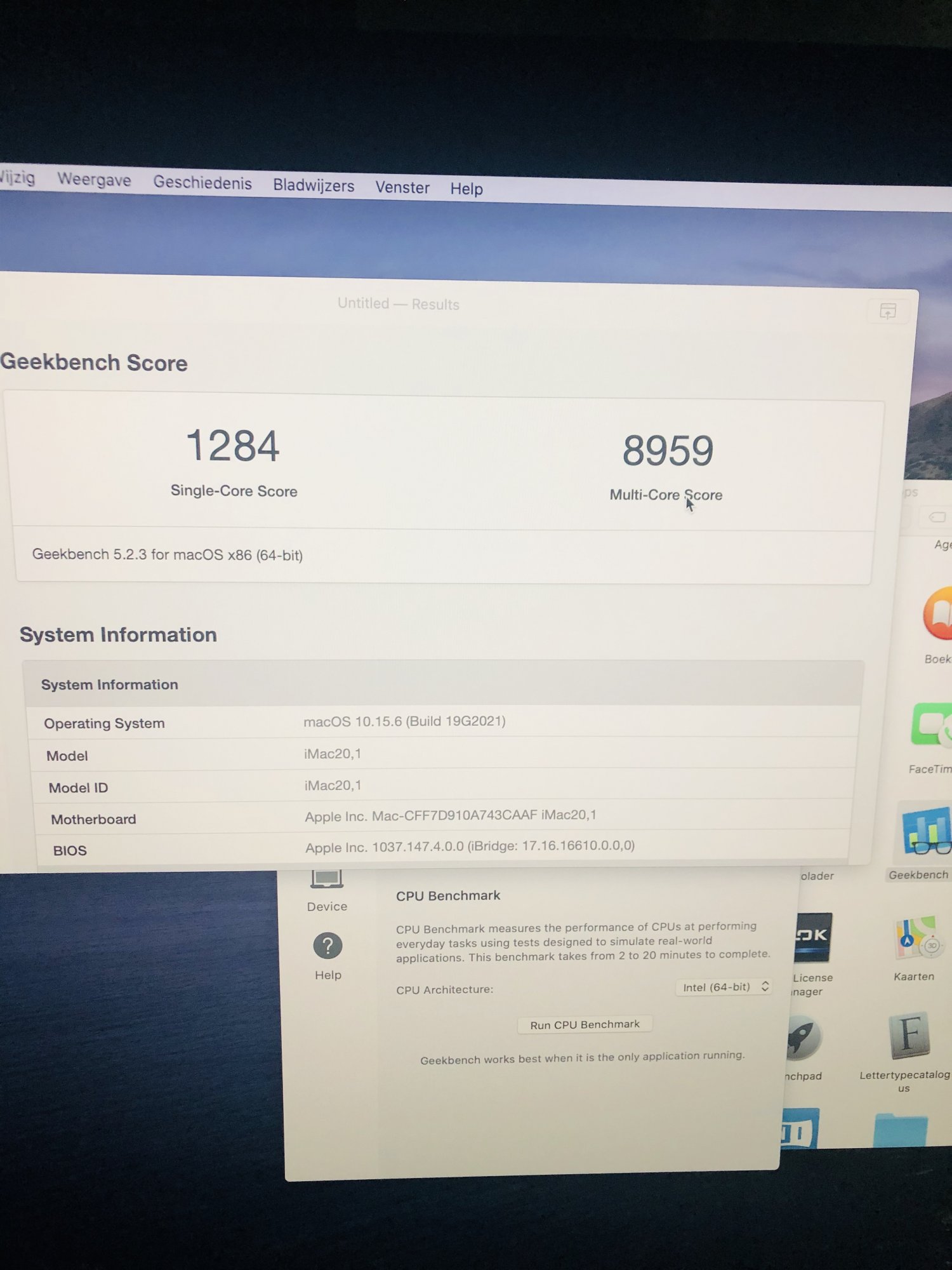

Hi Peepz
This is the result with the Crucial CT2K16G4S266M kit 2x16GB.
Its a keeper for me ;)
Soon I will buy the same kit to make it 64GB total.
