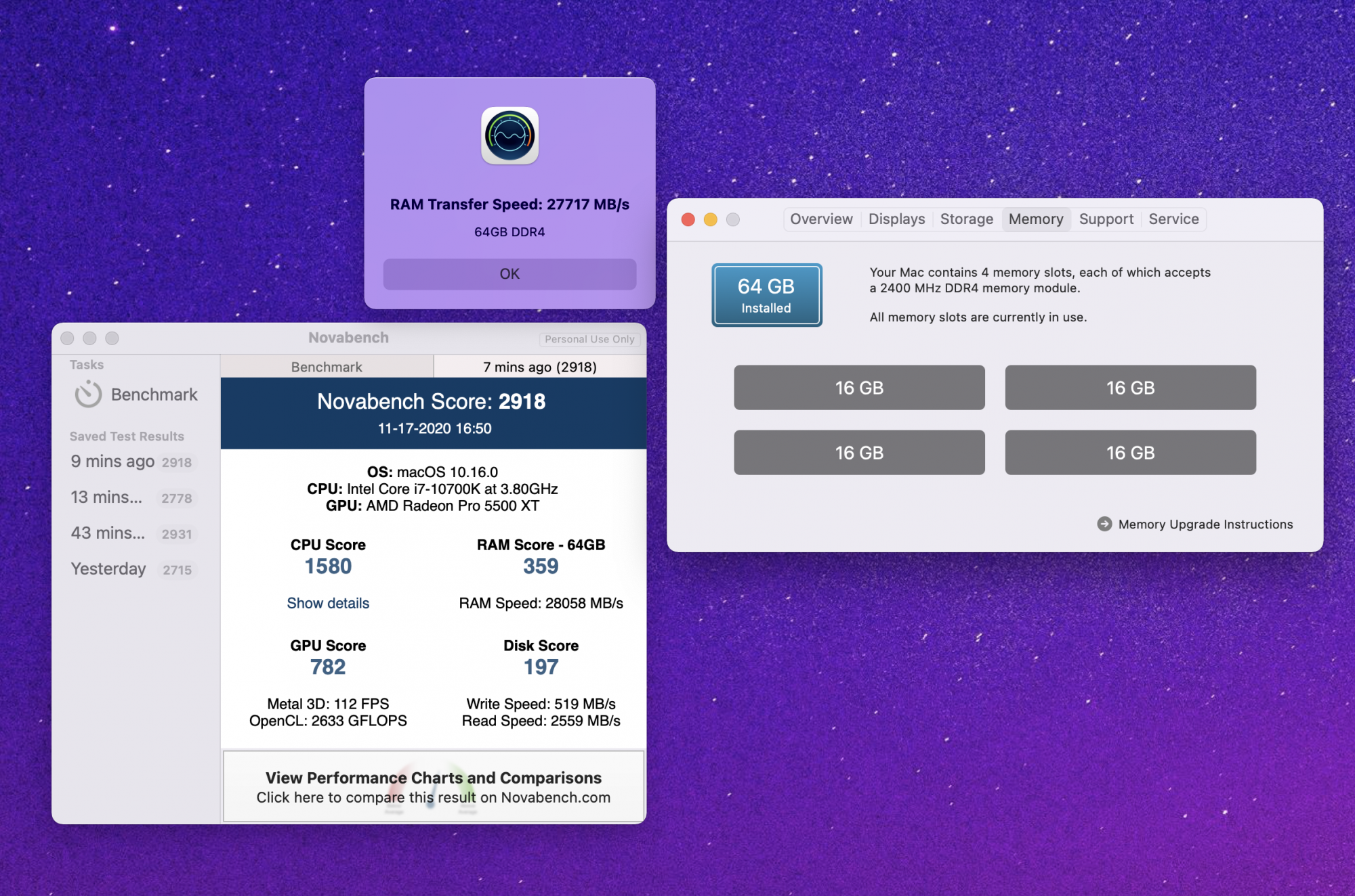

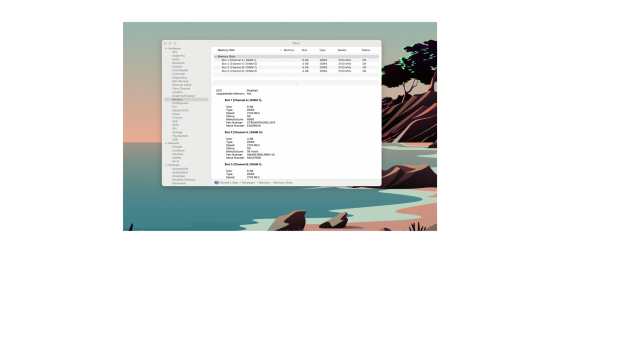

Okay I'm so confused... I had 24gb (the original 8gb from Apple and then another 16gb from V-color/amazon). I kinda got the point about the whole dual channel thing so I went and bought 2 pair of identical 16gb Kuesney/amazon for 64gb. This is what I've got. It went down to 2400Mhz. What the hell am I doing wrong?

Pretty strange!
What I see on mine:
"Your Mac contains 4 memory slots, each of which accepts
a 2667 MHz DDR4 memory module."
Could it be that you bought 2400 MHz modules instead of 2666?
I don't think so.....
What MHz does it report if you just put two of the sticks in? (Say in slots 2 and 4).
If it still gives 2400 MHz, I think you may actually have 2400 MHz sticks despite the description on Amazon. Or there is some incompatibility.

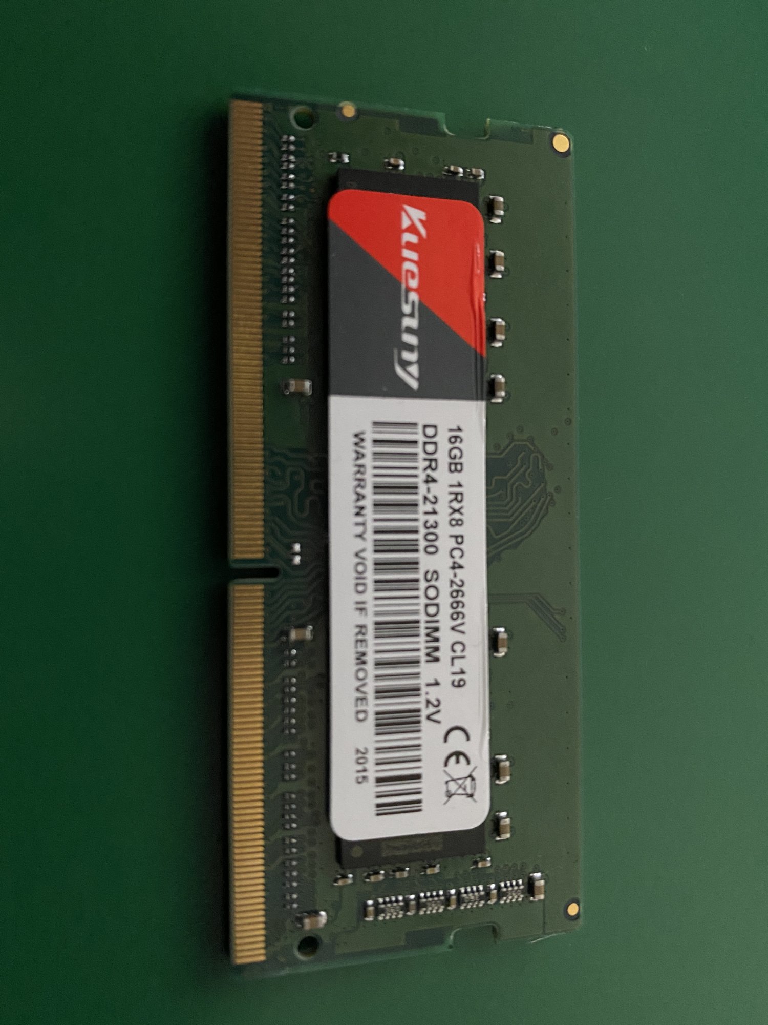

Do you have a photo of the label on the stick?
Also a screenshot of the "Memory" under "System Report" under "About This Mac"

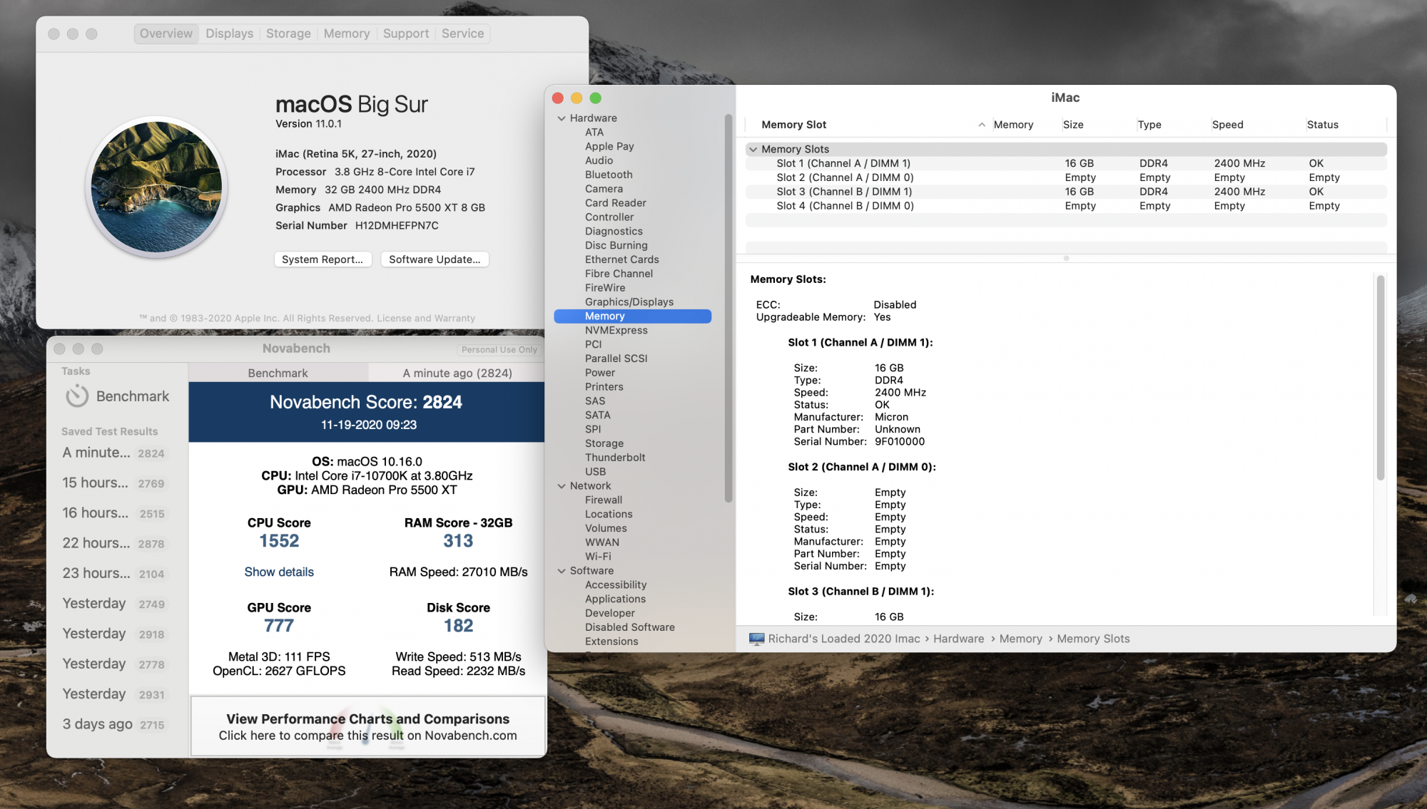

So I installed second 32 GB stick this morning and generally, all seems fine.
For a better overview, Novabench:
40 GB (8+32)
Score: 2957
CPU: 1570
GPU: 911
Disk: 181
RAM: 295 @17978 MB/s
Geekbench 5: 1245/7310
32 GB
Score: 2994 (!)
CPU: 1612 (!)
GPU: 915
Disk: 186
RAM: 281 @17841 MB/s
Geekbench 5: 1322/7071
64 GB (32+32)
Score: 3109
CPU: 1629
GPU: 954
Disk: 168 :oops:
RAM: 358 @27923 MB/s
Geekbench 5: 1383/8848
Other than sudden drop in SSD performance (why???) I am happy camper.
What's interesting here, the GPU seems to have gotten some room to breathe :)

Novabench GPU and Disk scores are not reliable/meaningful, ignore them. Use Geekbench 5 Compute for GPU, and Blackmagic for disk tests.
Good to see your 2x32GB seems to be running as it should

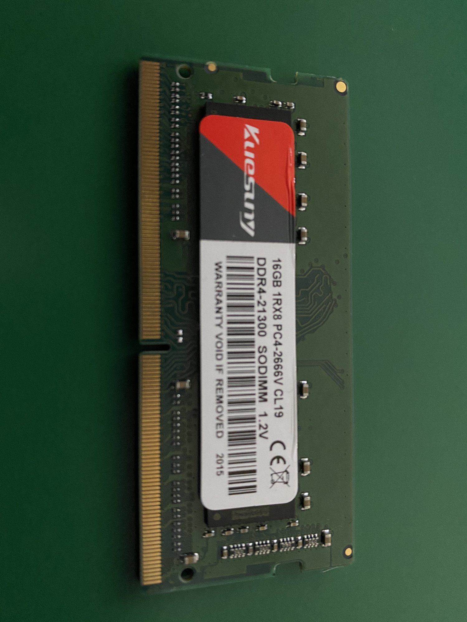

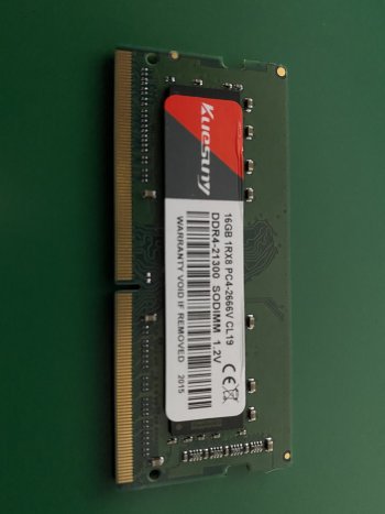

Well, you were right. Someone at this company screwed up. Sticks say 2666 but when installed are 2400. Guess it's time to ship it back to Amazon. Is this common? Thanks for the suggestions. I'm not sure I'm going to stick with 64gb anyway. Is there a significant performance difference between 24gb, 32gb or 64gb configured properly?
Reactions: wilberforce

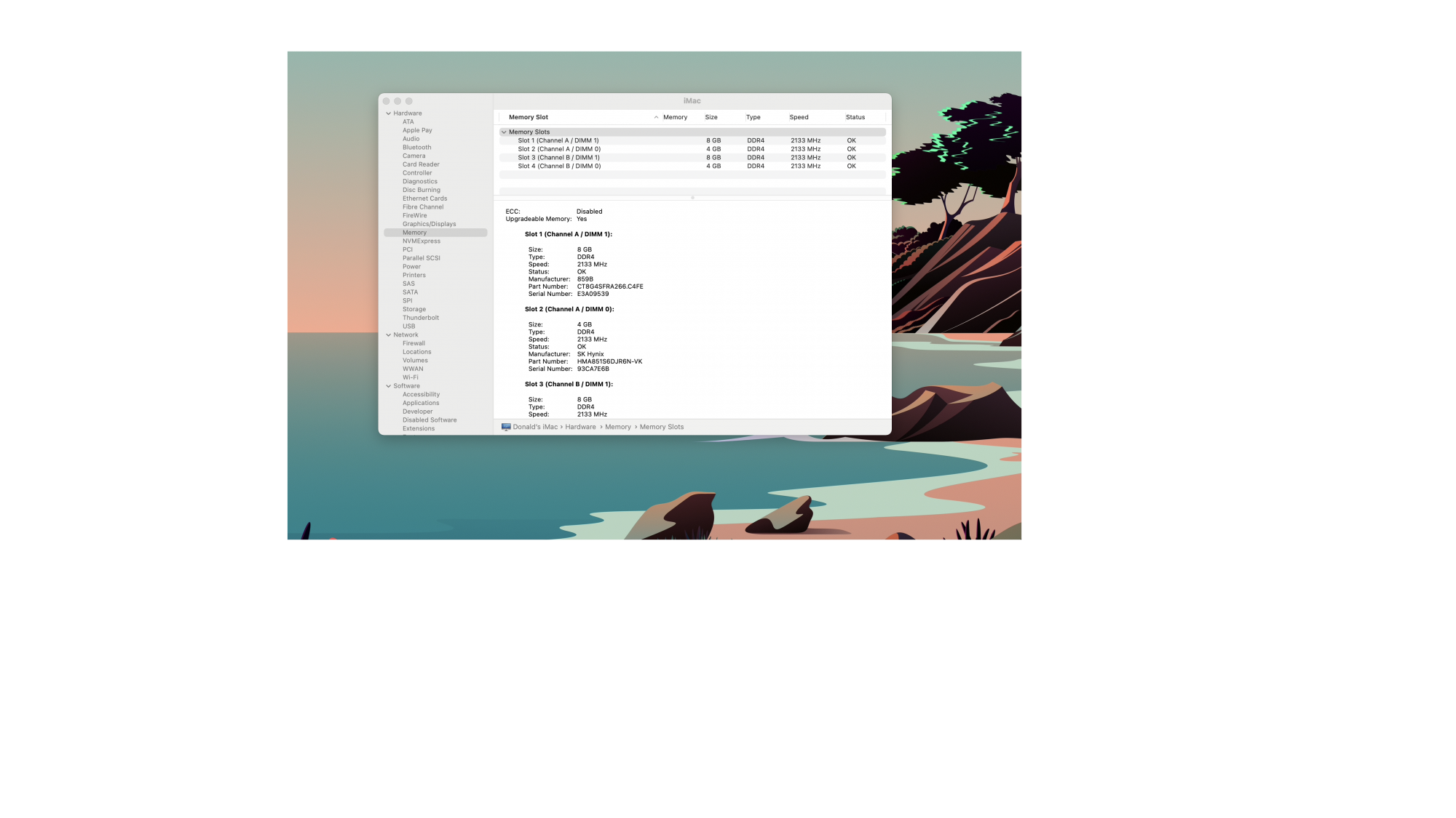

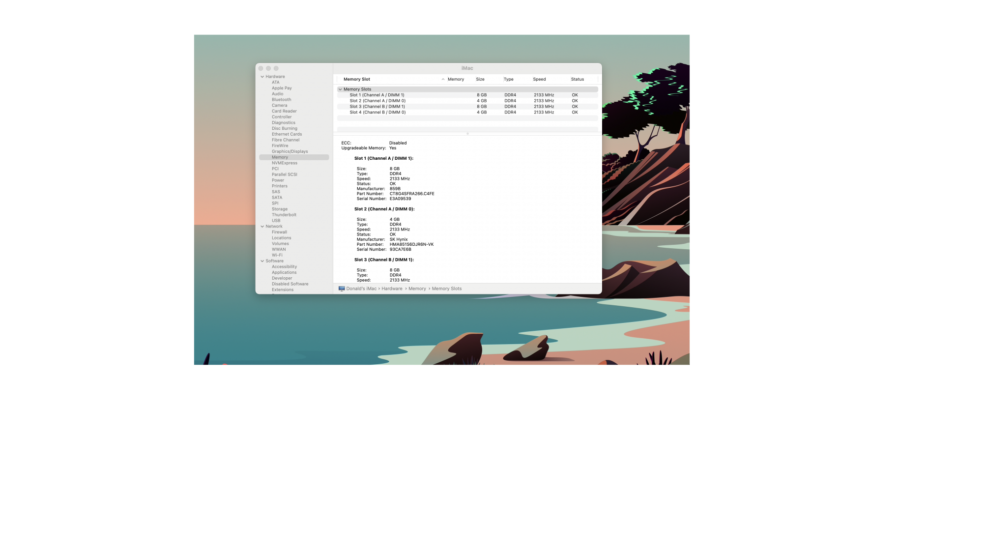

Hi Guys,
Ive just bought 2 x 8gb CRUCIAL RAM
CT8G4SFRA266​
Ive read through thread and just wanted to know if the above ram is suitable for the iMac 5k 2020 and will running it with stock 2 x 4gb apple ram be okay until I get another two crucial ram to match? or should I just ditch the apple ram for now?
Hi Guys,
CT8G4SFRA266​
As you can see, your RAM isn’t working at full speed (2133 MHz instead of 2666 MHz) because you have mismatched RAM sticks.
If you need an additional 16 GB of RAM, pick the same Crucial modules. If 16 GB is enough for you, remove the Apple sticks.
Reactions: Bigyid
So it will do no harm leaving as is for next month or so?
