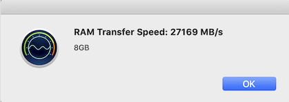

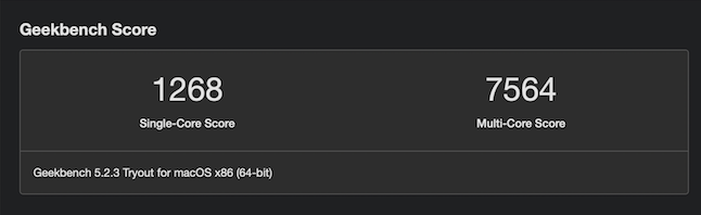

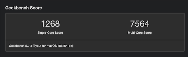

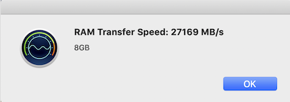

My test result with default 8 GB:
Novabench RAM test with 8 GB:

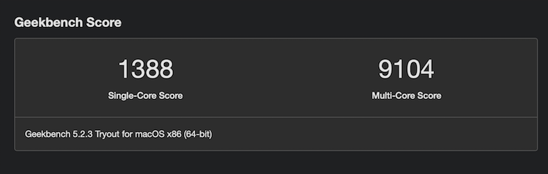

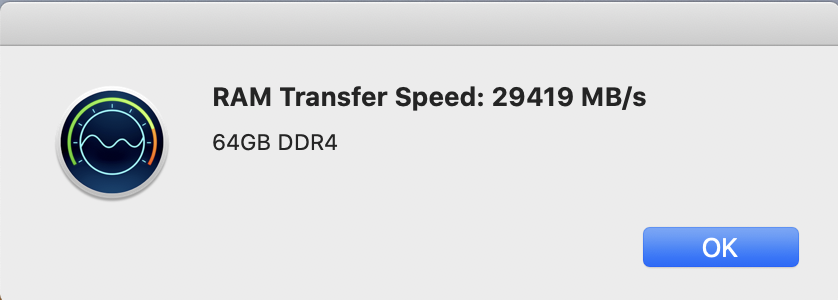

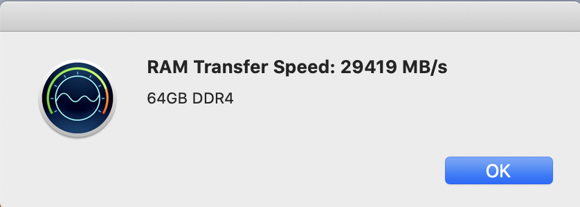

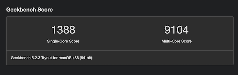

My test result with 64 GB (DIY):
Novabench RAM test with 64 GB:
Anyway, this is also worth looking into if you haven’t decided on RAM yet.

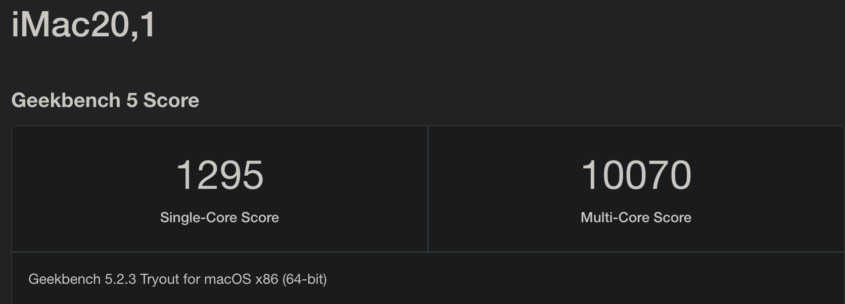

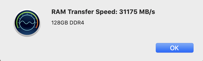

Just finished installing 128 GB's of Crucial's RAM!
System: iMac 20.1 (i9 3.6 GHz 10-core, AMD Radeon Pro 5500 XT)
Geekbench Results:
Novabench RAM test results w/ 128 GB:

https://browser.geekbench.com/v5/cpu/3836982 my geekbench result for 2x32 Samsung M471A4G43MB1-CTD.
I tried to run my Imac2020 with aftermarker + Apple memory, but it crashed and didn't start.
Samsung memory works great, apple hardware test doesn't show any errors, benchs looks better (ram speed is better that 2x4 apple ram too).

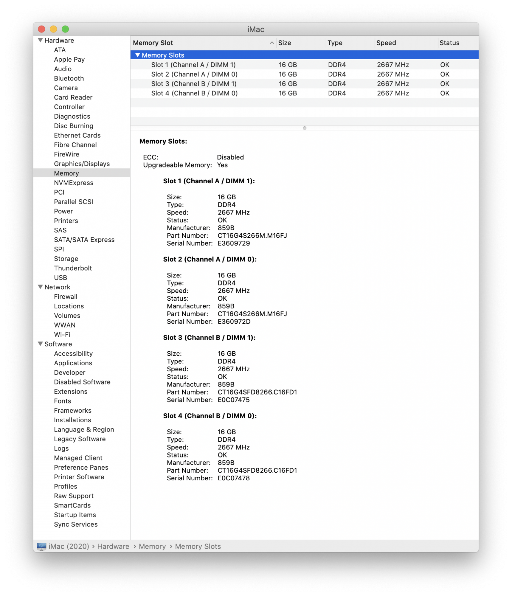

I have noticed this problem on mine too.
I have always upgraded the RAM myself on iMacs, and my 2019 model has two 4GB Apple sticks and two 16GB Apple sticks, and registers 40GB at 2667 MHz without an issue.
My 2020 model is stuck at 2133 MHz.
This is despite them both using Crucial RAM of the same specs, in addition to the Apple RAM.
I've played around with the sticks and these are my findings:
The 2020 iMac registers 2133 MHz using the same RAM sticks that the 2019 registers at 2667 MHz.
I took the sticks out of the 2019 model and placed them in the 2020 model, in the correct formation, and they reported 2133 MHz. So the 2020 model is more particular about RAM.

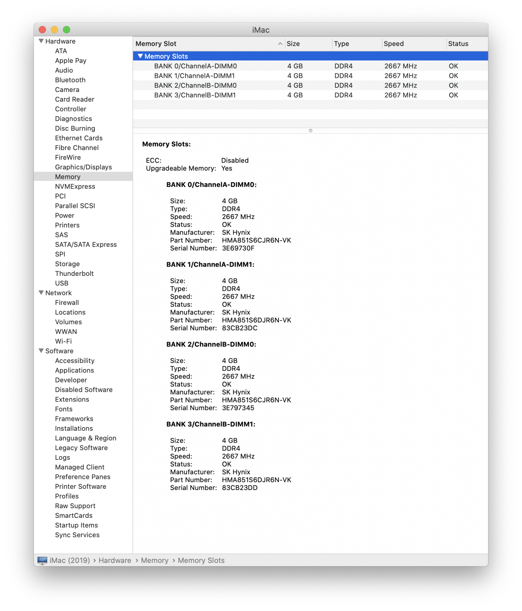

The 2020 iMac has a slightly different RAM arrangement:
2020 iMac (above)
2019 iMac (above)
This change is probably tied to the implementation of the T2 controller?
Putting all four 16GB Crucial sticks in the 2020 model still registered 2133 MHz.
This surprised me as they are all the same brand and spec. So I rearranged the sticks to what to me seems to be the 'wrong' way - my inherited 2019 Crucial sticks in Slots 1 and 2 (rather than 1 and 3 or 2 and 4 as you would normally expect), and the newly-bought Crucial sticks in Slots 3 and 4, and low and behold it is now running at 2667 MHz and 64GB.
The 2020 iMac is fussy even between different batches of the same RAM manufacturer and specs, not just between Hynix and Crucial. Get around this by keeping each batch/manufacturer to its own channel.
I am not sure what (if any) performance hit will come by mixing DIMMs in this way. I have always been told to install them in pairs in the first and third, or second and fourth, slots.

Where does it say 2133mhz on your 2 reports??? All I see is 2667mhz??
That is not the point of the screenshots. The point is to show that the 2020 iMac has a different configuration in terms of names and positions of the modules.
OK, so where did you find out that it was only running at 2333? Trying to sort out all of this info as I troubleshoot my 128gb OWC ram problems.
