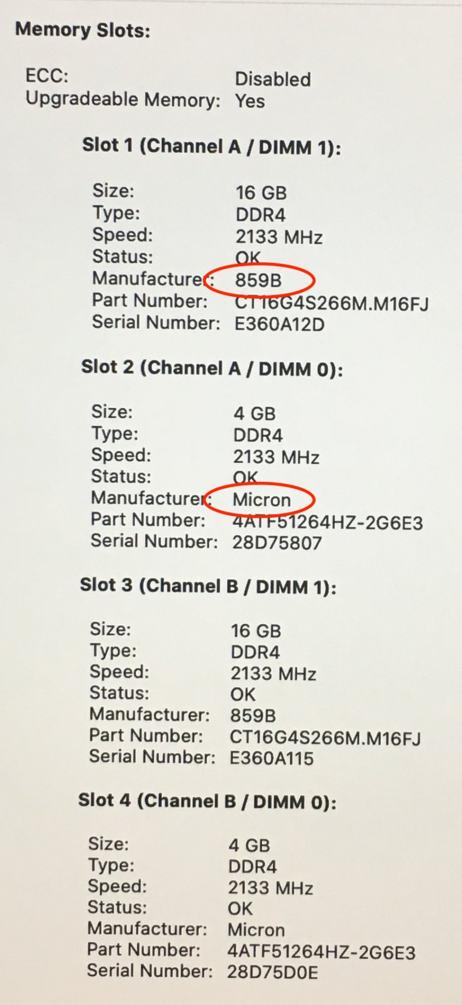

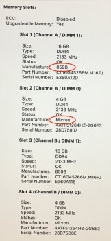

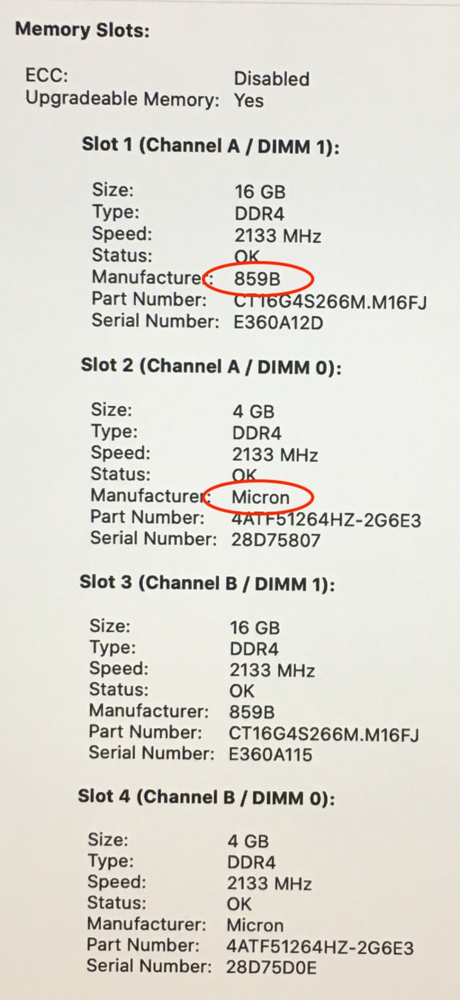

When I added a pair of 16GB Crucial RAM to my friend's new 2020 iMac, the "Memory Slots" in the System Report said the manufacture was “859B”. And the manufacturer of the original 8GB of Apple RAM was “Micron”.
FWIW i have the same 32GB of Crucial RAM in my 2018 Mini and it too shows a manufacturer of “859B” not Micron.

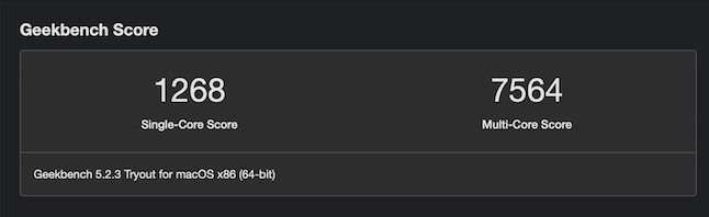

I'm still waiting for my own DIY memories. This will be 64 GB. Currently 8 GB.
However, I diminish the current test result.
iMac 20.2 (i7 3.8 GHz 8 core, currently default 8 GB RAM, GPU 5700 XT)
Single-core: 1270
Multi-Core: 7566
Is the multi result not low or normal?
(After the memory upgrade I'll post my new test result.)

Hello,
Single-core: 1270
Multi-Core: 7566
That looks "normal" in that it is consistent with scores others report for i7 with only 8GB RAM.
However you should get about 8900 multi-core when you have 64GB.
See:
(you have to click on individual results to see amount of RAM)
Reactions: fullhd

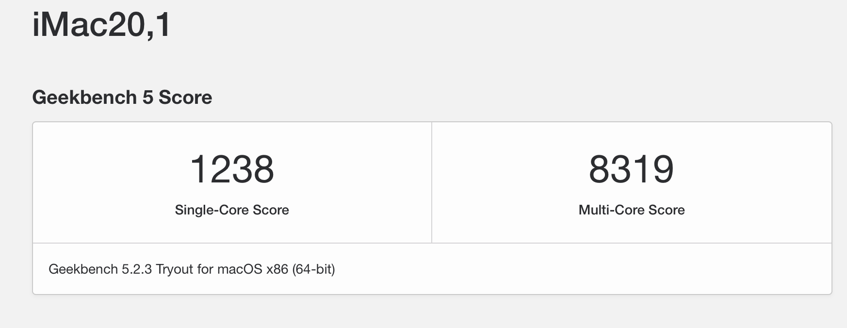

I dl Geekbench today and this is the score with 16GB of RAM. I will do another once I install the new RAM. I don't know if this is a good score or not.

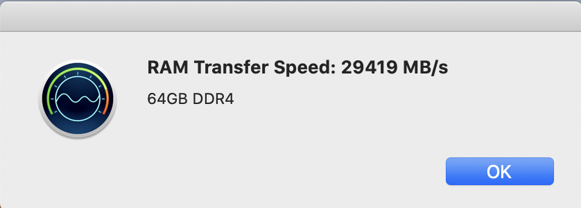

I just installed my memory upgrade.
System: iMac 20.2 (i7 3.8 GHz 8 core, GPU 5700 XT)
I bought Kingston memory which is system specific memory for iMac 2020.
64 GB RAM (4 x 16 GB) [Kingston - KCP426SD8/16]
Kingston System Specific Memory for iMac 2020

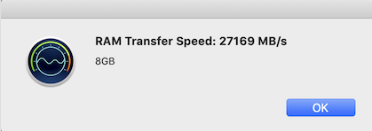

My test result with default 8 GB:
Novabench RAM test with 8 GB:

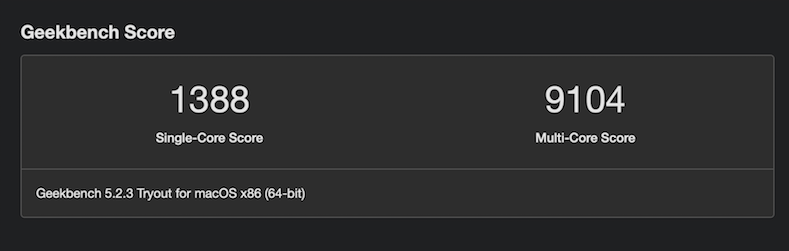

My test result with 64 GB (DIY):
Novabench RAM test with 64 GB:
