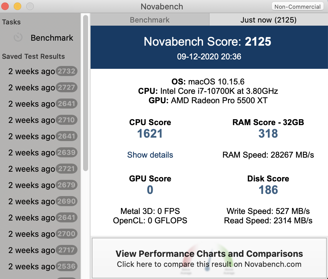

The only way I know is to run a RAM transfer speed test, such as using Novabench's RAM speed test. For this iMac the RAM transfer speed should be about 28,000+ MB/s, otherwise it is either running at a reduced clock speed (like 2133 MHz) or not running in dual channel.
In any case, what matters is that the RAM is performing at its full speed (about 28,000+ MB/s for this iMac).
Following screenshot is without GPU test, btw:

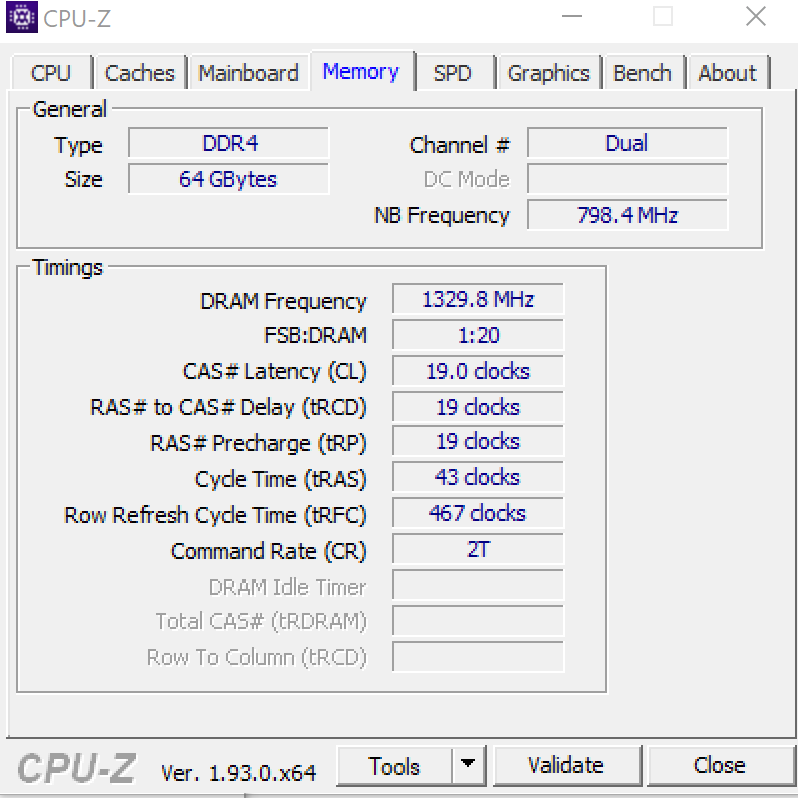

I have 2 x 32 GB of RAM to get to 64 GB. I am running at 2667 Mhz and in dual channel according to CPU-Z in Windows.

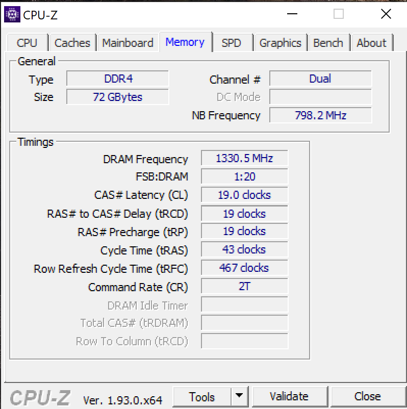

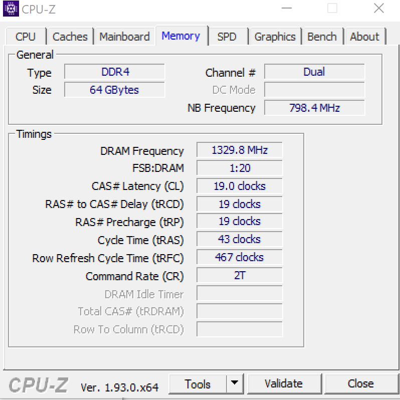

Hi all
I´ve just run a RAM test with CPU-Z on windows 10 (bootcamp) on my iMac 27" 2020, i7 8 Cores with 5700XT.
Seems like if you conect in the right order you can get 2666mhz and dual channel even if the memories aren´t 100% identical between them.
Here some pictures.
Can I now say I´m safe running 4gb-4gb-32gb-32gb in 2667Mhz DUAL?
Thank you

Well, it just show that iMac DOES support Flex memory mode.
However, in your case, you get 16GB of RAM in dual channel only, while the rest 56GB is in single channel.
CPU-Z cannot differentiate flex mode from real full dual channel.
