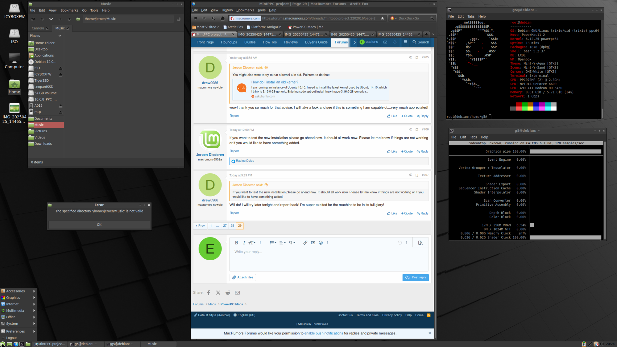

Short report:
I have installed MintPPC64 on my G5 2.3GHz, 6GB ram, Radeon HD 6450 in slot x16, GeForce 6600LE in slot x8.
System installed with iso from 31.03.25 and after installation boots quite ok (see below- small xfce problem). By default GF6600 gives picture without any distortions or black screen.
Because I want to use Radeon HD i have generated xorg.conf file with Driver changed from amdgpu(default) to radeon (doesn't need any changes in BusID!!!)
One problem I've go was some xfce elements couldn't be loaded but after reinstallation of xfce everything start working well.
BIG THANKS to Jeroen for his work!!!!

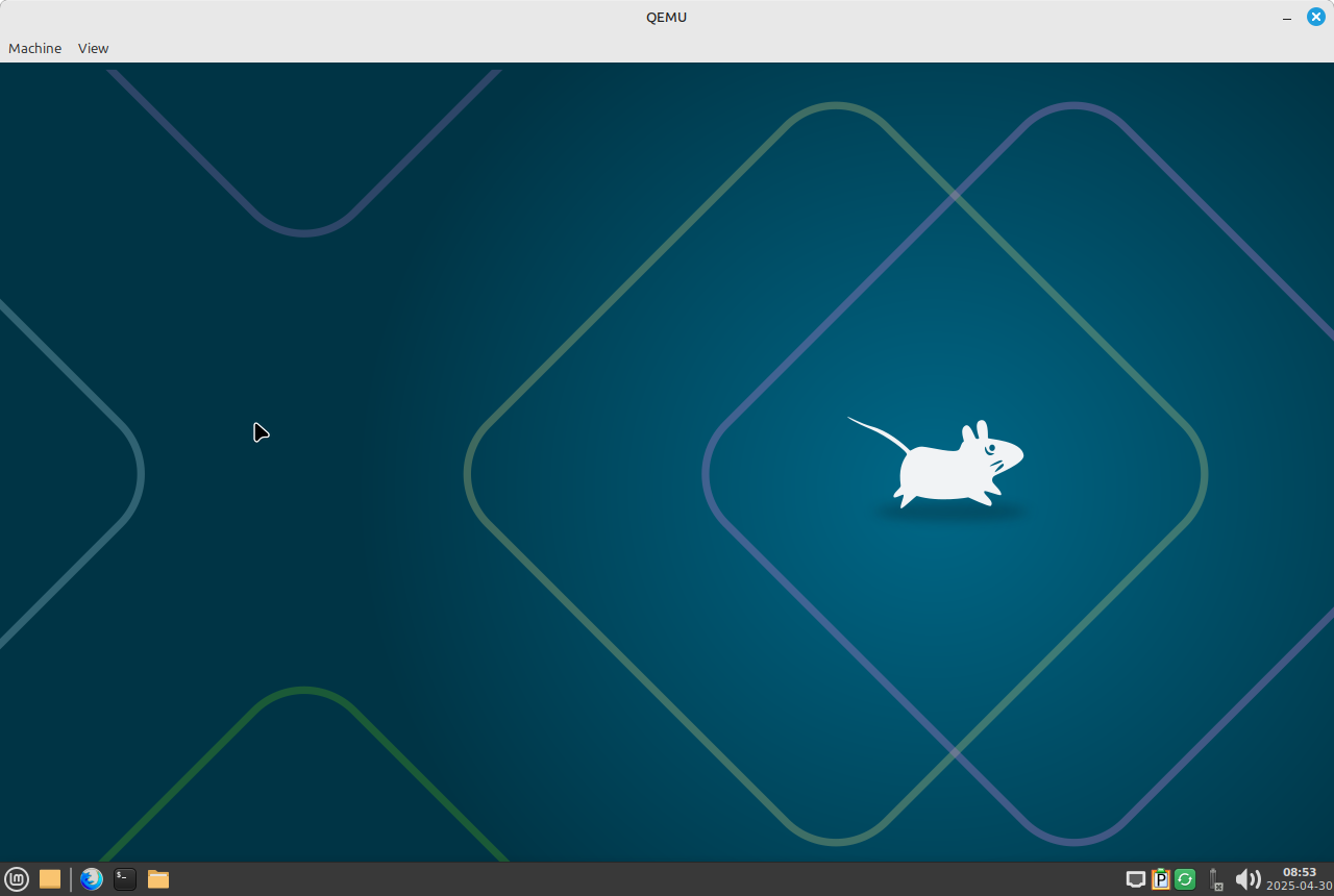

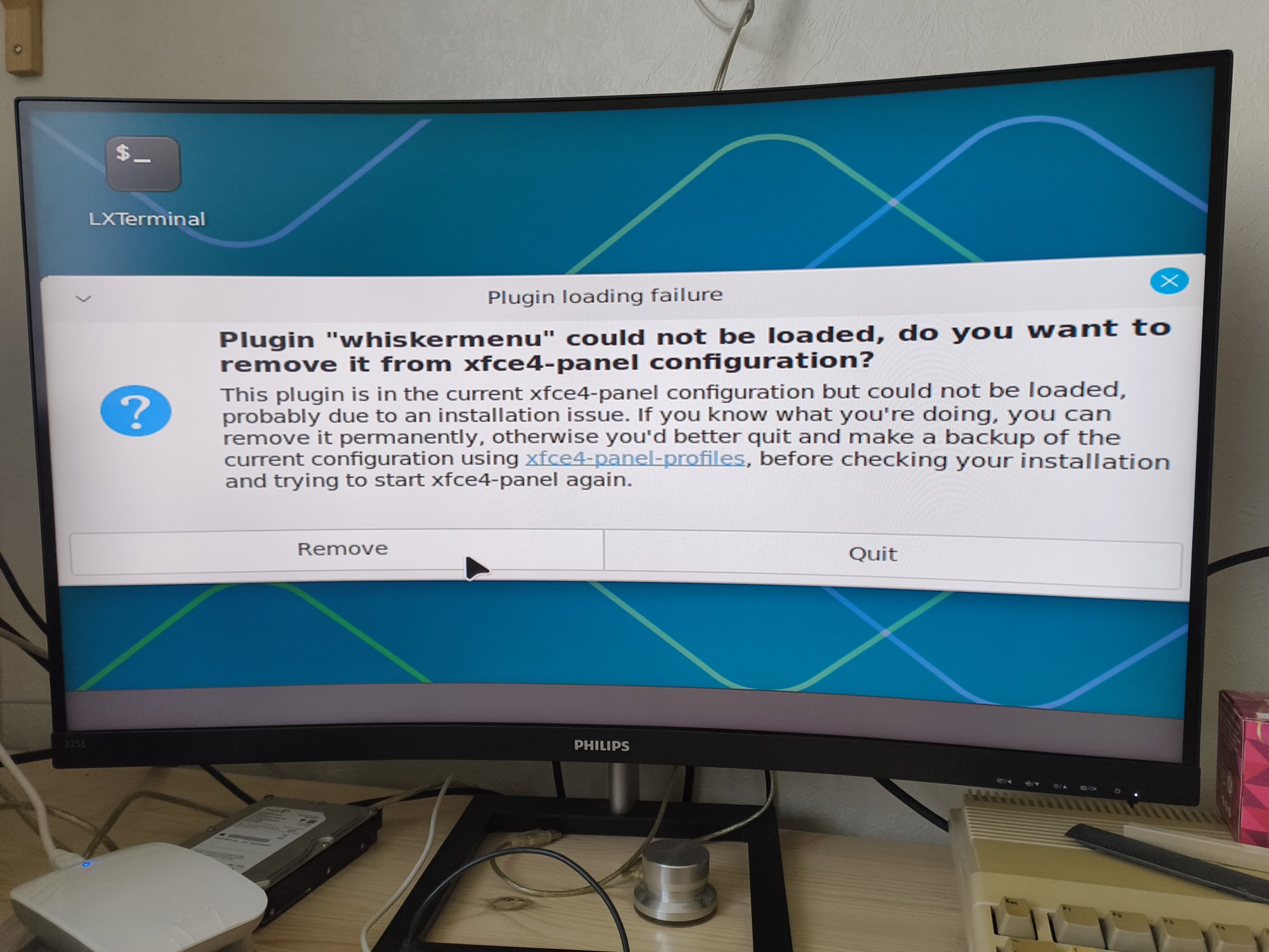

I checked this myself and I got a xapp-status-panel loading error now, something I did not see when I made this work more than a year ago. I will have to look into this.
Edit 30.4. 19:54 BKK time
I made some progress (see picture). I need to get the mint wallpaper installed by default.
Edit 30.4 23:03 BKK time
The wallpaper issue has been fixed in a new version of mint-xfce-default-settings.
To be done: fix the broken power-manager

I fixed the bookmarks problem (in the picture you see a /home/jeroen/Music is not valid error) in PCMANFM in a new version of mint-lxde-default-settings. To do this yourself:
amend the file
path to home/.config/gtk-3.0/bookmarks
And point to your own folders.
