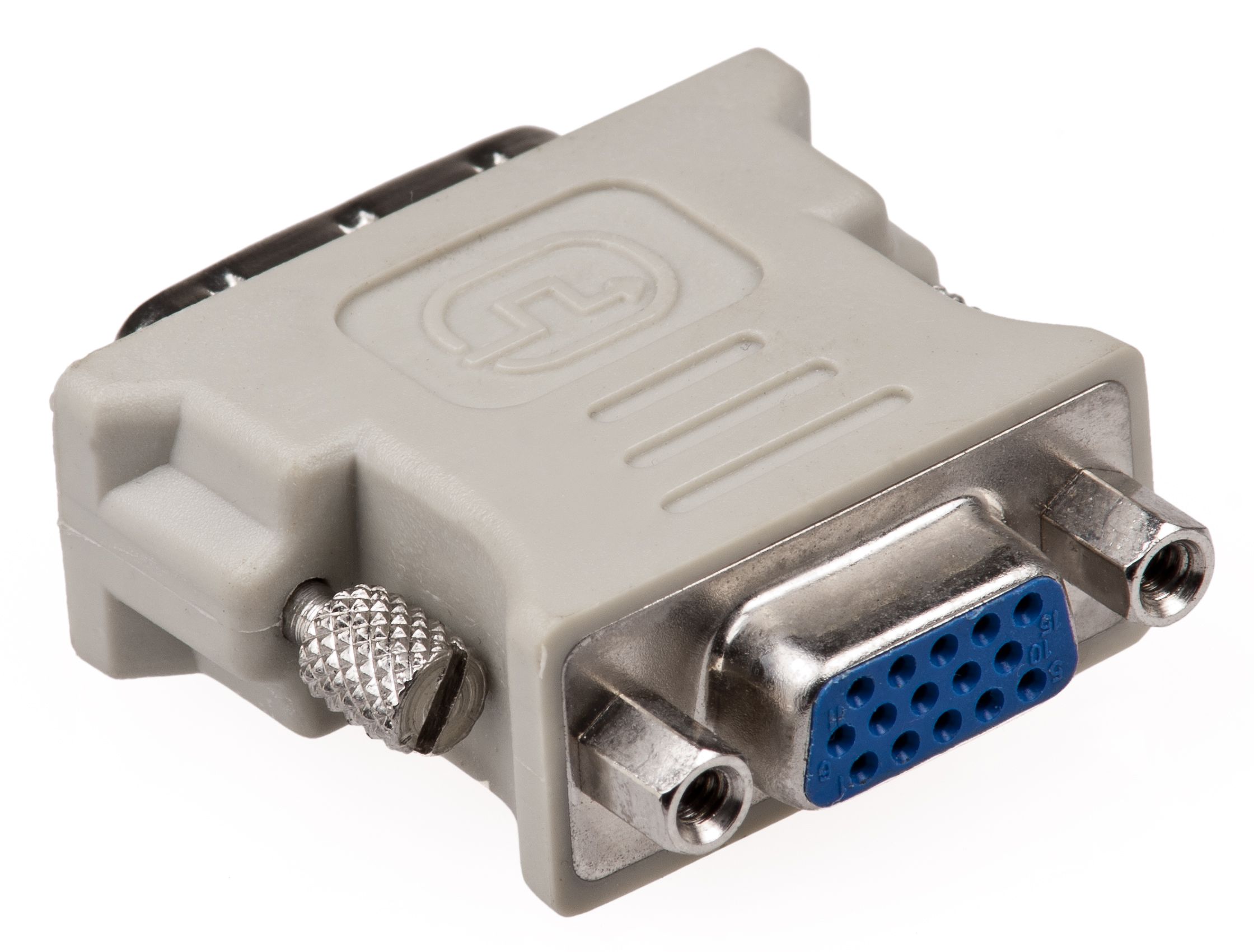

The other question I wanted to ask you regarding the monitor. My monitor only has VGA input while the video card has DVI output. If I were to buy a cable that makes the conversion (DVI to VGA) do you think that there might be problems ?

and about your dvi or vga,it will not make a difference. the card will work as it should be.
if you want you can buy an adapter for your videocard. they are very cheap,that is if you dont have one.

Regarding the adapter, I am very undecided whether to take an adapter to connect to the video, or if you get a cable that converts from DVI to VGA
I wanted further clarification..But the adapter that you have indicated should not be male instead of female ?

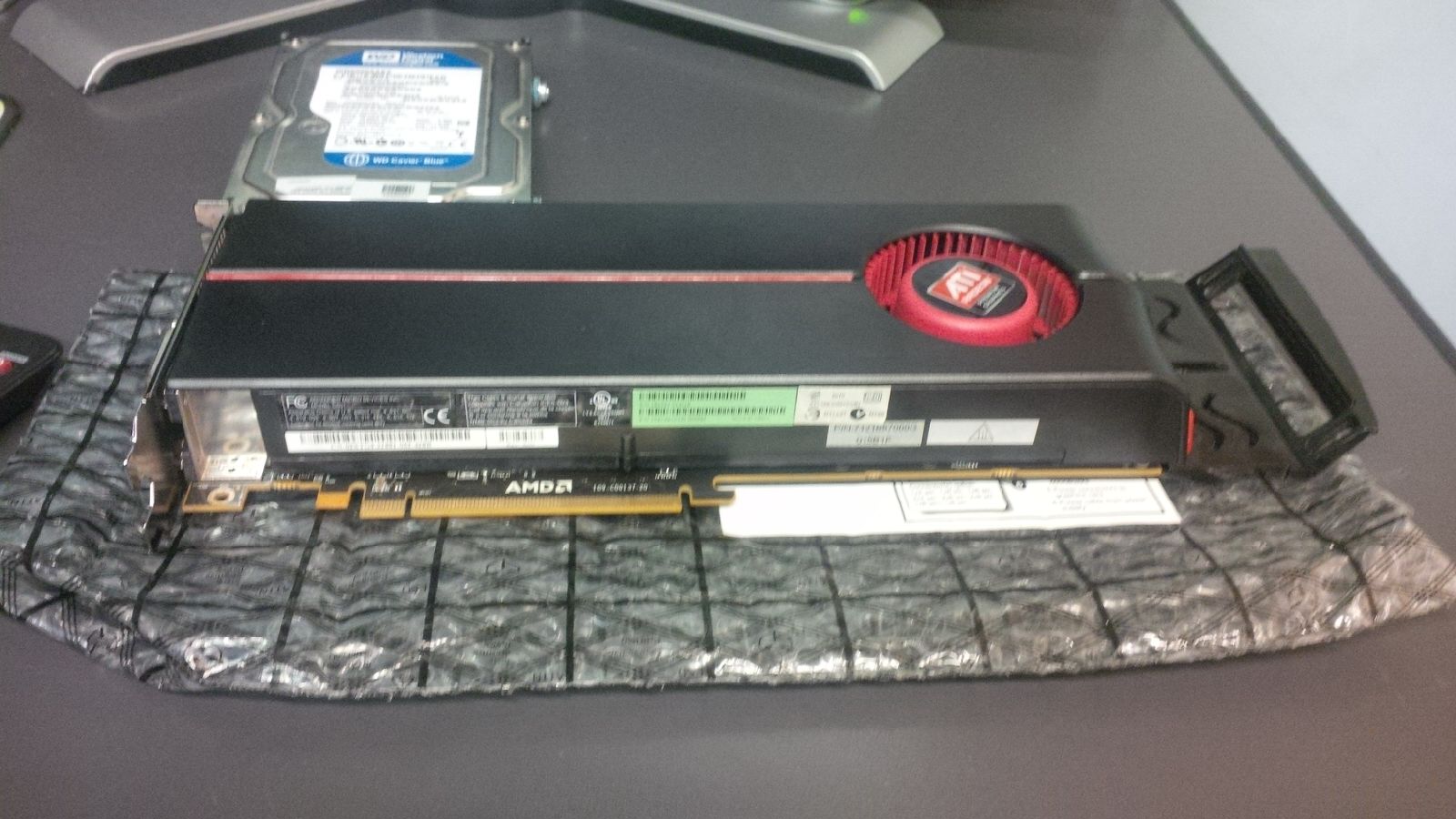

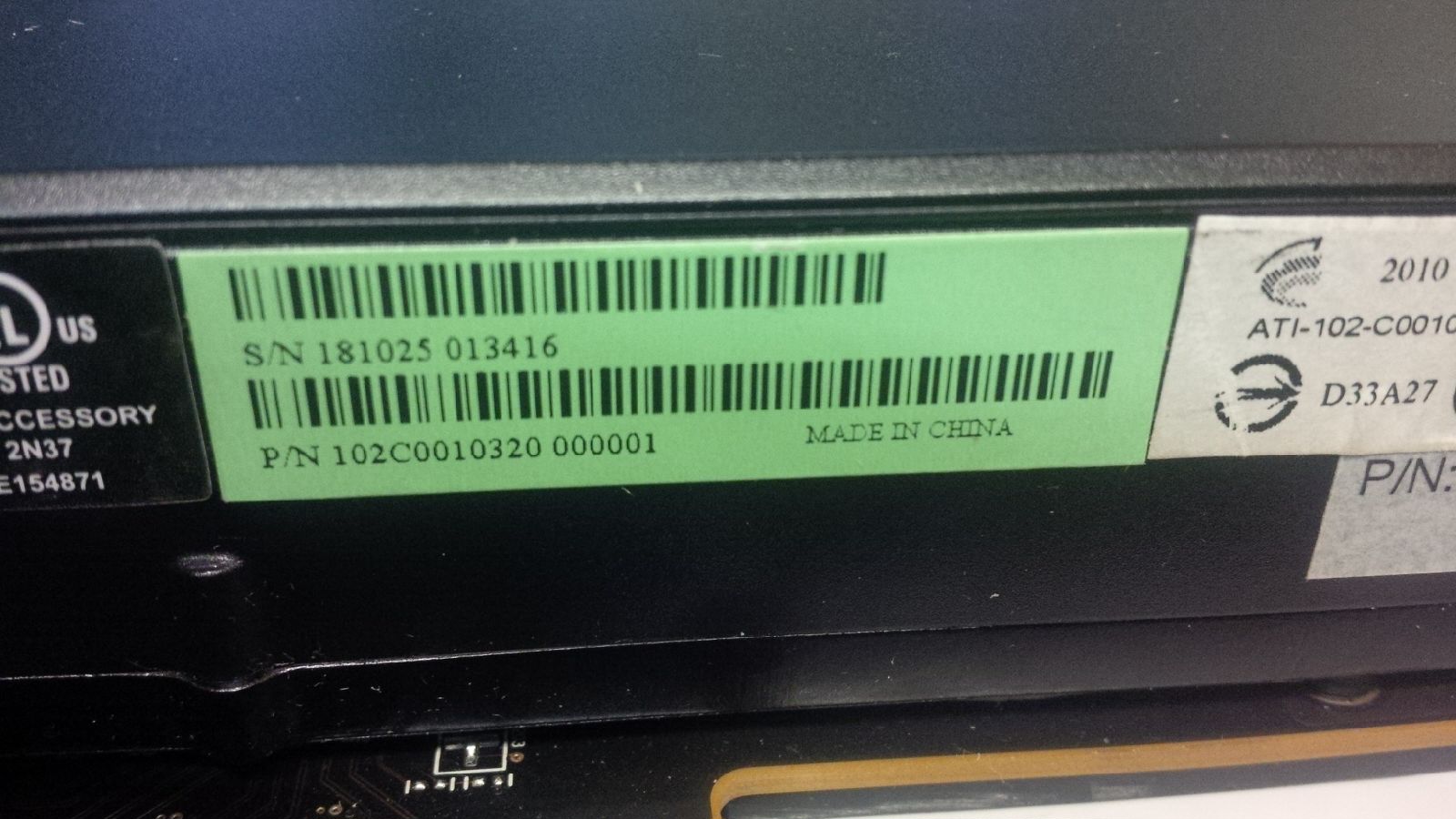

The card seems to be unmounted from a Mac Pro. I believe in the version 3.1. But I wonder is it compatible with my Mac Pro 1.1 ?
Yes a 5870 will work in the MP 1,1.
That price is quite low though, especially if it's a genuine Apple card removed from a Mac Pro. Probably it is a flashed PC 5870. A picture would of the actual item would clear that up.
Hello to all,
I thank all the people that they are giving me support.
Below I have inserted the images related to your graphics card.
From what I've read on the internet seems to be compatible with the Mac Pro in my possession.
What do you think ?
That looks like a genuine Apple card. If so, a great deal at €80! Is it from a private individual, or from a retailer?
Pretty sure it's a flashed card for that price. Which connectors does it have? 2x miniDisplayPort and DVI? Or 2x DVI, DisplayPort and HDMI?

This is definitely not a Mac Edition card - the card support guide looks like it is for a Dell workstation .
