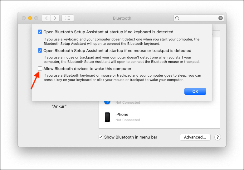

updated to 12.1 and option is still missing.
wtf apple ?

You can try with
Code:
sudo defaults write ~/Library/Preferences/ByHost/com.apple.Bluetooth.*.plist RemoteWakeEnabled -bool NO; sudo killall bluetoothd

Can you tell me what this is supposed to do?
The first part sets RemoteWakeEnabled to NO, corresponding to disabling the “Allow Bluetooth devices to wake this computer” from the Advanced tab.
The second part terminates the bluetoothd process. It will restart by itself.
