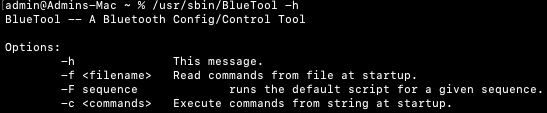

Does anyone know what is the purpose of /usr/sbin/BlueTool?
As far as I could find out, it was previously in iOS and now in Monterey, but not in other versions of macOS.
The help menu is not very helpful.

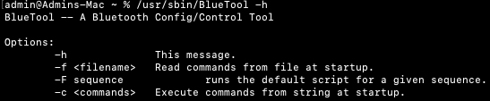

Apple stuff...
some people try to reverse engineer it on iOS:
macOS is in big part propriatey system so quite normal that not everything is shared with public.
Maybe Apple is converging BT software with iOS... as I can see on my macbook "/usr/sbin/BlueTool -R" is running all the time as a deamon.
