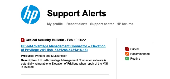

Meanwhile, in other HP printer news (I have an 'ancient' Laserjet P1102w - which somehow I still have working here on Monterey 12.2.1), I got this Critical Support Alert in the mail yesterday, but the link only sends you to a webpage with a Windows PC .exe file, while I was unable to find an equivalent .dmg on the site.
I guess we're to hope the issue doesn't exist on Mac? 🤔🙄
