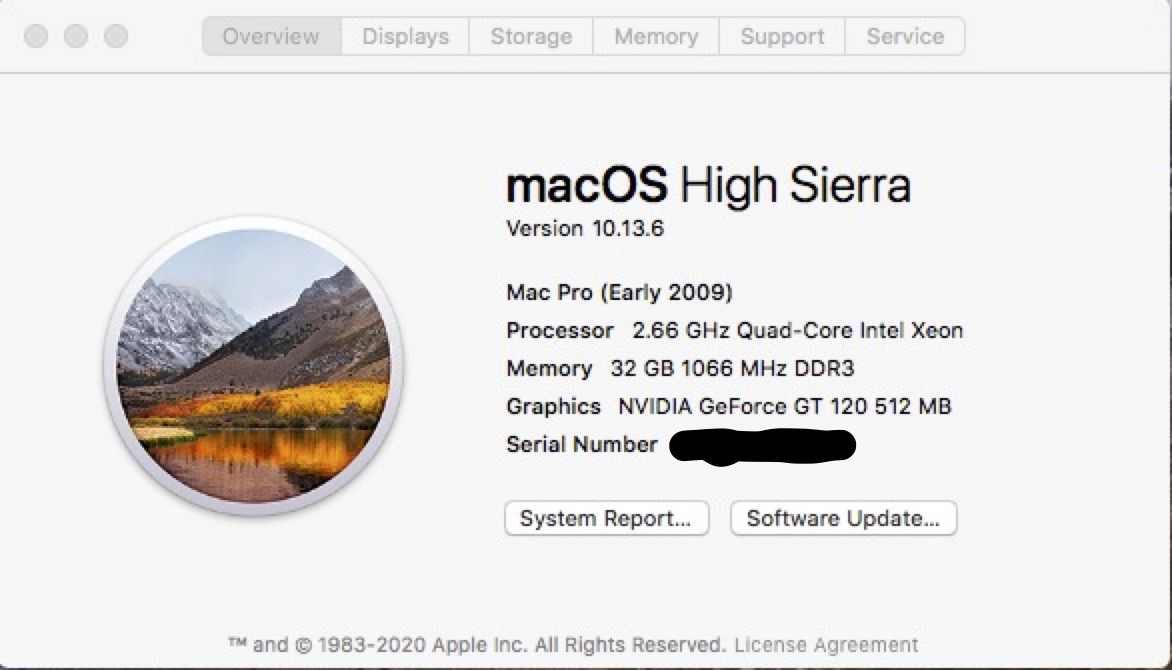

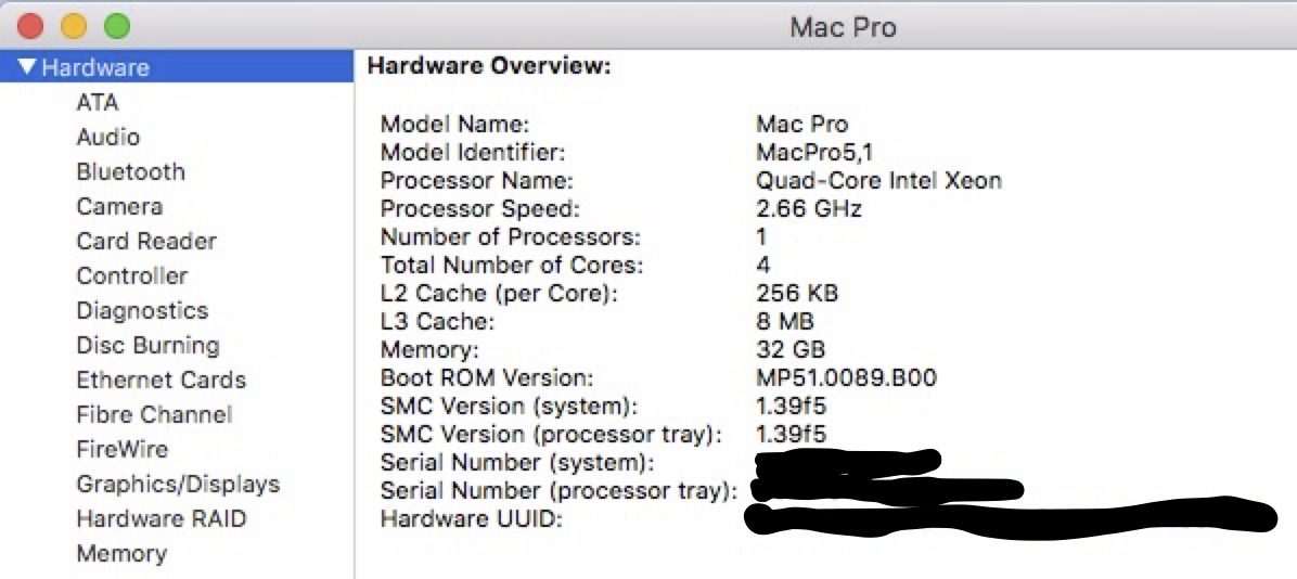

I have MP 4,1 flashed to 5,1 running High Sierra.
Need to upgrade to Metal GPU and yesterday got OWC card:
No matter what I tried I can’t make it work. I have no signal to display at all on any outputs except DVI, but it’s only gray screen indefinitely and MP doesn't boot to login screen. Screen sharing is enabled on MP and in this “gray screen mode” computer is not accessible.
I just did a fresh install on a new SSD from USB installer to mitigate any potential problems. It boots fine with either HD 5770 or GT 120.
Am I doing something wrong or RX 580 is defective?
I would greatly appreciate any advise.
Thanks!

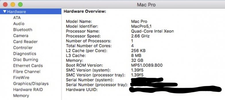

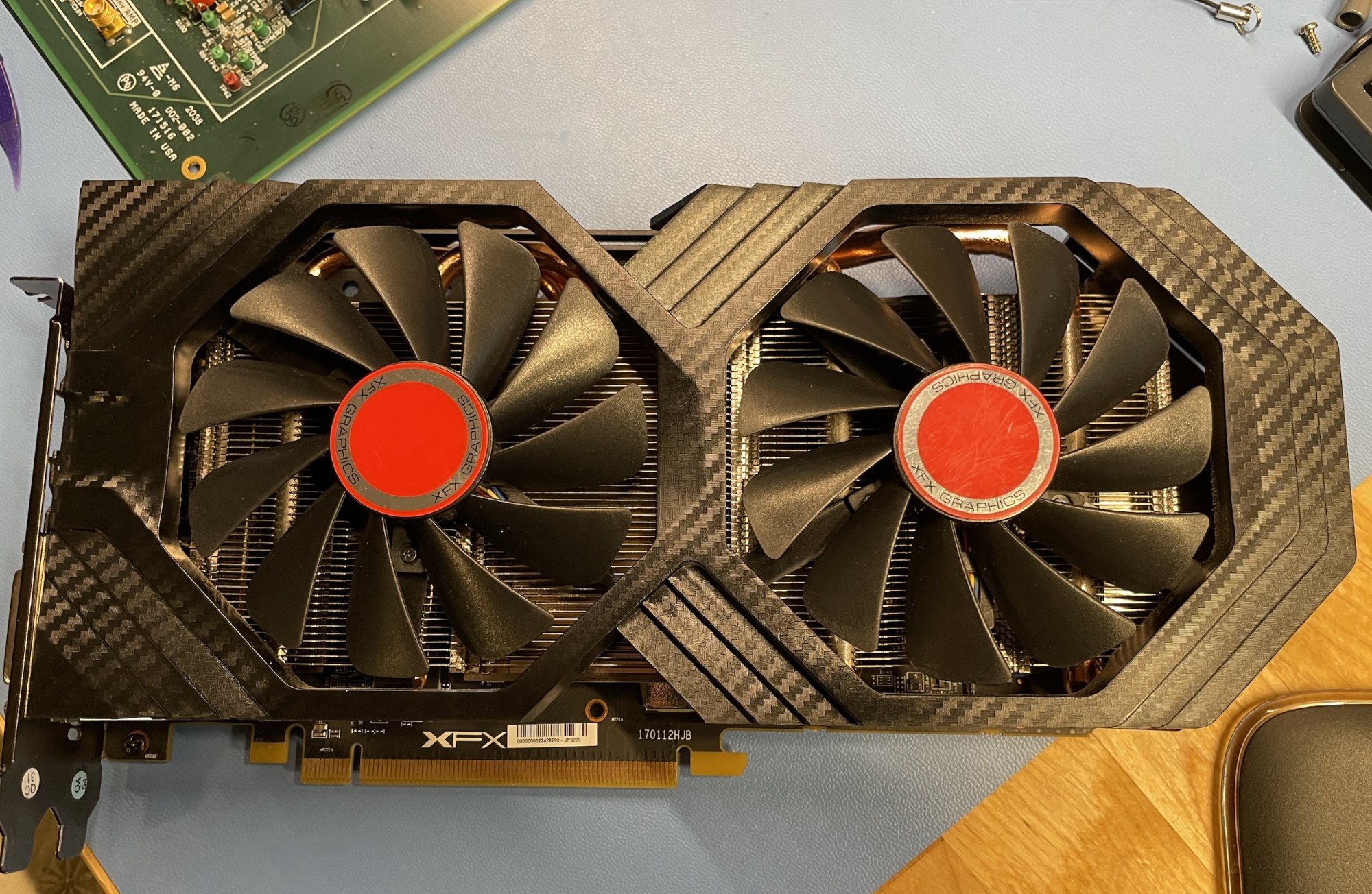

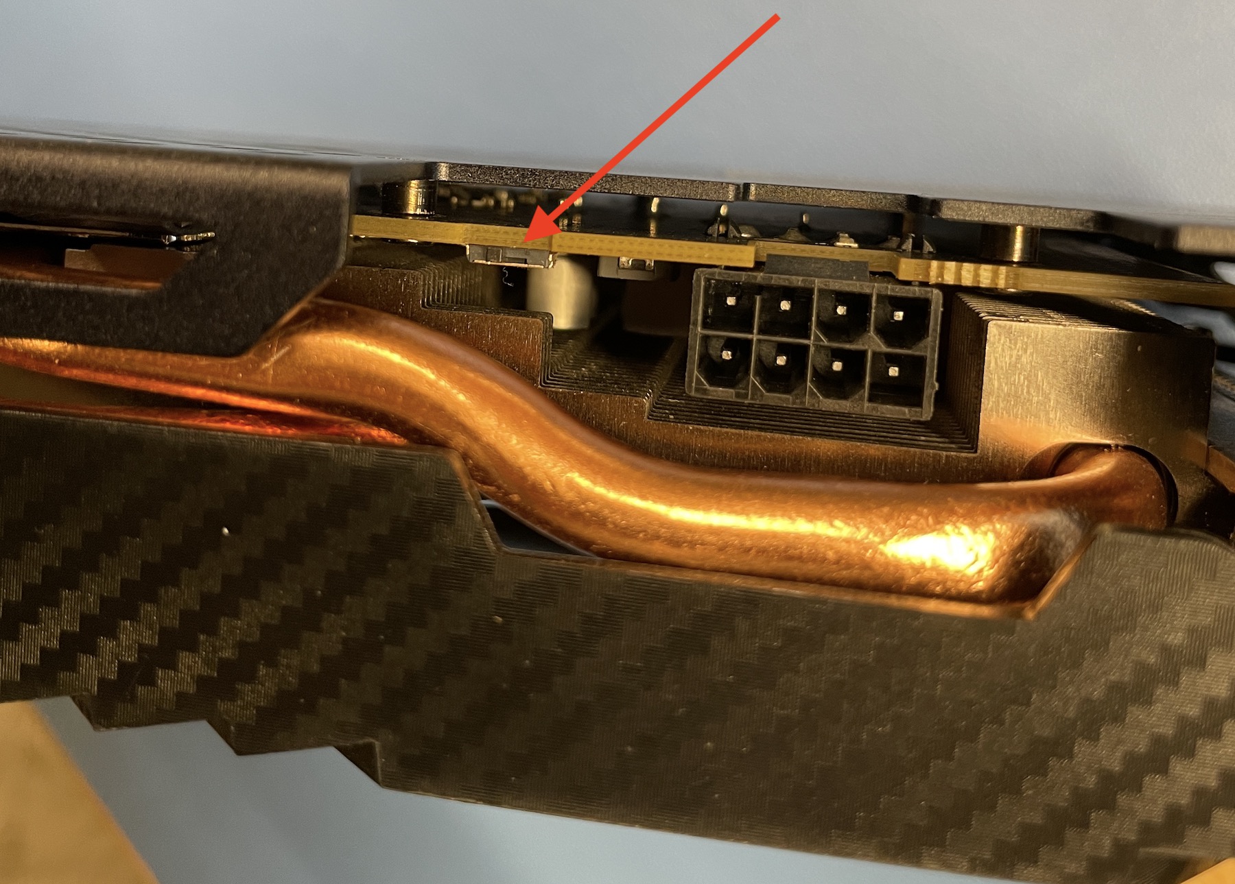

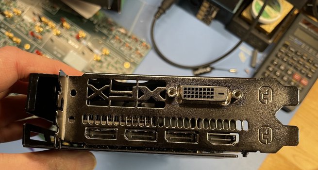

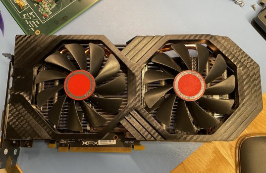

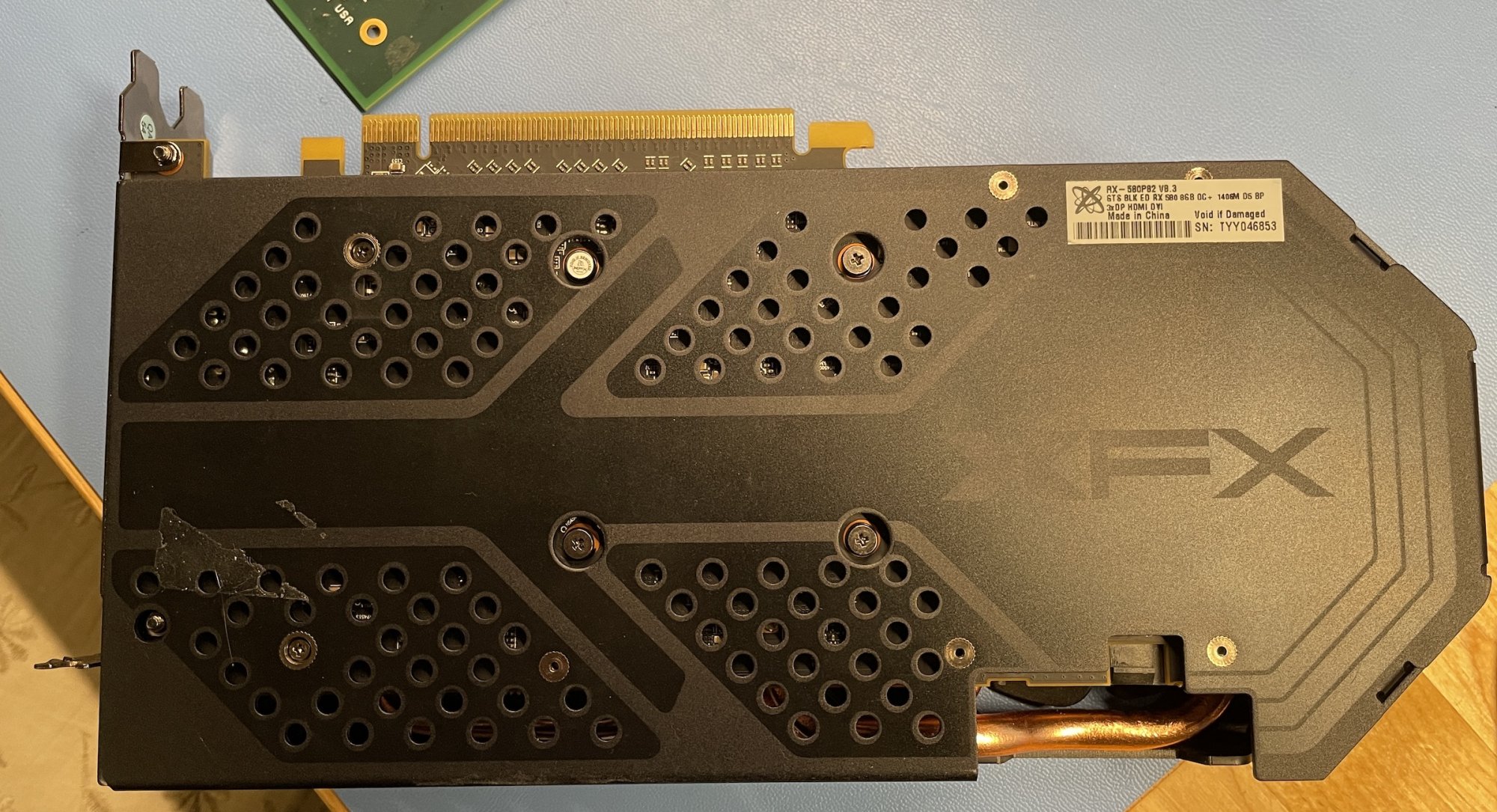

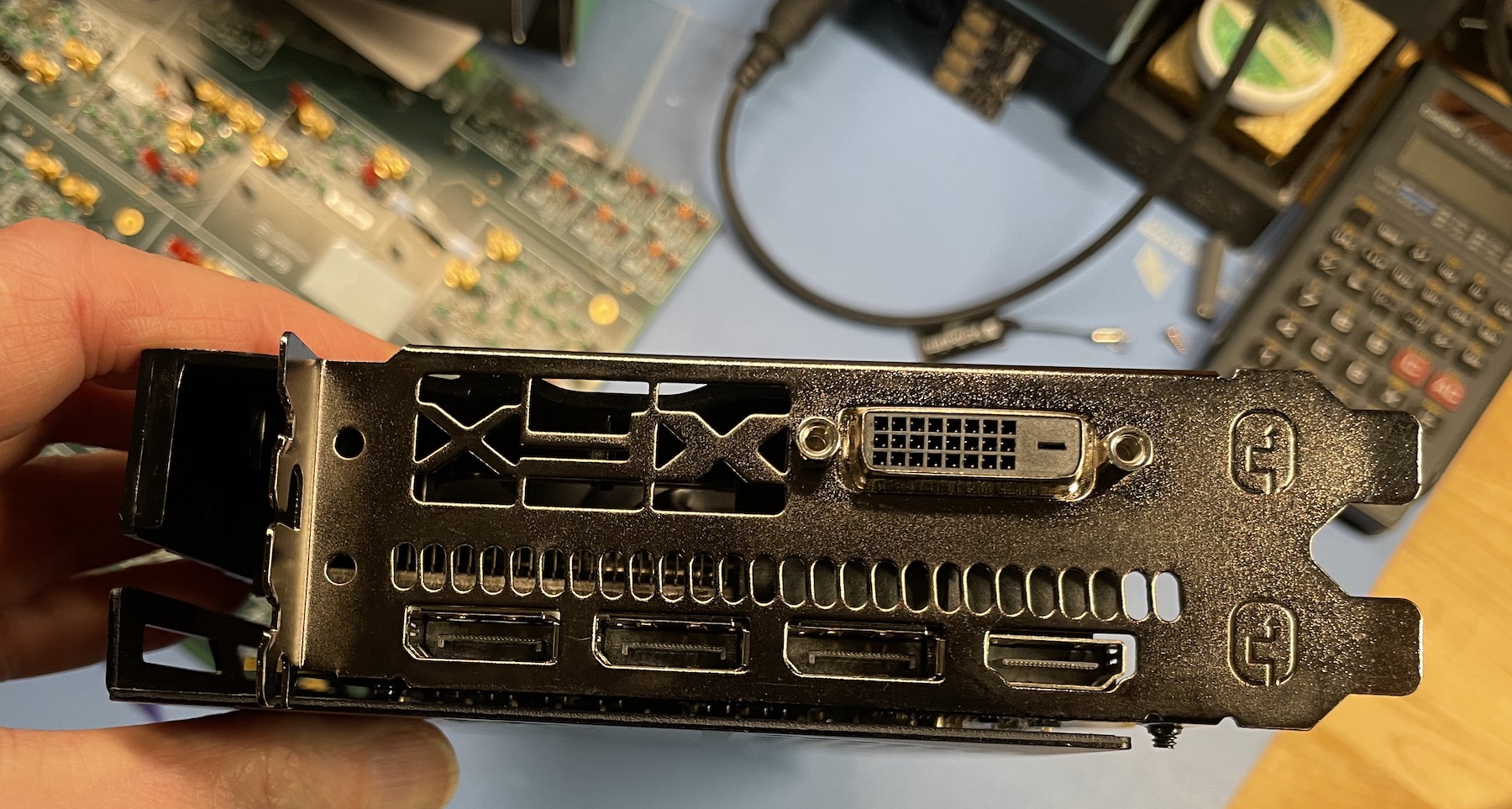

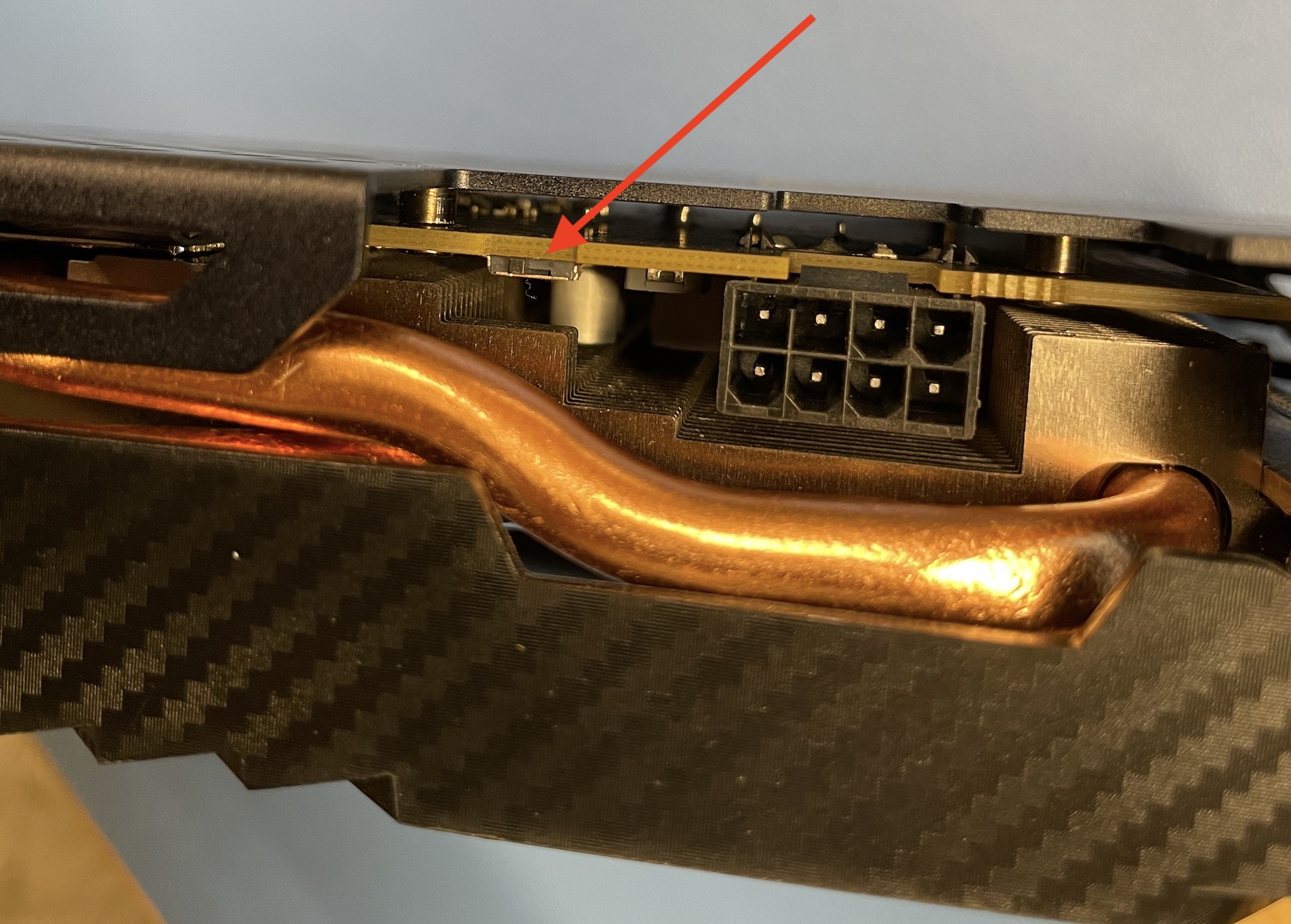

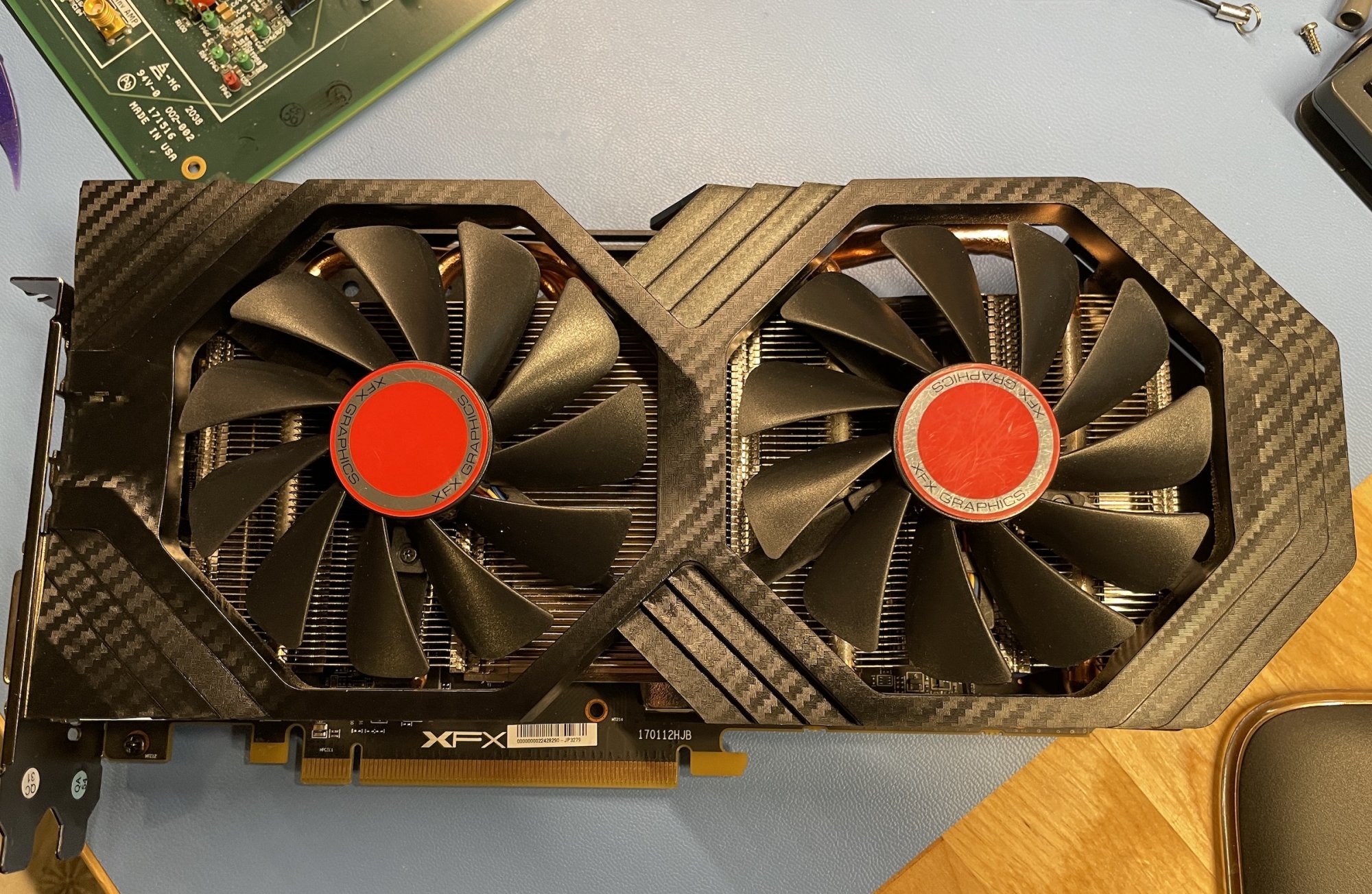

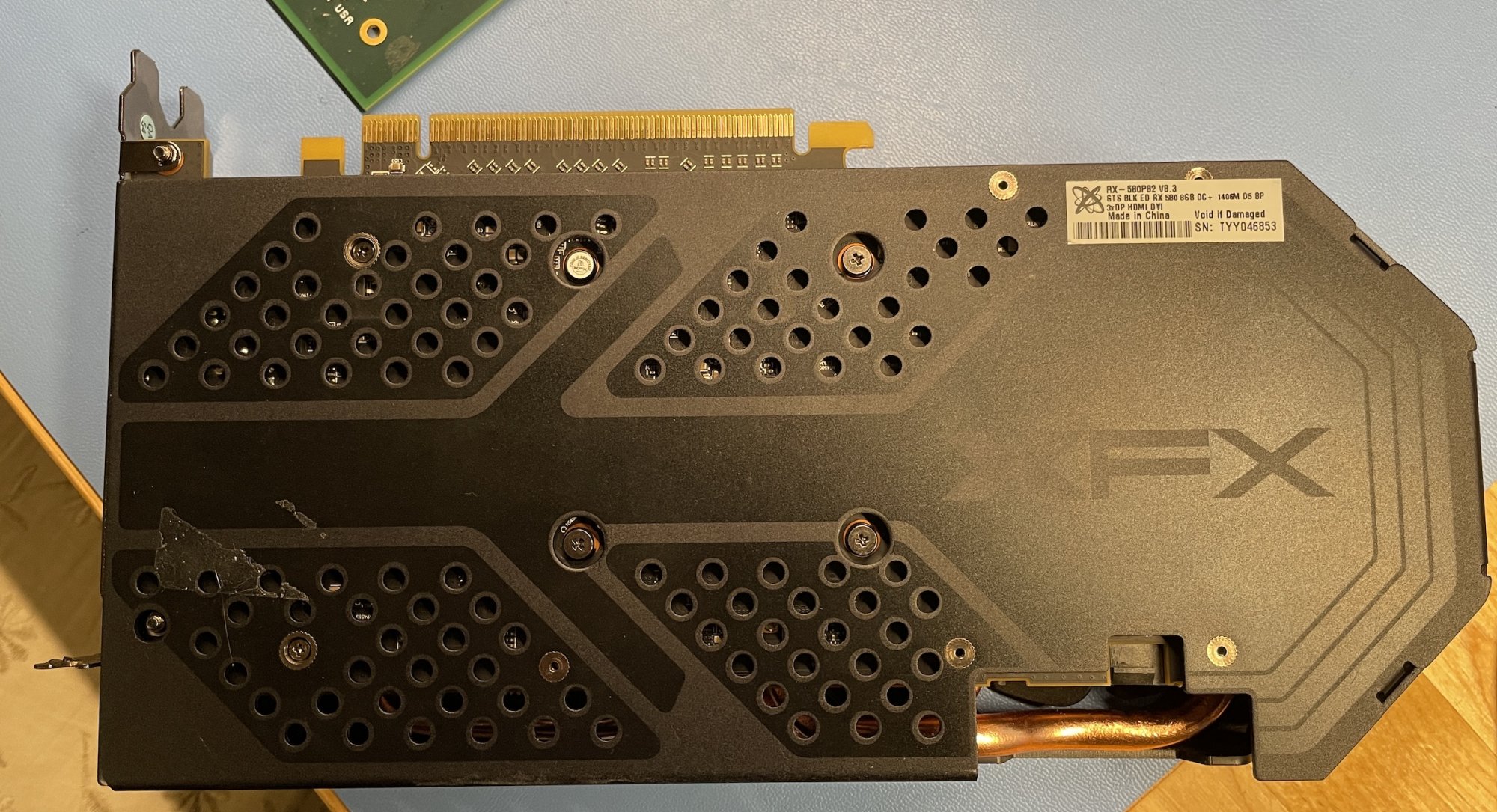

It was "open box item" $268 vs. $370, so there is no box. Looks like it has a small unmarked switch at the PCB edge next to the power connector (see the red arrow on the picture).
Xfx 580's don't generally work on 5.1 mp (Some have got it to work though).
OWC shouldn't be selling this model for Mac's.
Reactions: minifridge1138
Agreed that the XFX cards don’t work well in Mac Pros.
If you’re only going to use Windows, then you can use any graphics card you want (within power limits).
Reactions: MarkC426
Interesting why OWC selling them as a specific card for MP. Perhaps they modified them.
BTW what about this little switch at the PCB edge close to the power connector?
What for it there? Is it any possibility it might be in the wrong position what cause the problem?
