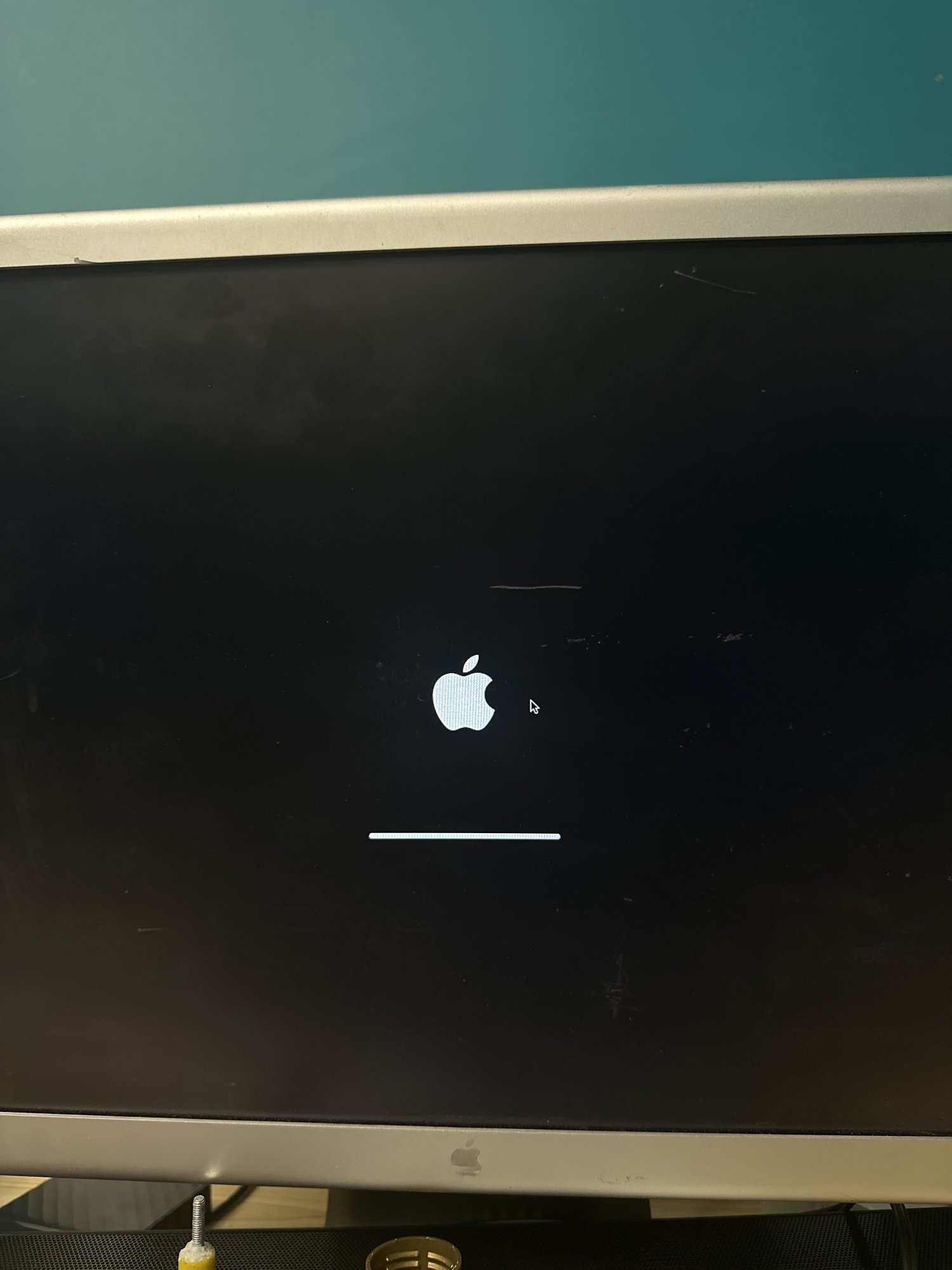

I try again, but nothing, black screen. But if I press "Power", the MP 5.1 turns off.
P.S the monitor feels like it is turned off at all, but its indicator light shows that it is on.
What's up?
So. I tried swapping my new GPU for the old GPU.
Everything worked.
But the computer halfway through the boot process rebooted and started installing mac os monterey again
I did not have time to react, I wanted to take a picture to know what to choose, but MP 5.1 made the choice for me.

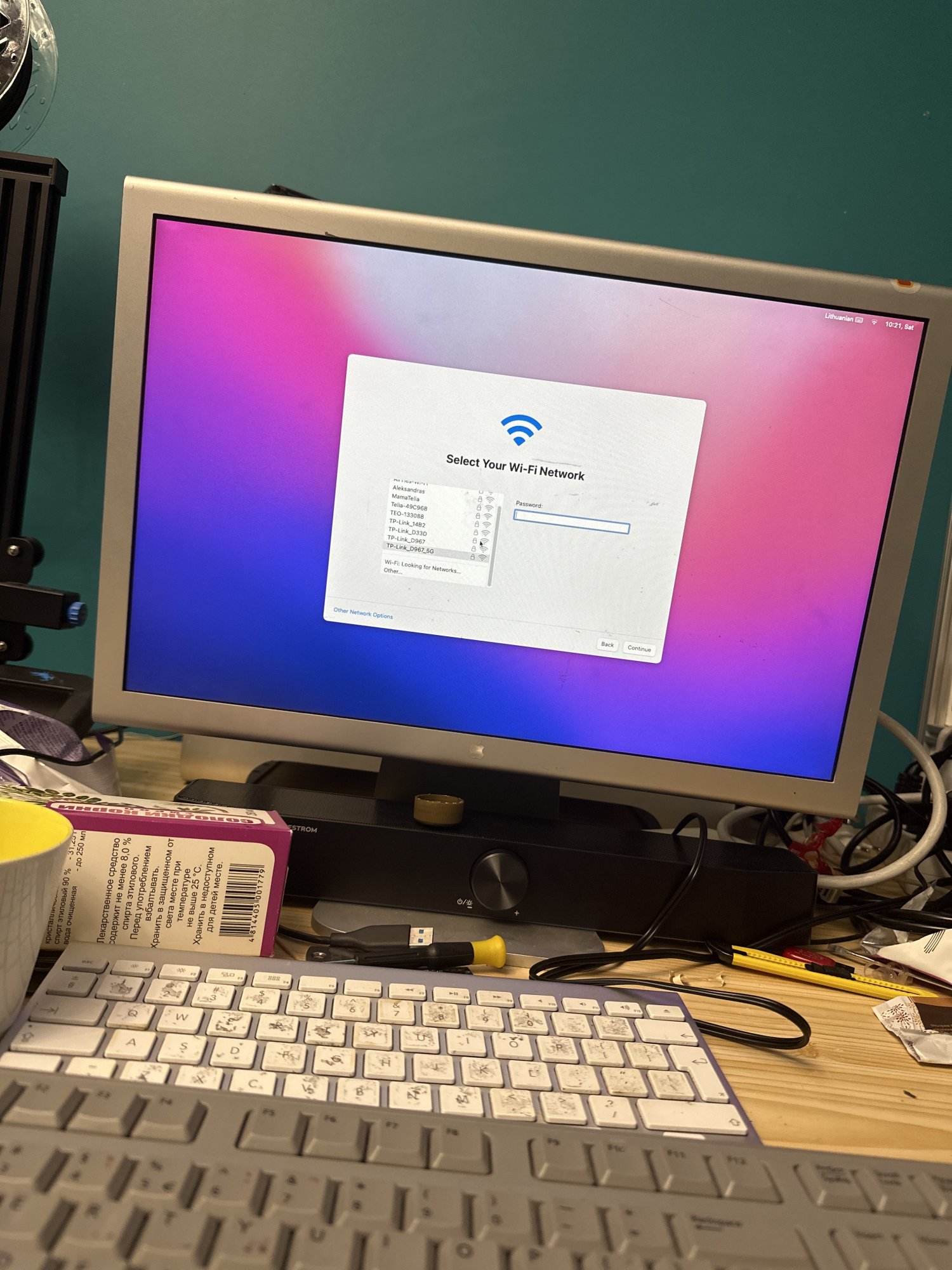

Hmm. Surprisingly the second attempt to install mac os monterey my MP 5.1 is successful with 6 minutes left. Let's see what happens after 6 minutes.
A good 5 minutes he's already so "lagged"
Maybe because I have my old video card and my flash drive inserted?
Remember what I said yesterday—install Monterey with the RX 580. Make sure you're reading the instructions on the OCLP webpage, too.
So what you need to do now is put the RX 580 back in, boot into the USB installer via OCLP, and reinstall. Give it as much time as it needs and don't turn off the power as it's installing.
