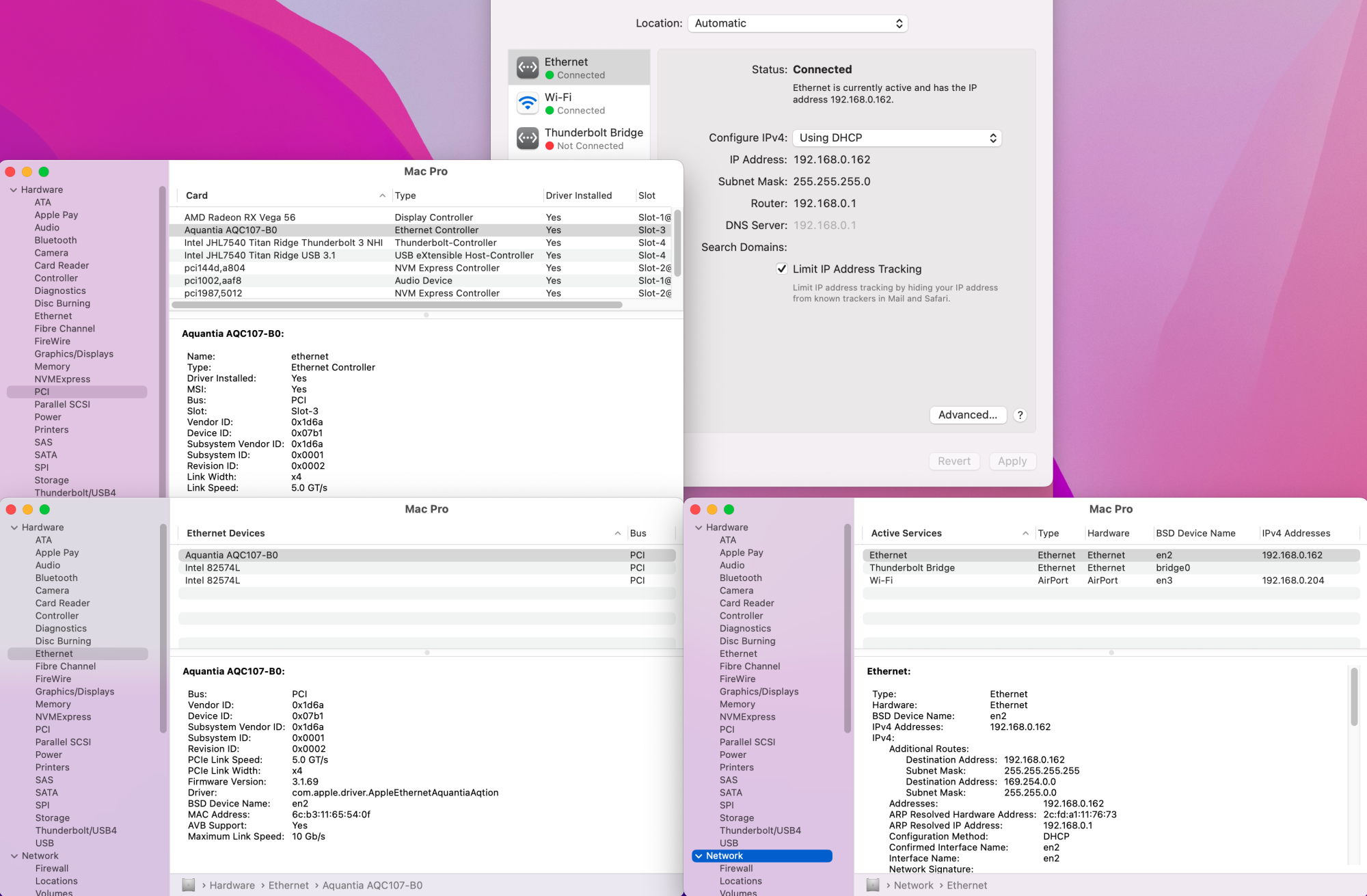

Ok guys. I managed to solve the problems with "self assigned ip" at least on my MP5,1.
I had the same problem on my old hackintosh without VT-d and was fiddling around everywhere on different hackintosh
communities and suddenly found this hack from @CaseySJ for AMD Platforms without VT-d.
I'm running MatinLo:s OpenCore 0.9.7 so if you want to test this just download that package and use attached config.plist. All credit goes to @CaseySJ. This hack will work on Ventura and Sonoma too for those how want to upgrade. I'm running Sonoma and it works great for my Nic Aquantia AQC107-B0.

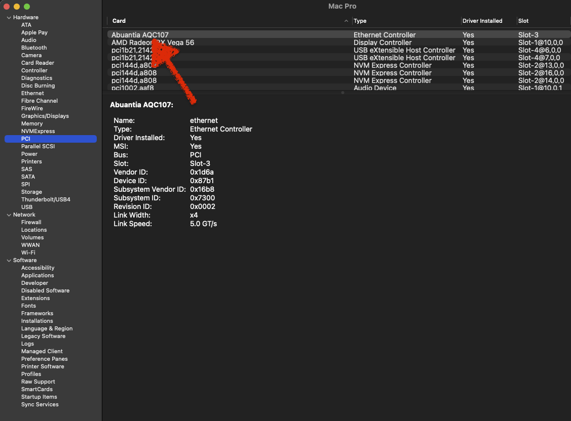

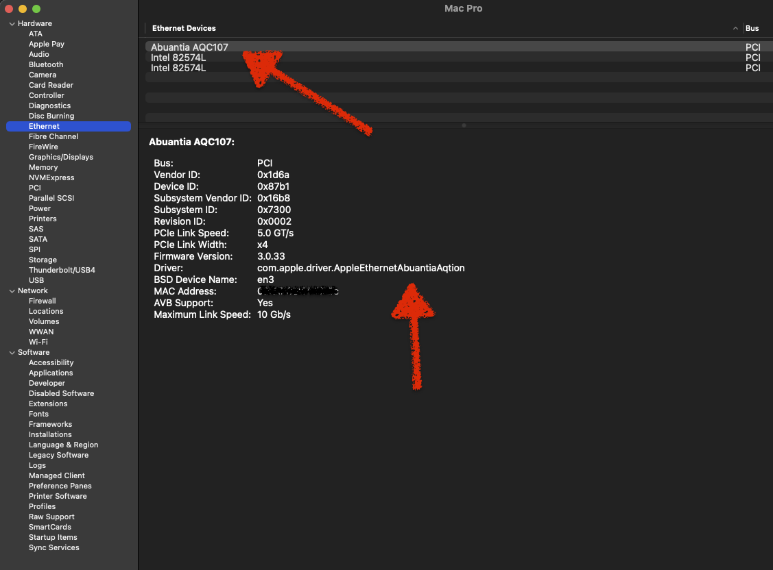

on 12.7.x, and with Martin Lo's 0.9.7 package (with jazzzny's kext), the system information should show the Abuantia driver loaded, not apple's Aquantia.
Bildschirmfoto 2024-02-15 um 10.59.15.pngBildschirmfoto 2024-02-15 um 11.00.38.png
(i need to add that - since i'm using Sonnett's 10G solo PCIe card and not a McFiver – my card sits in PCIe slot 3 whereas (IIRC) the McFiver needs slot 2 for the full x16 BW. but that shouldn't matter either because Lance confirmed that Martin Lo's .9.7 package also works with a McFiver in slot 1 or 2.)
so my suggestion would be to first make sure the Abuantia driver is loaded and not the Aquantia, then delete all network settings and create just one LAN connection (no WLAN or 1G cable installed/connected) with a manual IPv4 address, 10G full duplex and jumbo frames, assign the same manual address to your switch/router, then do a full NVRAM reset to your MP and a restart of your router/switch.

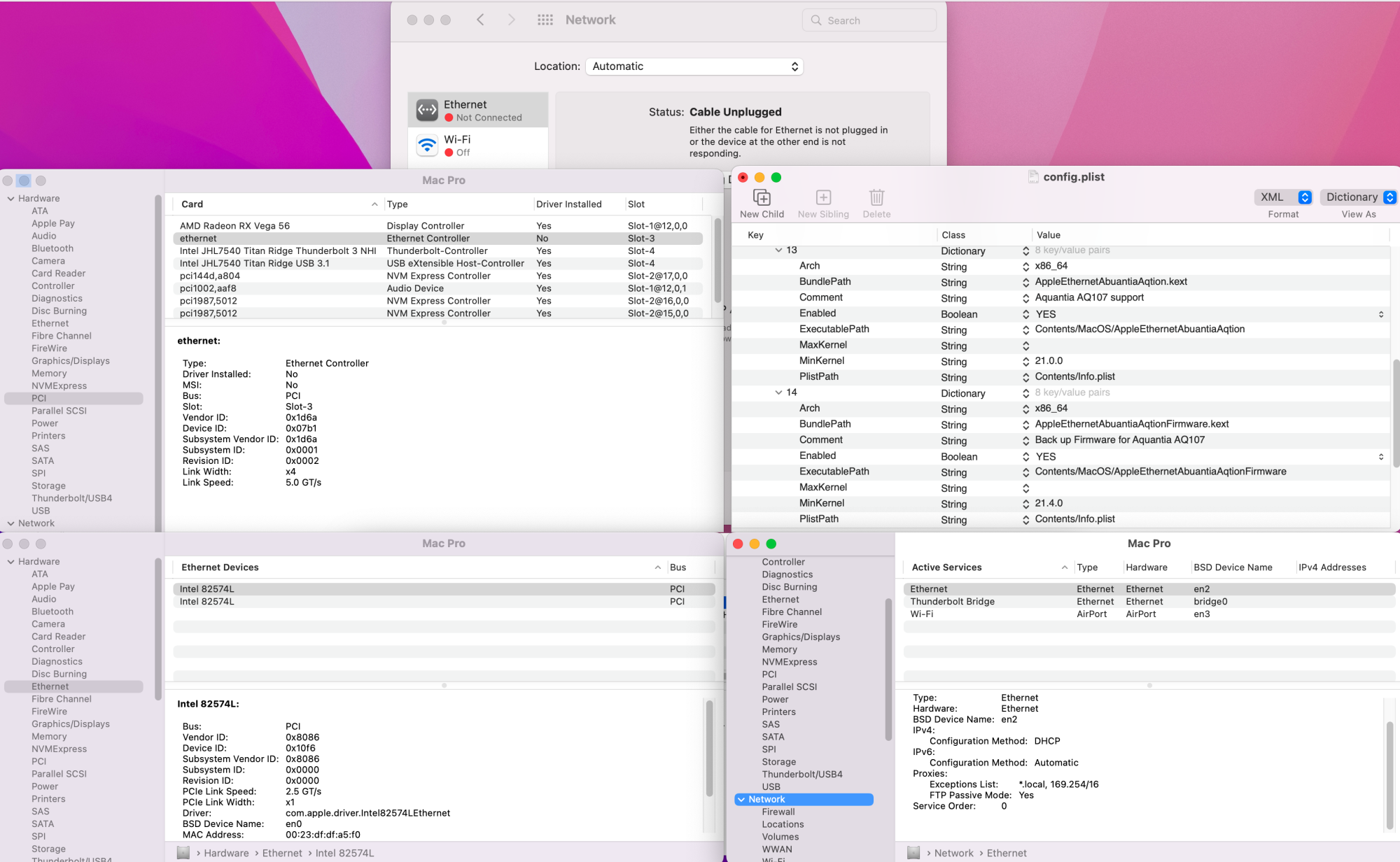

Already tested all what you suggested above. After enabling the two "Abuantia" kext provided in MartinLo:s package, my Nic isn't even recognised as a Aquantia Nic and as a consequence of that no driver is loaded.

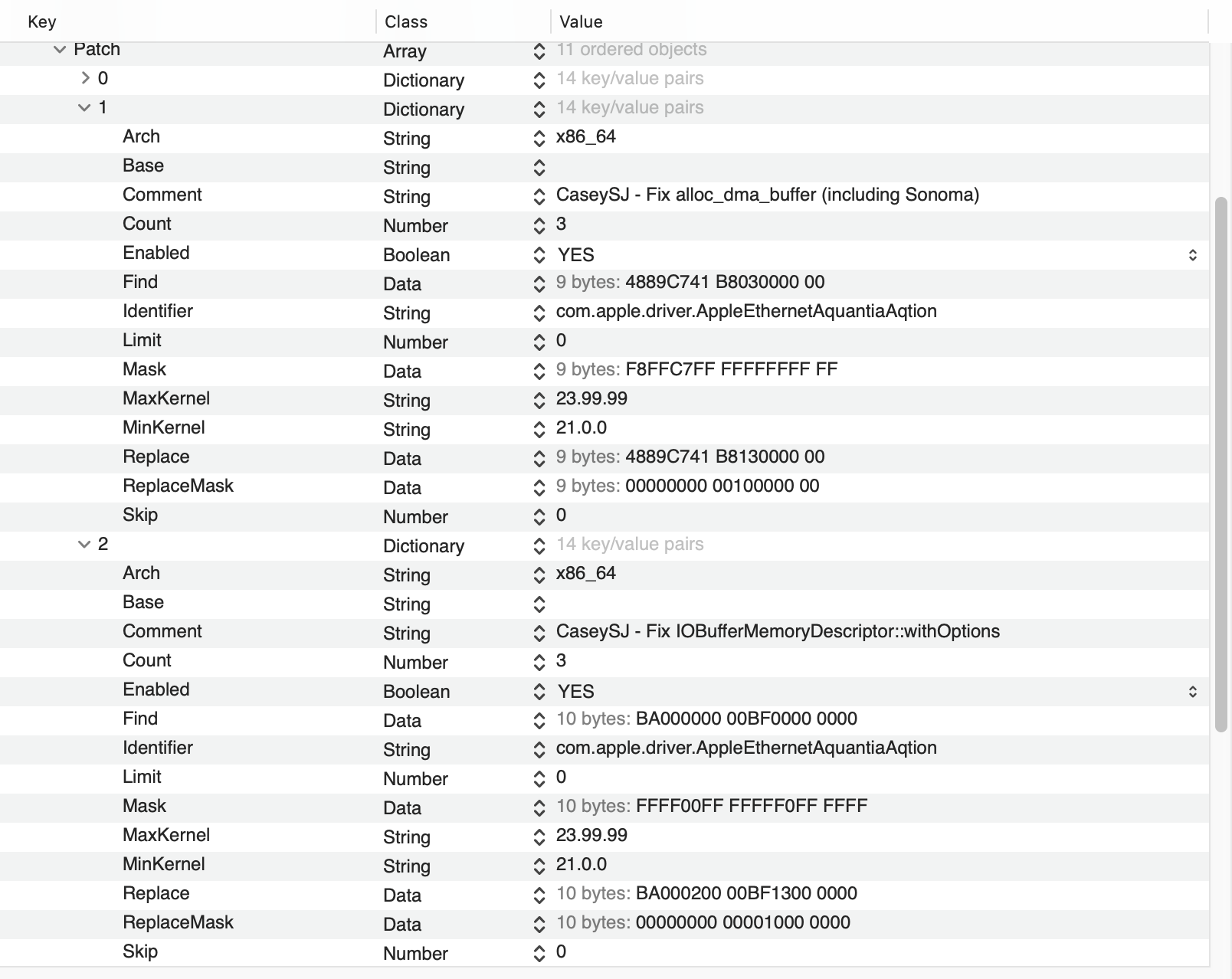

This is what to be inserted and enabled in config.plist instead of enabling the two "Abuantia" kext provided in MartinLo:s package.

Same here, the Jazzzny solution didn't work with my QNAP 10GB card, but CaseyS solution did.
It's a QNAP QXG-10G1T card (Aquantia AQC107-B1) that sits in slot3 of a MacPro 5.1 Westmere 3.33GHz, running Monterey 12.7.5 using Martin Lo's OC 1.0.0

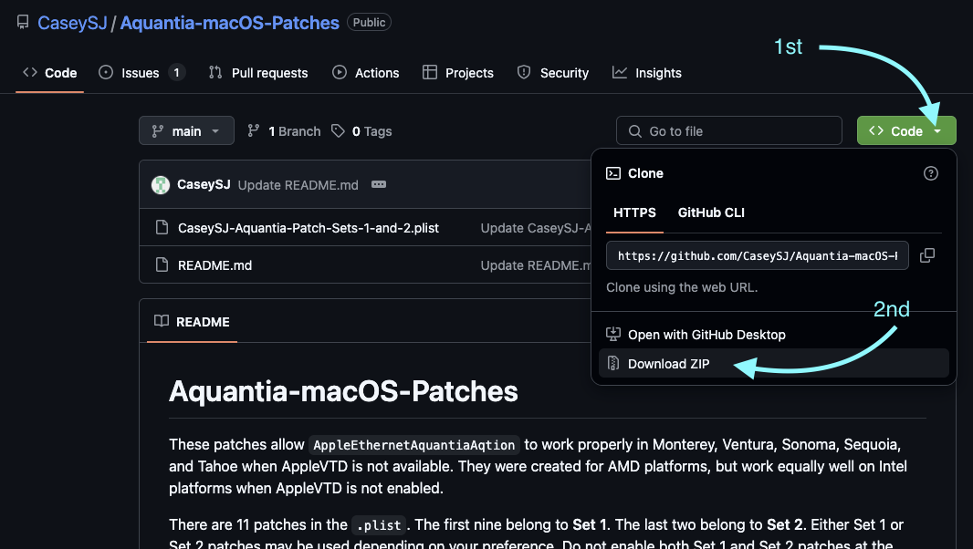

To be complete, here's the link to CaseyS patch

I've got my Mcfiver card working (which has the AQC-113 chipset) by using CaseySJ's patches. I manually edited my config.plist file, added the patches, set the Set 1 patches keys to true, and set the ForceAquantiaEthernet Quirk key to true. I'm running OCLP 2.1.2 and Sonoma 14.7.1. Before I added patches I was getting the self-assigned IP address error, but now all works as expected. Thank you to CaseySJ and everyone on this thread for your suggestions and efforts to solve this problem. Long live Mac Pro 5.1!

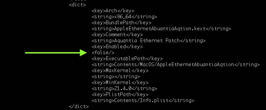

THE PATCH: CaseySJ's Aquantia-macOS-Patches
  1. With the McFiver in the system build and install OCLP to disk using OCLP 2.4.0 (the latest at the time of writing)
  2. BEFORE rebooting EDIT the config.plist
    (I’m old school so I edit my config.plist “by hand” using VIM via the terminal)
    1. Locate the Abuantia entry (Kernel > Add > AppleEthernetAbuantiaAqtion.kext) and disable it by changing the Enable key to false. (And yes, that’s a letter ‘b’ instead of the letter ‘q’ so search for ‘Abuantia’.) Setting this to false will disable it. (Some choose to delete this whole section but I chose to leave it in there and just disable it instead.)

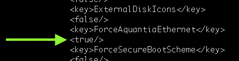

    2. Force enable the Aquantia driver
      1. Find the “ForceAquantiaEthernet” key in the Kernel > Quirks section of the config.plist and change it to true.

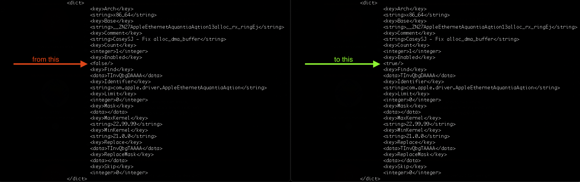

    3. Patch the config.plist with CaseySJ’s patch-set-1(patch-set-2 did NOT work for me).
      1. Download the patch from here (I downloaded the .zip file and then extracted it)

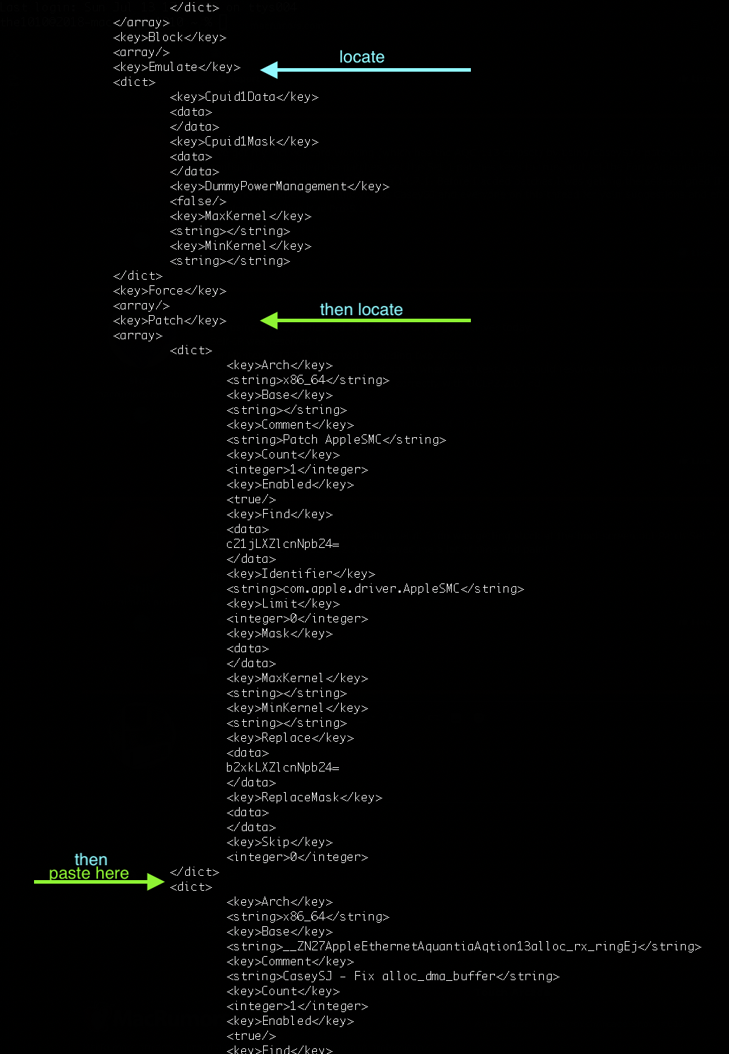

      2. Open the file CaseySJ-Aquantia-Patch-Sets-1-and-2.plist
      3. Copy all 11 <dict> entries (i.e. copy everything except the top 8 lines and the bottom 9 lines)
      4. Mount your macOS drive’s EFI partition (again I’m old school so I use the diskutilcommand in the terminal app)
        1. sudo diskutil mount <macOS_efi_partition>
          For example:
sudo diskutil mount disk0s1
      5. Edit the config.plist in your mounted EFI partition
Should be at a location similar to /Volumes/EFI/EFI/OC/config.plist
      6. Locate the <key>Emulate</key> section (Emulate only occurs once in the file (Kernel > Emulate) so this was the easiest way for me to quickly get near the correct location)
      7. Scroll down past the Emulate section until you get to the <key>Patch</key> section that is just after the Emulate and Force sections. This should be the Kernel > Patch section.

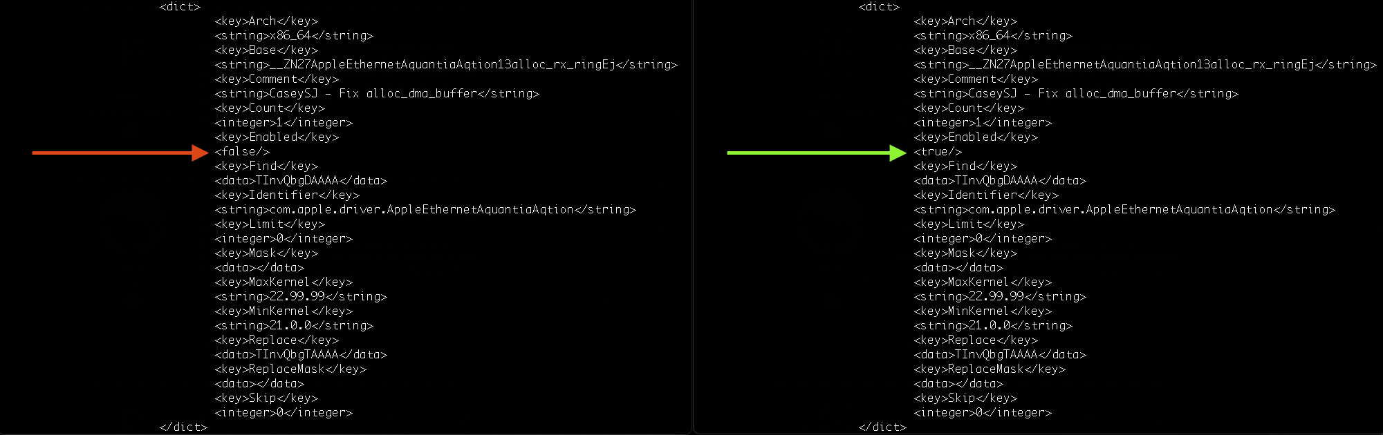

      8. Paste all 11 of CaseySJ's patches into the Kernel > Patch section. ( I chose to paste them all right after the first kernel patch, which for me is the AppleSMC patch.

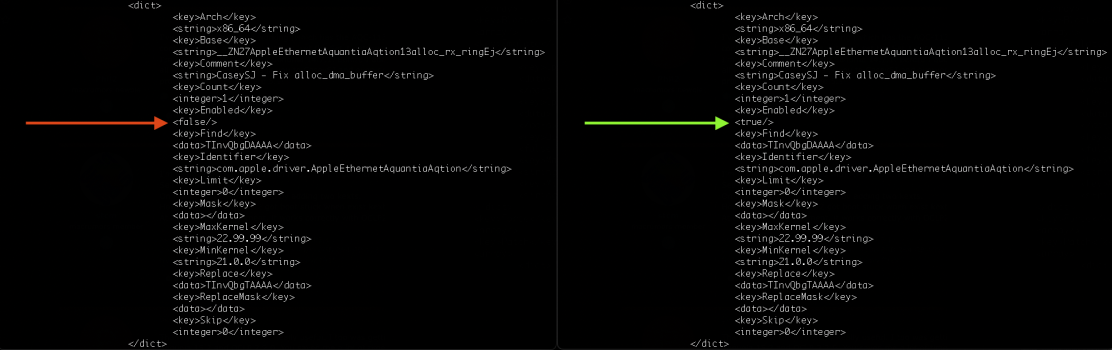

      9. To apply CaceySJ’s patch-set-1, enable ONLY the first 9 patches you just pasted by changing each of their <key>Enabled</key> attributes to <true/> like this...
