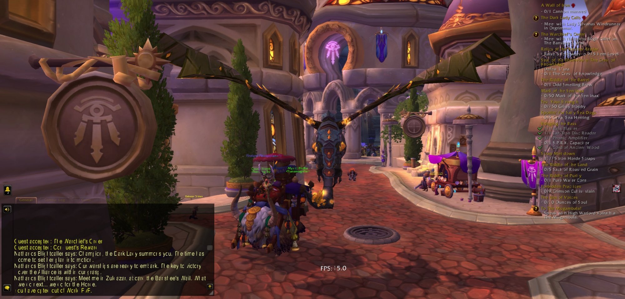

I haven't done much testing yet, but I did try it in Catalina on my MacPro3,1. Without it, World of Warcraft.app crashes at launch. With it, it loads and plays. I'm using a GTX 680. There is some strange issue with text drawing though.
The text drawing problem in WoW is now fixed with 0.92 of MouSSE (I guess that means earlier versions were not emulating instructions 100% correctly). WoW is playable in 10.12 Sierra, 10.13 High Sierra, and 10.14 Mojave.

MouSSE hasn't worked with 10.11 El Capitan since version 0.35. WoW has extreme graphics glitches in that version of macOS so I don't think an updated MouSSE would help (WoW mentions that graphics drivers in 10.12 Sierra are old but it is still very playable). Anyone know a reason to have MouSSE work in El Capitan except that El Capitan was the last supported version of macOS that supports MacPro3,1?

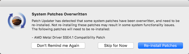

BTW, Getting this from the DosDude Patcher after the update:
Been selecting "Skip for Now" as not sure whether the "Don't Remind" option is specific to the particular patch or whether it will stop notifications on all patches.
Both dosdude1 and 0403979 acknowledged the new version of MouSSE, but I have no idea if it's been incorporated into either of their patchers yet, or if dosdude1's patch updater server knows about it. It'll show up sooner or later.
I clicked "Don't Remind Me Again". That option appears to stop all checks though (changes ~/Library/Preferences/com.dosdude1.Patch-Updater.plist ). Not just the one for the SSE4.1 patch (installed patches listed at /Library/Application Support/macOS Catalina Patcher/installedPatches.plist )
There doesn't seem to be an option to undo the option. I guess you can edit the file and change checkPatchIntegrity back to true?
There doesn't seem to be an option to uninstall a patch. To do that you need to understand how a patch is installed by looking at the code or scripts. There is usually two versions of a patch - one for the post installer (in code) and one for the Patch Updater (scripts). For the post installer, look at source code in github. For the patch updater, updates are downloaded from dosdude's website. see #17,966.
For what it’s worth I use OpenCore to inject this kext and have not encountered any issues with that.
The first time you booted with this, DosDude Patch Updater would have flagged the absence of the default version (I tried this a while ago and went back to just installing) and you probably clicked "Don't Remind Me Again".
From @joevt findings, this may have switched all such notifications off ... even for other components.
