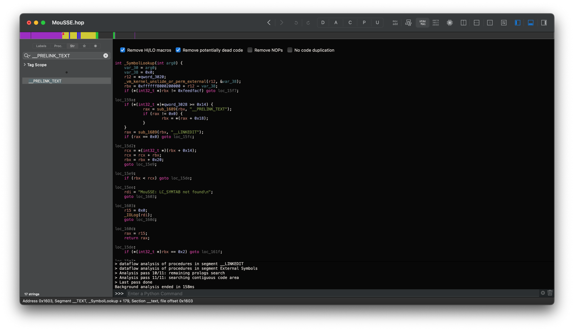

@Syncretic Hey just a heads up, macOS 13.0 Beta 3 (22A5295h) breaks MouSSE's SymbolLookup(). Specifically the __PRELINK_TEXT marker is no longer available, instead you'll need to switch to __TEXT_EXEC.
A simple bin patch to the current MouSSE is fine enough:
Code:
Find:    5F 5F 50 52 45 4C 49 4E 4B 5F 54 45 58 54
Replace: 5F 5F 54 45 58 54 5F 45 58 45 43 00 00 00
Patch confirmed working on a MacBook7,1 with 13.0 Beta 3.
Should be relatively easy to swap the string in your source and recompile.
