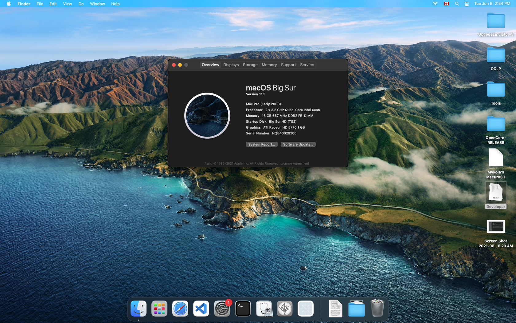

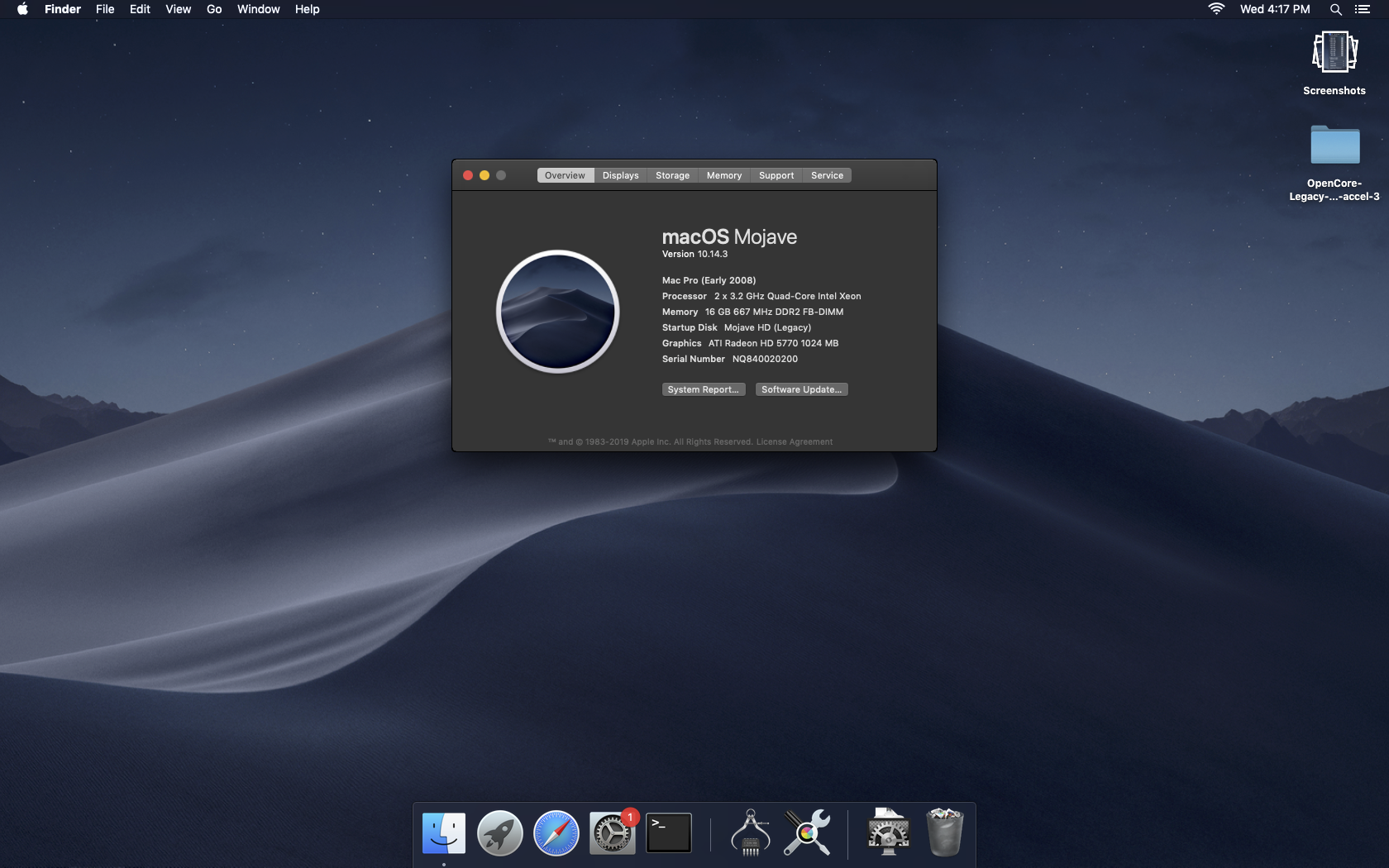

@Syncretic Hello! So with OpenCore Legacy Patcher, ASientientBot, Hedgehog and I have been trying to get acceleration working with TeraScale 2 series. We've had great success for iMac12,1 as well as a Skylake hackintosh but troubles with MacPro3,1. On Mojave, MouSSE works great but we found with macOS Big Sur that we hit an illegal instruction. Specifically com.apple.AMDRadeonX3000GLDriver's glrATIR800InitMiscTextureInfo calls an SSE4,2 instruction (PCMPGTQ)

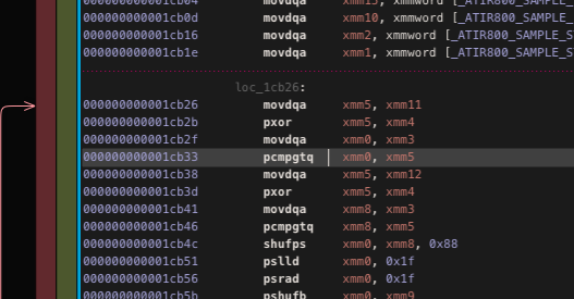

Mojave running on HD 5770 with accelerationBig Sur crashing, calling PCMPGTQ
Your driver works great for my RX 570 and the stock drivers, however my HD 5770 hits an illegal instruction only in Big Sur. Likely due to how early AMDRadeonX3000GLDriver and the illegal instruction are called.
Do you have any tips on working around this or perhaps a way to ensure MouSSE is loaded and ready to handle instruction calls? For reference, you can find the binary here: High Sierra's AMDRadeonX3000GLDriver

I am crazy busy with work right now, and I'm rarely on here, so please excuse any slow responses. The PCMPGTQ instruction is definitely emulated in MouSSE, so it's just a matter of ensuring that MouSSE is initialized before the PCMPGTQ is encountered. Are either of the kexts (AMDRadeonX3000GLDriver or MouSSE) being injected by OCLP, vs. being linked directly into the kernel? I've never looked into how OC handles injection, but I suspect it would affect the order in which things get initialized.
If either kext is being injected by OC, try linking it directly into the kernel and see if that makes a difference. If it doesn't, I'll have to dig into it when I can find some time.
Upon re-reading, I realized I overlooked your crash log (thank you for including one). The list of binary images therein does not include MouSSE. If the crash didn't occur until WindowServer was running (or trying to run), then MouSSE should almost certainly have been initialized by that point. Are you certain that MouSSE is being loaded?

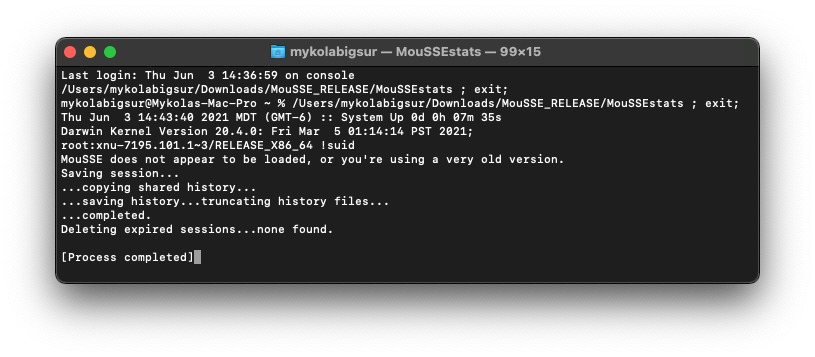

Extra comment, running MouSSE with my RX570 in a clean Big Sur install and running the MouSSEstats results in:
Very odd, as I can see the kext in kextstat

Mini update: my RX570 in Big Sur works fine without MouSSE. So been a placebo this whole time that I've thought it was working. Seems the rabbit hole is much deeper than expected
